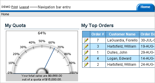

A breadcrumb trail indicates where the user is within the application from a hierarchical perspective. In addition, users can click a specific breadcrumb link to instantly view the page. You use breadcrumbs as a second level of navigation at the top of each page, complementing other user interface elements such as tabs and lists.
Description of menu.gif follows

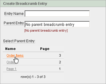

    During the wizard, a Breadcrumb list appears. The actual page on which this list displays depends upon the type of page you are creating.
  2. From the Breadcrumb list, select any option other than the following:
    - do not use breadcrumbs on page -
    The Create Breadcrumb Entry form appears.
    Description of breadcrum_creage_pg.gif follows
  3. In Entry Name, enter a name for the breadcrumb.
  4. For Parent Entry:
    • To specify a parent, select a parent page from the Select Parent Entry list.
    • If this breadcrumb does not have a parent, select No parent breadcrumb entry.
  5. Follow the on-screen instructions.

About Navigation Bars
A navigation bar entry can be an image, text, or an image with text beneath it. You must supply the images and text to use in the navigation bar entries.
Description of nav_bar_2.gif follows
Navigation bars are different from other shared components in that you do not need to reference them on a page-by-page basis. If your page template includes the #NAVIGATION_BAR# substitution string, the Application Express engine automatically includes any defined navigation bars when it renders the page.
