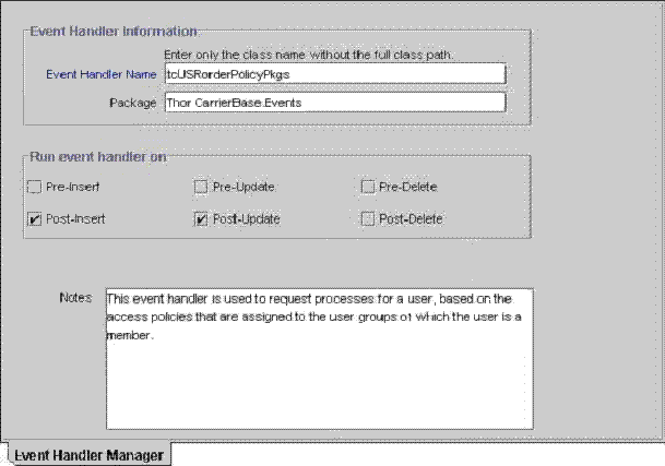

This form appears in the Development Tools/Business Rule Definition folder. You use this form to manage the Java classes that process user-defined or system-generated actions (or events). These classes are known as event handlers. When you add a new event handler to Oracle Identity Manager, you must first register it here so that Oracle Identity Manager can recognize it.
There are two types of event handlers:
Event handlers that are created through the Adapter Factory form. These begin with the letters "adp." They are known as adapters.Event handlers that are created internally in Oracle Identity Manager. These begin with the letters "tc." They are referred to as system event handlers.
Through the Event Handler Manager form, you can specify when you want Oracle Identity Manager to trigger an event handler. An event handler can be scheduled to run as follows:
Pre-Insert: Before information is added to the database
Pre-Update: Before information is modified in the database
Pre-Delete: Before information is removed from the database
Post-Insert: After information is added to the database
Post-Update: After information is modified in the database
Post-Delete: After information is removed from the database
Figure 10-1 displays the Event Handler Manager form.
Table 10-1 describes the data fields of Event Handler Manager form.
Table 10-1 Data Field
| Field Name | Descriptions |
Event Handler Name |
The name of the event handler. |
Package |
The Java package to which the event handler belongs. |
Pre-Insert |
By selecting this check box, Oracle Identity Manager can trigger the event handler before information is added to the database. |
Pre-Update |
If you select this check box, Oracle Identity Manager can trigger the event handler before information is modified in the database. |
Pre-Delete |
By selecting this check box, Oracle Identity Manager can trigger the event handler before information is removed from the database. |
Post-Insert |
If you select this check box, Oracle Identity Manager can trigger the event handler once information is added to the database. |
Post-Update |
By selecting this check box, Oracle Identity Manager can trigger the event handler after information is modified in the database. |
Post-Delete |
If you select this check box, Oracle Identity Manager can trigger the event handler once information is removed from the database. |
Notes |
Additional information about the event handler. |
The following sections describe how to create and modify event handlers.
To use an event handler, you must attach it to a data object using the Data Object Manager form. For more information on assigning event handlers to data objects, refer to "The Data Object Manager Form".Caution:
Any event handler that begins with the letters "adp" is associated with adapters, and should not be modified. However, you can modify system event handlers. These event handlers that begin with the letters "tc".Adding or Modifying an Event Handler
To add or modify an event handler:
Open the Event Handler Manager form.
To add an event handler to Oracle Identity Manager, enter the name of the event handler into the Event Handler Name lookup field.
To modifying an event handler, double-click the Event Handler Name lookup field.
From the Lookup dialog box that appears, select the event handler that you want to edit.
In the Package field, add or edit the name of the Java package of which the event handler is a member.
Select or clear the checkboxes that correspond to when you want Oracle Identity Manager to either trigger the event handler or not activate the event handler, respectively.
You can schedule an event handler to run on pre-insert, pre-update, pre-delete, post-insert, post-update, and post-delete.
Important:
Selecting a check box does not mean that the event handler is triggered at that time, for example, on pre-insert. It signifies that the event handler can run at that time.In the Notes area, add or edit explanatory information about the event handler.
Click Save.
The event handler is added or modified.

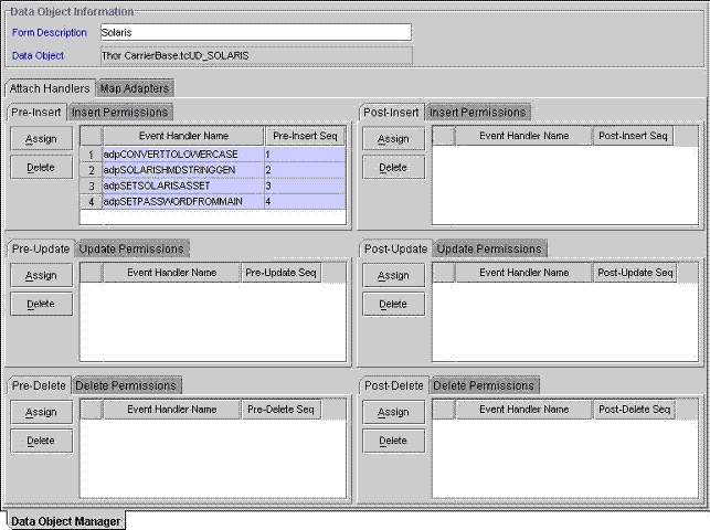

The Data Object Manager form appears in the Development Tools/Business Rule Definition folder. You use this form to do the following:
Assign a rule generator adapter, entity adapter, or an event handler to an object that can add, modify, or delete data in the database.
This type of object is known as a data object.Schedule the adapter or event handler to run according to a schedule (pre-insert, pre-update, pre-delete, post-insert, post-update, or post-delete).Organize the order in which Oracle Identity Manager triggers adapters or event handlers that belong to the same execution schedule.View the user groups that can add, modify, and delete the current data object.Map the variables of an adapter to their proper source and target locations.
Tip:
For more information on adapter variables, rule generator adapters, and entity adapters, refer to the Oracle Identity Manager Tools Reference Guide.Figure 10-2 displays the Data Object Manager form.

After you launch the Data Object Manager form and select a target data object, the tabs of this form become functional.The Data Object Manager form contains the following tabs:
Attach HandlersMap Adapters
Each of these tabs is described in the following sections.
You use this tab to select the rule generator adapters, entity adapters, or event handlers that will be assigned to or removed from a data object. This includes the foloowing:
Specifying when Oracle Identity Manager triggers the assigned event handlers or adapters (on pre-insert, pre-update, pre-delete, post-insert, post-update, or post-delete).Setting the order in which Oracle Identity Manager triggers the adapters or event handlers that belong to the same execution schedule.
When an event handler, rule generator adapter, or entity adapter no longer needs to be triggered by Oracle Identity Manager, you must remove it from the data object.For example, Oracle Identity Manager can trigger the adpCONVERTTOLOWERCASE, adpSOLARISHMDSTRINGGEN, adpSETSOLARISASSET, and adpSETPASSWORDFROMMAIN adapters on pre-insert. Based on the sequence numbers of these adapters, Oracle Identity Manager triggers the adpCONVERTTOLOWERCASE adapter first, followed by the adpSOLARISHMDSTRINGGEN, adpSETSOLARISASSET, and adpSETPASSWORDFROMMAIN adapters, respectively.
To see the user groups that can add, modify, and delete the current data object, click the Insert Permissions, Update Permissions, or Delete Permissions tabs, respectively.The following sections discuss these procedures:
Assigning an event handler, rule generator adapter, or entity adapter to a data objectOrganizing the execution schedule of event handlers or adaptersRemoving an event handler, rule generator adapter, or entity adapter from a data object
To assign an event handler or adapter:
Select the tab of the Data Object Manager form that represents when you want the adapter or event handler to be triggered.
For example, if you want Oracle Identity Manager to activate an adapter on pre-insert, select the Pre-Insert tab.
From the selected tab, click Assign.
The Assignment dialog box appears.
Select the event handler or adapter, and assign it to the data object.
Click OK.
The event handler or adapter is assigned to the data object.
To organize the execution schedule:
Highlight the event handler or adapter whose execution schedule you wish to change.
Click Assign.
Highlight the event handler or adapter.
If you click Up, the selected event handler or adapter will switch places and sequence numbers with the event handler or adapter that precedes it.
If you click Down, the highlighted event handler or adapter will trade places and sequence numbers with the event handler or adapter that follows it.
Repeat Steps 3-4 until all event handlers and adapters have the appropriate sequence numbers.
Click OK.
The event handlers and adapters will now be triggered in the proper order for the execution schedule or schedules that you organized.
