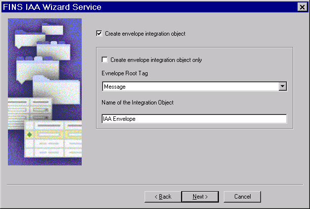

  1. Determine whether or not you only need envelope integration object and select the appropriate option on the FINS IAA Wizard Service dialog box.
  2. Provide a meaningful name for the envelope integration object and click Next.
    NOTE:  It is recommended to use Message as you Envelope Root Tag unless you have customized your .DTD file.

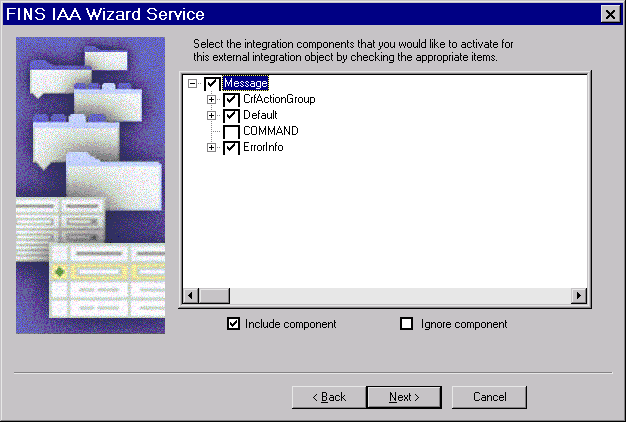

  3. Select the components you would like to include in your integration object and click Next.
    The next dialog box for building external integration object appears. For details, see To create IAA external integration objects.
    NOTE:  Any component that has a plus sign (+) next to it is a parent in a parent-child relationship with one or more child components. If you deselect the parent component, the children below that component are deselected as well. You cannot include a child component without also including the parent. The Integration Object Builder enforces this rule by automatically selecting the parent of any child you choose to include. You should only select the business components required for your business processes to avoid unnecessary performance deterioration.
