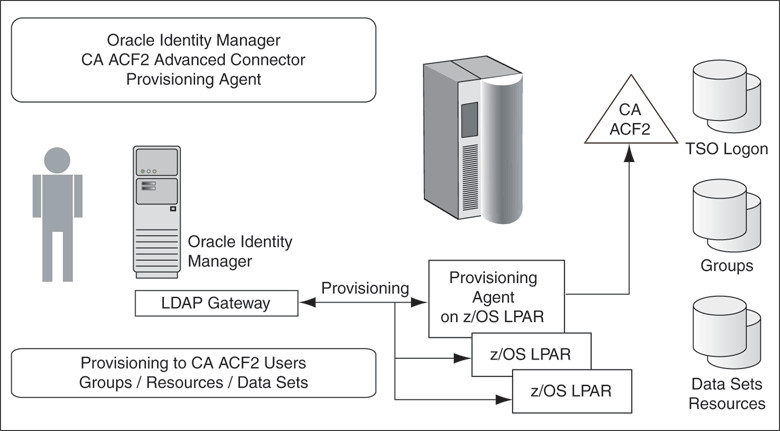

The Provisioning Agent is a mainframe component, receiving native mainframe CA-ACF2 provisioning commands from the LDAP Gateway. These requests are processed against the CA-ACF2 authentication repository with the response parsed and returned to the LDAP Gateway.
The Provisioning Agent includes LDAP bind and authorization requests. In addition to traditional provisioning functions, the Provisioning Agent can also build the necessary TSO logon functions, including the building CLIST files, and working to replicate existing mainframe user profile scenarios. The Provisioning Agent can also extend authorization to data sets, groups, and resources through enterprise rules set in by Oracle Identity Manager.
Internal to mainframe architecture is significant communication of connector resources and internal mainframe memory subpools for enterprise loads at peak times, supporting over a million transactions per day. The Provisioning Agent is protected by AES 128 encryption and APF authorized resources.
The Provisioning Agent receives Identity and Authorization change events, and effects requested changes on the z/OS mainframe authentication repository, CA-ACF2. The Provisioning Agent is a mainframe-installed component that receives native mainframe requests from the LDAP Gateway.
An important architectural feature of the Provisioning Agent is that provisioning updates are made from the LDAP Gateway to the CA-ACF2 authentication repository. As such, the Provisioning Agent needs to be installed on at least one z/OS LPAR. Provisioning commands sent from Oracle Identity Manager then change authentication and authorization across all LPARS serviced by the CA-ACF2 authentication repository. Within this framework, multiple CA-ACF2 systems which are not externally synchronized will require a second Provisioning Connector.
While most provisioning commands are designed around direct access to CA-ACF2, some LDAP provisioning commands are executed in multiple mainframe commands. For example, to provision for TSO access, some systems require modification to a CLIST profile. The type of command depends on which mainframe process is to be accessed.
While not within the scope of standard Oracle Identity Management provisioning, the Provisioning Agent can extend control to TSO commands, CICS commands, batch jobs, and other mainframe resources.

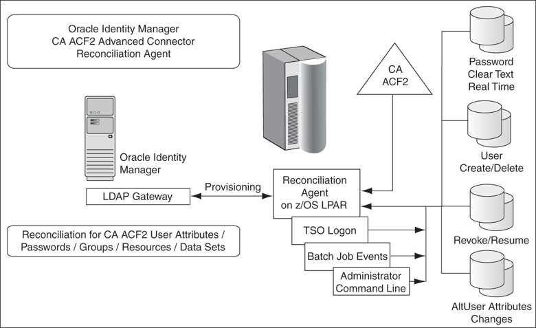

When an event occurs on the mainframe, independent of any custom installed technology, the event is processed through an appropriate mainframe exit. Because the Reconciliation Agent uses exit technology, there are no hooks in the z/OS mainframe operating system.
Identity events that arise from a user at TSO login, changes by an administrator from the command prompt, or events resulting from batch jobs are detected and notification messages are securely sent in real time. The Reconciliation Agent captures changes to user attributes (any ALTUSER change), changes to a user account (REVOKE, RESUME), and certain changes to user authorization for groups and resources. If a user account is created or deleted on the mainframe, the Reconciliation Agent will notify Oracle Identity Manager and even create a corresponding account in Oracle Identity Manager.
Passwords fall into a special category. If business rules permit, a password change will be passed to Oracle Identity Manager in clear text and real time. In a testing environment, it is almost immediate. Within other business rules, only a notification that the password has been changed will be passed.
Internal to mainframe architecture is significant communication of connector resources and internal mainframe memory subpools for enterprise loads at peak times. The Reconciliation Agent was specifically designed to handle peak loads from a mainframe batch job. By allocating one meg mainframe memory to the messaging subpools, 50,000 identity event messages can be held as fast as the batch job can produce them (about 8 minutes). These messages are then spooled to the LDAP Gateway, which supplies the messages to Oracle Identity Manager for subsequent processing (typically over the next hour). The Reconciliation Agent is protected by AES 128 encryption and APF authorized resources.
The Reconciliation Agent sends notification events to the Oracle Identity Manager LDAP Gateway from the z/OS mainframe. This architecture does not originate with CA-ACF2, but captures the events just outside the operating system using exit technology, in real time.
A command execution is passed through an exit, just before full completion of the native mainframe command. A common use of this technology is to require user accounts or passwords to be formatted to a proper length or that they must contain at least one letter and one number. If the exit fails, the command fails and returns an error message. By capturing identity or authentication events at an exit, the Reconciliation Agent captures these events outside the operating system, just prior to completing the command and storing the results in the CA-ACF2 authentication repository.
As with the Provisioning Agent, there is an architectural dependence based on the LPAR. When a user account is created, is authorized to something, or works on the mainframe, they do this on an LPAR. Since all actions are within the LPAR and the Reconciliation Agent detected events from an LPAR exit, the Reconciliation Agent must be installed on each LPAR. This is a scheduled event, usually done with a maintenance schedule, because the an LPAR exit change is only recognized after an IPL.
