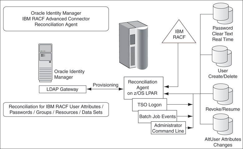

When an event occurs on the mainframe, independent of any custom installed technology, the event is processed through an appropriate mainframe exit. Because the Reconciliation Agent uses exit technology, there are no hooks in the z/OS mainframe operating system.
Identity events that arise from a user at TSO login, changes by an administrator from the command prompt, or events resulting from batch jobs are detected and notification messages are securely sent in real time. The Reconciliation Agent captures changes to user attributes (any ALTUSER change), changes to a user account (REVOKE, RESUME), and certain changes to user authorization for groups and resources. If a user account is created or deleted on the mainframe, the Reconciliation Agent will notify Oracle Identity Manager and even create a corresponding account in Oracle Identity Manager.
Passwords fall into a special category. If business rules permit, a password change will be passed to Oracle Identity Manager in clear text and real time. In a testing environment, it is almost immediate. Within other business rules, only a notification that the password has been changed will be passed.
Internal to mainframe architecture is significant communication of connector resources and internal mainframe memory subpools for enterprise loads at peak times. The Reconciliation Agent was specifically designed to handle peak loads from a mainframe batch job. By allocating one meg mainframe memory to the messaging subpools, 50,000 identity event messages can be held as fast as the batch job can produce them (about 8 minutes). These messages are then spooled to the LDAP Gateway, which supplies the messages to Oracle Identity Manager for subsequent processing (typically over the next hour). The entire Reconciliation Agent is protected by AES 128 encryption and APF authorized resources.
The Reconciliation Agent sends notification events to the Oracle Identity Manager LDAP Gateway from the z/OS mainframe. This architecture does not originate with IBM RACF Advanced, but captures the events just outside the operating system using exit technology, in real time.
A command execution is passed through an exit, just before full completion of the native mainframe command. A common use of this technology is to require user accounts or passwords to be formatted to a proper length or that they must contain at least one letter and one number. If the exit fails, the command fails and returns an error message. By capturing identity or authentication events at an exit, the Reconciliation Agent captures these events outside the operating system, just prior to completing the command and storing the results in the IBM RACF Advanced authentication repository.
As with the Provisioning Agent, there is an architectural dependence based on the LPAR. When a user account is created, is authorized to something, or works on the mainframe, they do this on an LPAR. Since all actions are within the LPAR and the Reconciliation Agent detected events from an LPAR exit, the Reconciliation Agent must be installed on each LPAR. This is a scheduled event, usually done with a maintenance schedule, because the an LPAR exit change is only recognized after an IPL.
