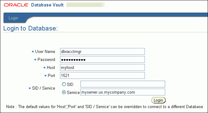

Log in by using the Oracle Database Vault Owner (DV_OWNER) account that you created during installation.
For example:
By default, you cannot log in to Oracle Database Vault Administrator by using the SYS, SYSTEM, or other administrative accounts. You can log in if you have the DV_OWNER or DV_ADMIN roles.
The login page enables you to log in to the default Oracle Database Vault installation. If you want to log in to a different Database Vault installation, enter the following values:
Host: Enter the host name of the computer of the Oracle Database Vault installation you want.
Port: Enter the port number.
SID/Service: To connect using the server identification, select SID and then enter the server ID of the database you want, for example, orcl. To connect using the service information, select Service, and then enter the service identification in the following format:
server.domain
For example:
myserver.us.mycompany.com
To find the SID and service connection information, check the tnsnames.ora file. By default, this file is located in ORACLE_BASE/ORACLE_HOME/network/admin.

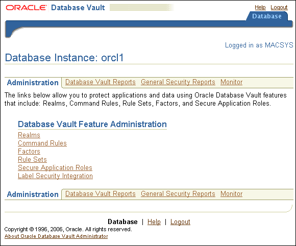

Figure 3-1 shows the Oracle Database Vault Administrator home page, which appears after you log in.
Figure 3-1 Oracle Database Vault Administrator Home Page
