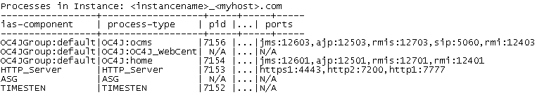

  5. Perform an opmnctl status command to see the status of the Edge Proxy.
    The Edge Proxy runs automatically after being installed and reports a status of "Alive."

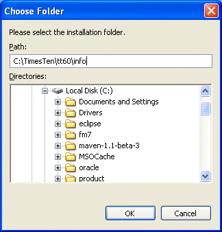

  6. Do not select the default data store location. Click Browse.
  7. Enter <TimesTen Home>\info, where <TimesTen Home> is what you selected in step 3 above and click OK (Figure 2-1).
    Figure 2-1 Selecting an Oracle TimesTen Data Store Location
    Description of "Figure 2-1 Selecting an Oracle TimesTen Data Store Location"
  8. Click Next in the dialog that appears and proceed with the installation.

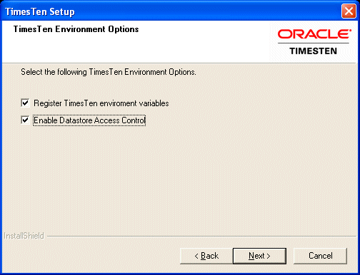

  10. Register environment variables and also make sure to enable datastore access control (Figure 2-2).
    Figure 2-2 Registering Environment Variables and Enabling Access Control
    Registering Environment Variables; Enabling Access Control
    Description of "Figure 2-2 Registering Environment Variables and Enabling Access Control"

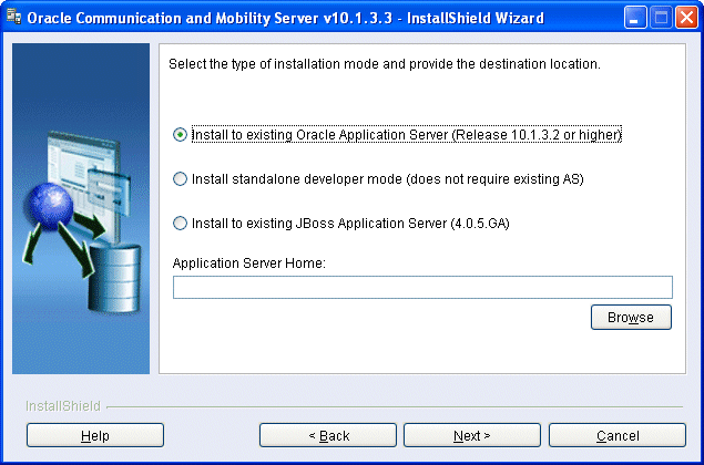

Selecting an Installation Mode
After selecting the installation type (and after configuring Custom Installation and Edge Proxy, if selected), the OCMS Installation Mode window appears (Figure 2-3).
Figure 2-3 OCMS Installation Mode Window
Description of "Figure 2-3 OCMS Installation Mode Window"
Select one of the following installation modes. For more information on these installation modes see "Installation Modes" in the Product and Installation Overview chapter.
  • Install to existing Oracle Application Server, Release 10.1.3.2 or higher: This installation mode is the default selection and it is also the recommended selection for production deployments. The InstallShield for OCMS verifies if the provided Application Server Home contains an Oracle Application Server installation.
  • Install in standalone developer mode: The standalone developer mode is recommended for development users only due to limited management capabilities. This option installs Oracle Containers for J2EE (OC4J) software, Release 10.1.3.2, and does not require an application server.
  • Install to existing JBoss Application Server, Release 4.0.5GA or higher. This installation mode allows OCMS to be managed from JBoss Application Server.
Specifying the Application Server Home
The Application Server Home is the installation directory for Oracle Application Server, or the installation directory for a standalone developer mode OC4J installation.
To specify the Application Server Home:
  1. Specify an installation directory in the Application Server Home field.
    For Oracle Application Server installation mode, specify the application server home.
    For standalone developer mode enter the path of an empty or non-existent directory. The default directory will work correctly. You can use the Browse button to navigate to a directory. You can also create a new directory.
    For JBoss Application Server mode, enter the path to your JBoss Application Server installation.
  2. Click Next to continue.

Specifying Oracle TimesTen In-Memory Database Location
You must install and configure an Oracle TimesTen In-Memory Database if you install the Subscriber Data Services component of OCMS.
To specify the TimesTen database location:
  1. Enter the TimesTen database location in the TimesTen Home field. You can use the Browse button to navigate to the directory.
    On a Windows operating systems, the installer prepopulates the field with the TimesTen location from the Windows registry.

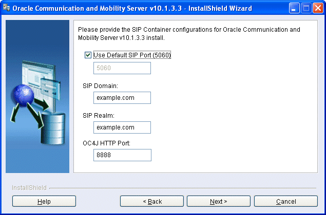

Configuring the SIP Container
After the InstallShield Wizard for OCMS verifies the TimesTen requirements, it displays the SIP Container configuration window (Figure 2-4).
Figure 2-4 OCMS SIP Servlet Container Configuration Window
Description of "Figure 2-4 OCMS SIP Servlet Container Configuration Window"
To configure the SIP Container:
  1. Select or configure the following options:
    • Use Default SIP Port (selected by default): The InstallShield for OCMS displays the default SIP port. The port used is 5070 in an installation with Edge Proxy, and is port 5060 in an installation without Edge Proxy.
      If you receive a message that the SIP port is in use, exit all client applications, select Back, and return to this window. To provide a different port number, deselect this option and enter the port number. This port can be reconfigured later through a JMX console. Refer to the Oracle Communication and Mobility Server Administrator's Guide for configuration details.
    • SIP Domain: Specifies the domain or hostname of the machine where OCMS is being installed. The default is example.com.
    • SIP Realm: Specifies the SIP realm used for authentication. This is also the domain or hostname of the machine where OCMS is being installed. The default is example.com.
    • OC4J HTTP Port (standalone developer mode only): Specifies the HTTP port used to manage OCMS through OC4J in standalone developer mode. The default port is 8888. If another application uses this port you can select another port.
      In Oracle Application Server mode you will not have the option to set the OC4J HTTP Port as it is autodetected by the installer from your Oracle Application Server installation.
      In JBoss Application Server mode, you will not have the option to set the OC4J HTTP Port. Instead, the default port for accessing the JMX console is "8080" and cannot be changed during install.
InstallShield for OCMS enables configuration of only one SIP domain and one SIP realm. You can configure additional SIP domains and SIP realms after the installation using the Domains and Realms attribute of the SIP Servlet Container MBean. Multiple SIP domains can exist in a SIP realm. Refer to Oracle Communication and Mobility Server Administrator's Guide for more information.

Listing the Oracle Remote Method Invocation (RMI) Port
Oracle Application Server Containers for J2EE (OC4J) provides support for allowing EJBs to invoke one another across OC4J containers using the proprietary Remote Method Invocation (RMI)/Oracle RMI (ORMI) protocol. For more information on Oracle RMI, refer to Oracle Application Server Containers for J2EE Services Guide.
If a particular JMX application requires connecting to the Oracle RMI port, then you will need to know what port is assigned for RMI. The RMI port is dynamically assigned by OPMN (Oracle Process Management and Notification).
The following command lists the latest port assignments:
opmnctl status -l
For example (some columns omitted for clarity):
Figure 2-5 Output from opmnctl command
output of opmnctl status command
Description of "Figure 2-5 Output from opmnctl command"
The ports column of the table lists the ports selected by opmn. The following example corresponds to the OCMS instance of OC4J ("OC4J: ocms"):
jms:12603,ajp:12503,rmis:12703,sip:5060,rmi:12403

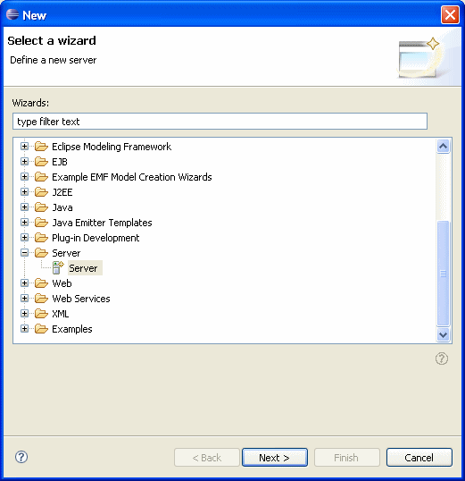

  3. Define OCMS as a new server in Eclipse by selecting, File, New, Other.
    The Define a New Server wizard appears (Figure 2-6).
  4. Select Server under the Server folder.
  5. Click Next.
  6. Navigate to the Oracle folder and select the following application server.
    • OCMS SipAS/OC4J 10.1.3.x: this refers to an installation of OCMS in an Oracle Application Server environment or standalone developer mode OC4J environment.
  7. Click Next.
  8. Specify the path for the OCMS instance, and specify the same path for the Classpath Variable. Continue and complete the wizard.
    You can now start OCMS by opening the Servers view.
  9. Select Window, Show view, and Other. Select Server, Servers and click OK (Figure 2-6).
  10. Figure 2-6 Defining OCMS as a New Server in Eclipse
