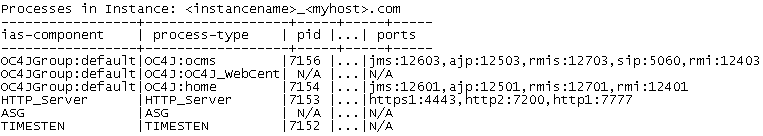

  5. Perform an opmnctl status command to see the status of the Edge Proxy.
    The Edge Proxy runs automatically after being installed and reports a status of "Alive."

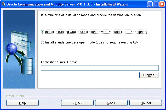

Selecting an Installation Mode
After selecting the installation type (and after configuring Custom Installation and Edge Proxy, if selected), the OCMS Installation Mode window appears (Figure 2-1).
Figure 2-1 OCMS Installation Mode Window
Description of "Figure 2-1 OCMS Installation Mode Window"
Select one of the following installation modes. For more information on these installation modes see "Installation Modes" in the Product and Installation Overview chapter.
  • Install to existing Oracle Application Server, Release 10.1.3.2 or higher: This installation mode is the default selection and it is also the recommended selection for production deployments. The InstallShield for OCMS verifies if the provided Application Server Home contains an Oracle Application Server installation.
  • Install in standalone developer mode: The standalone developer mode is recommended for development users only due to limited management capabilities. This option installs Oracle Containers for J2EE (OC4J) software, Release 10.1.3.2, and does not require an application server.

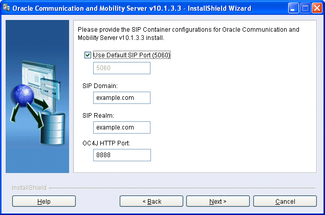

Configuring the SIP Container
After the InstallShield Wizard for OCMS verifies the TimesTen requirements, it displays the SIP Container configuration window (Figure 2-2).
Figure 2-2 OCMS SIP Servlet Container Configuration Window
Description of "Figure 2-2 OCMS SIP Servlet Container Configuration Window"
To configure the SIP Container:
  1. Select or configure the following options:
    • Use Default SIP Port (selected by default): The InstallShield for OCMS displays the default SIP port. The port used is 5070 in an installation with Edge Proxy, and is port 5060 in an installation without Edge Proxy.
      If you receive a message that the SIP port is in use, exit all client applications, select Back, and return to this window. To provide a different port number, deselect this option and enter the port number. This port can be reconfigured later through a JMX console. Refer to the Oracle Communication and Mobility Server Administrator's Guide for configuration details.
    • SIP Domain: Specifies the domain or hostname of the machine where OCMS is being installed. The default is example.com.
    • SIP Realm: Specifies the SIP realm used for authentication. This is also the domain or hostname of the machine where OCMS is being installed. The default is example.com.
    • OC4J HTTP Port (standalone developer mode only): Specifies the HTTP port used to manage OCMS through OC4J in standalone developer mode. The default port is 8888. If another application uses this port you can select another port.
      In Oracle Application Server mode you will not have the option to set the OC4J HTTP Port as it is autodetected by the installer from your Oracle Application Server installation.
  2. Click Next to continue.
InstallShield for OCMS enables configuration of only one SIP domain and one SIP realm. You can configure additional SIP domains and SIP realms after the installation using the Domains and Realms attribute of the SIP Servlet Container MBean. Multiple SIP domains can exist in a SIP realm. Refer to Oracle Communication and Mobility Server Administrator's Guidefor more information.

The following command lists the latest port assignments:
opmnctl status -l
For example (some columns omitted for clarity):
Figure 2-3 Output from opmnctl command
output of opmnctl status command
Description of "Figure 2-3 Output from opmnctl command"
The ports column of the table lists the ports selected by opmn. The following example corresponds to the OCMS instance of OC4J ("OC4J: ocms"):
jms:12603,ajp:12503,rmis:12703,sip:5060,rmi:12403
