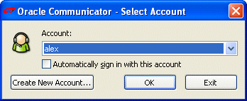

The Select Account window is displayed (Figure 3-1).
Figure 3-1 Selecting an Oracle Communicator Account
From the drop-down list, select the account you have just defined and click OK.

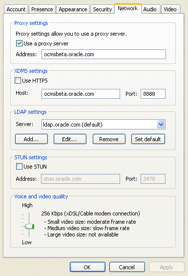

Click the settings icon and select Preferences > Network.
Check Use a proxy server and fill in the address of your SIP proxy server in the space provided (Figure 3-2) and click OK.
Check "Use HTTPS" if Oracle Application Server is configured with an HTTPS server.
Modify the default value under the section "XDMS Settings" from xcap.<machine>.<domain> to a valid value.
For port, use one of the following values:
Use 8888 for standalone developer mode installation.
Use the HTTP server port for an Oracle AS installation with an HTTP server.
Use 7785 for an Oracle AS installation without an HTTP server.
For HTTPS, use the HTTPS port for the Oracle AS installation.
This configuration allows Oracle Communicator clients to see each other's Presence information and to make calls.

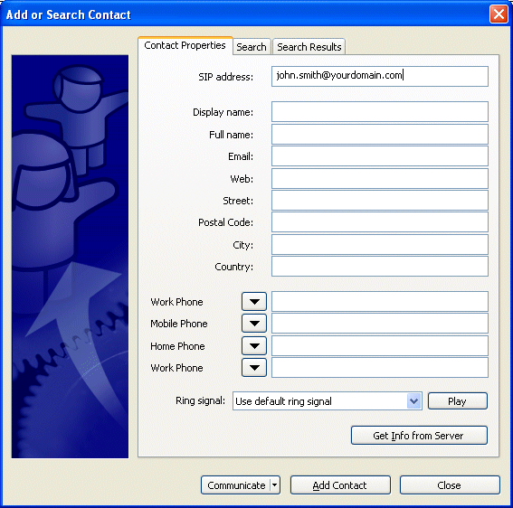

In the Oracle Communicator client where the first test user is logged in, click the Contacts button and select Add Contact (Figure 3-3).
Tip:
For more information on how to add a contact in Oracle Communicator refer to the Oracle Communicator online help.Figure 3-3 Adding an Oracle Communicator Contact
In the Contact Properties tab that displays, enter the SIP address of the second test user you defined earlier in the space provided.
Click Add Contact.
Observe the second Oracle Communicator client instance. A message is displayed in which test user one requests permission to subscribe to the Presence of test user two.
