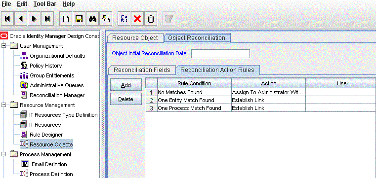

1.6.5 Reconciliation Action Rules for Target Resource Reconciliation
Table 1-4 lists the action rules for target resource reconciliation.
Table 1-4 Action Rules for Target Resource Reconciliation
Rule Condition Action
No Matches Found
Assign to Administrator With Least Load
One Entity Match Found
Establish Link
One Process Match Found
Establish Link
No action is performed for rule conditions that are not predefined for this connector. You can define your own action rule for such rule conditions. See Oracle Identity Manager Design Console Guide for information about modifying or creating reconciliation action rules.
After you deploy the connector, you can view the reconciliation action rules for target resource reconciliation by performing the following steps:
  1. Log in to the Oracle Identity Manager Design Console.
  2. Expand Resource Management.
  3. Double-click Resource Objects.
  4. Search for and open the LOTUSRO resource object.
  5. Click the Object Reconciliation tab, and then click the Reconciliation Action Rules tab. The Reconciliation Action Rules tab displays the action rules defined for this connector. Figure 1-3 shows the reconciliation action rule for target resource reconciliation.
    Figure 1-3 Reconciliation Action Rules for Target Resource Reconciliation

1.7.3 Reconciliation Action Rules for Trusted Source Reconciliation
Table 1-6 lists the action rules for trusted source reconciliation.
Table 1-6 Action Rules for Trusted Source Reconciliation
No Matches Found
Create User
Establish Link
Establish Link
  4. Search for and open the Xellerate User resource object.
  5. Click the Object Reconciliation tab, and then click the Reconciliation Action Rules tab. The Reconciliation Action Rules tab displays the action rules defined for this connector. Figure 1-5 shows the reconciliation action rule for target resource reconciliation.
    Figure 1-5 Reconciliation Action Rules for Trusted Source Reconciliation
    Description of Figure 1-5 follows
    Description of "Figure 1-5 Reconciliation Action Rules for Trusted Source Reconciliation"
