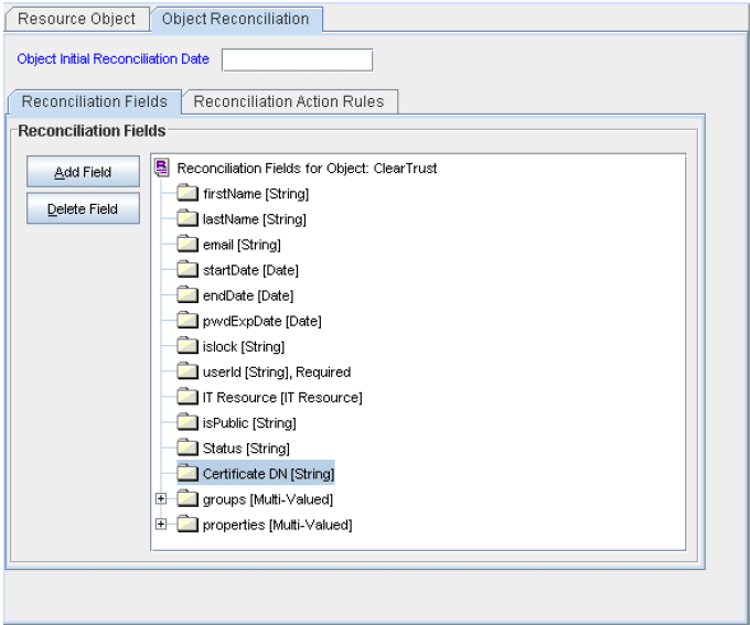

  3. Add the new attribute to the list of reconciliation fields in the resource object as follows:
    1. Expand Resource Management.
    2. Double-click Resource Objects.
    3. Search for and open the ClearTrust resource object.
    4. On the Object Reconciliation tab, click Add Field, and then enter the following values:
      Field Name: Certificate DN
      Field Type: String
      The following screenshot shows this form:
      Surrounding text describes target_res_res_obj.gif.
    5. If you are using Oracle Identity Manager release 11.1.1, then click Create Reconciliation Profile. This copies changes made to the resource object into the MDS.
    6. Click the Save icon.

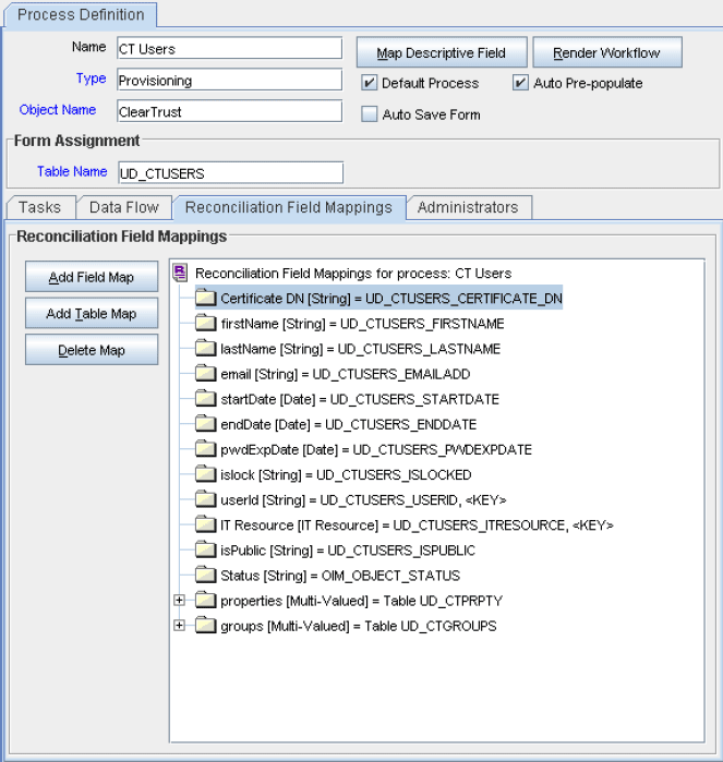

  4. Create a reconciliation field mapping for the new attribute in the process definition form as follows:
    1. Expand Process Management.
    2. Double-click Process Definition.
    3. Search for and open the CT Users process definition.
    4. On the Reconciliation Field Mappings tab, click Add Field Map, and then select the following values:
      Field Type: String
      Process Data Field: Certificate DN
      Surrounding text describes target_res_procss_defn.gif.
    5. Click the Save icon.

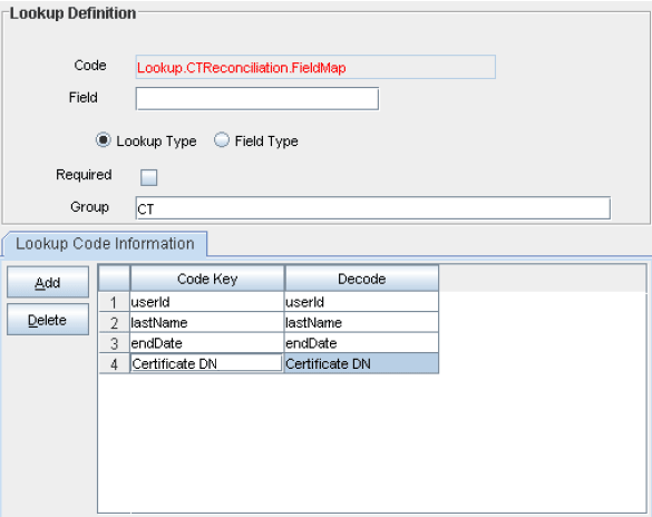

  5. Create an entry for the attribute in the lookup definition for reconciliation as follows:
    1. Expand Administration.
    2. Double-click Lookup Definition.
    3. Search for and open the Lookup.CTReconciliation.FieldMap lookup definition.
    4. Click Add and enter the Code Key and Decode values for the attribute. The Code Key value must be the name of the attribute given in the resource object. The Decode value is the name of the attribute in the target system.
      For example, enter organization in the Code Key field and then enter o in the Decode field.
      Surrounding text describes target_src_lookup_defn.gif.

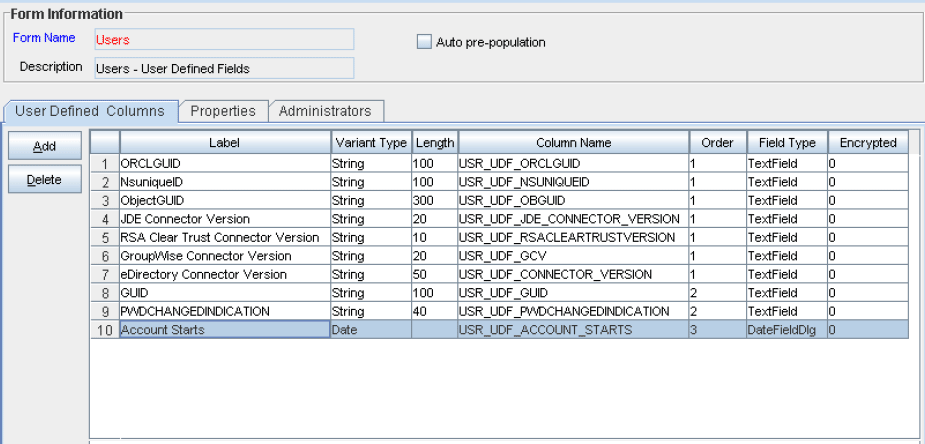

  2. Add the new attribute on the Users process form as follows:
    2. Double-click User Defined Field Definition.
    3. Search for and open the Users process form.
    4. Click Add.
    5. In the User Defined Fields dialog box, enter the details of the attribute.
      For example, if you are adding the Account Starts attribute, then enter the following details in the User Defined Fields dialog box:
      • In the Label field, enter Account Starts.
      • From the Data Type list, select Date.
      • From the Field Type list, select DateField with Dialog.
      • In the Column Name field, enter USR_UDF_ACCOUNT_STARTS.
      Surrounding text describes trusted_src_usrs_form.gif.
    6. Click Save.

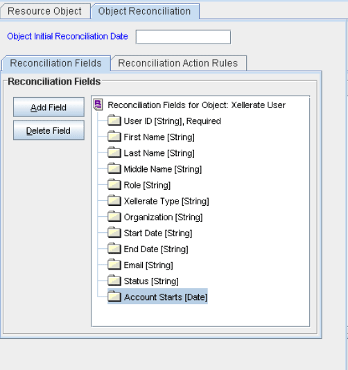

    3. Search for and open the Xellerate User resource object.
    4. On the Object Reconciliation tab, click Add Field.
    5. Enter the details of the attribute.
      For example, enter Account Starts in the Field Name field and select Date from the Field Type list.
    6. If you are using Oracle Identity Manager release 11.1.1, then click Create Reconciliation Profile. This copies changes made to the resource object into the MDS.
    7. Click Save.
      The following screenshot shows the Account Starts field added to the resource object:
      Surrounding text describes trusted_src_res_obj.gif.

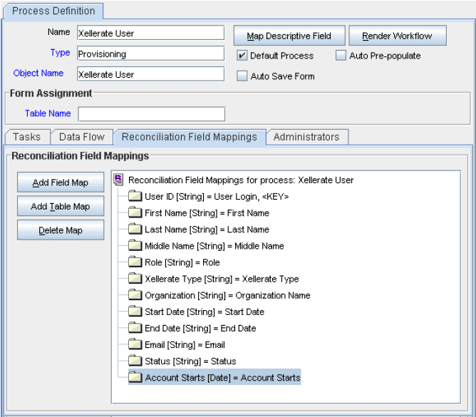

  4. Create a reconciliation field mapping for the new attribute in the process definition as follows:
    3. Search for and open the Xellerate User process definition.
    4. On the Reconciliation Field Mappings tab, click Add Field Map.
    5. In the Field Name field, select the value for the attribute that you want to add.
      For example, select Account Starts=Account Starts.
      Surrounding text describes trusted_src_procss_defn.gif.
    6. Click Save.

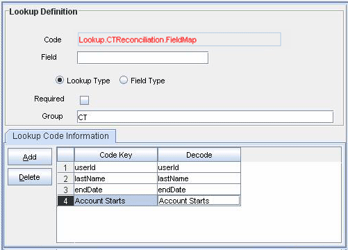

    4. Click Add and enter the Code Key and Decode values for the attribute. The Code Key value must be the name of the attribute on the target system, which you determined at the start of this procedure. The Decode value is the name that you provide for the reconciliation field in Step 3.e.
      For example, enter Account Starts in the Code Key field and then enter Account Starts in the Decode field.
      Surrounding text describes trusted_src_lookup_defn.gif.
    5. Click Save.
