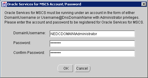

Oracle Services for MSCS runs as a Windows service that must run under a domain user account (not the system account) that has Administrator privileges on all cluster nodes. You specified this user account for Oracle Services for MSCS when you installed Oracle Fail Safe. (See Oracle Fail Safe Installation Guide for more information about this part of the installation.)
Oracle Fail Safe also has its own security component. Therefore, if you make changes to the Windows user account (user name, password, or domain) used by Oracle Services for MSCS, then you must also update the security settings for both the Windows service and Oracle Fail Safe. Oracle Fail Safe provides a Security Setup tool to update this security information.
Oracle Fail Safe provides a Security Setup tool that you can use to update the information for the account under which Oracle Services for MSCS runs. The Oracle Services for MSCS Security Setup tool is installed when you install Oracle Services for MSCS.
On a cluster node, you can access the Oracle Services for MSCS Security Setup tool from the Windows taskbar. To do so, from the Windows Start menu, select Programs (or All Programs), then Oracle_Home, and finally, Oracle Services for MSCS Security Setup.
Be sure that you use the Oracle Services for MSCS Security Setup tool to update the security information on all cluster nodes, and that you use the same account on all cluster nodes.Figure 4-2 shows the setup for user account Administrator in the domain NEDCDOMAIN.
Figure 4-2 Windows User Account Settings for the Oracle Services for MSCS
