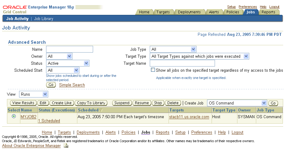

The Job Activity page (Figure 8-1) is the hub of the Job System. From this page you can:
Search for existing job runs and job executions
You can restrict the search by name, owner, status, scheduled start, job type, target type, and target name.
Create a job
View, edit, create like, suspend, resume, stop, and delete a run
View, edit, create like, suspend, resume, retry, stop, and delete an execution

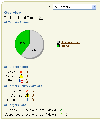

After you submit jobs, the status of all job executions across all targets is automatically rolled up and available for review on the Grid Control Console Home page. Figure 8-2 shows the All Targets Jobs information on the Grid Control Console Home page.
Figure 8-2 Summary of Target Jobs on the Grid Control Console Home Page
This information is particularly important when you are examining jobs that execute against hundreds or thousands of systems. You can determine the job executions that have failed. By clicking the number associated with a particular execution, you can drill down to study the details of the failed job.
