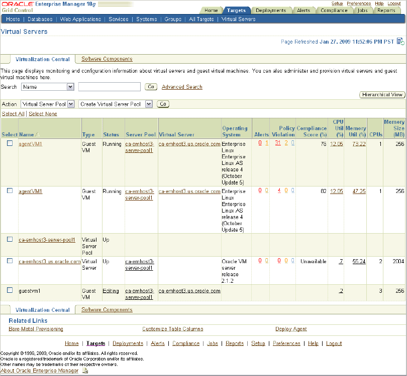

The Enterprise Manager Virtualization Central page (Figure 14-1) shows the following:
A quick view of the status of the virtual server and guest virtual machines and basic information about them
CPU and Memory utilization of virtual servers
Information about the server pool to which the virtual servers are registered
Drilldowns to server pools, virtual servers, and guest virtual machines home pages from where you can view more information about these targets
Allows you to perform administrative tasks such as starting and stopping guest virtual machines
Allows you to perform provisioning activities such as creating virtual server pools, registering virtual servers, and creating guest virtual machines
Starting from the Virtualization Central page, you can access additional details and management functions by drilling down through the user interface. In addition, the Virtualization Central page provides a list of Related Links. From these links you can perform activities such as bare metal provisioning of Oracle VM server software, cutomization of table columns, and deployment of Enterprise Manager agent on a guest virtual machine.

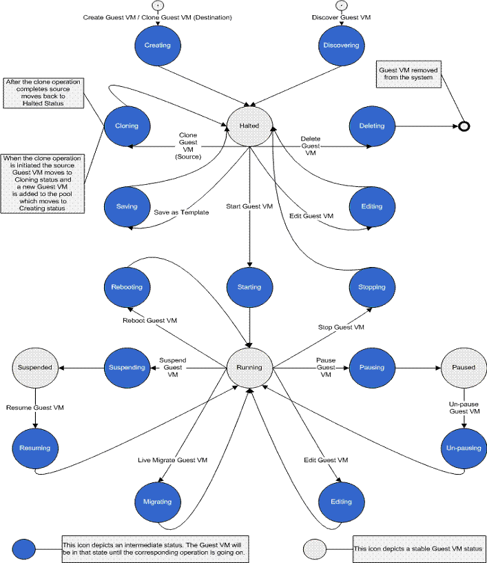

The Monitoring Server agent (Enterprise Manager agent that monitors Oracle VM servers) should be upgraded to version 10.2.0.5.0.A guest virtual machine can have the following additional status:
Operation Error - This is an intermediate status. The guest virtual machine moves to this status when an operation fails. The user has to perform the Clear Operation Error action to move the guest virtual machine out of this status.
Error - This status indicates that there are some errors with the guest virtual machine, and it cannot be used.
Unknown - This status indicates that Enterprise Manager has not been able to collect the state of the guest virtual machine.

Figure 14-2 shows the guest virtual machine state transition.
Figure 14-2 Guest Virtual Machine State Transition Diagram

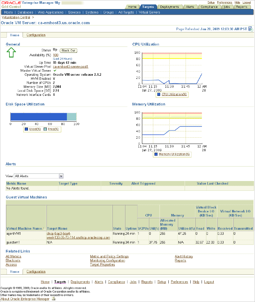

On the Oracle VM server home page (Figure 14-3), you can view basic information about the Oracle VM server including status, availability, operating system details, alerts, and guest virtual machines running on the Oracle VM server.
Following are the graphs described on the Oracle VM server home page:
The CPU Utilization graph provides information about the total physical CPU utilization(%) of the Oracle VM server.
The Memory Utilization graph provides information about the physical memory utilization(%) of the Oracle VM server.
The Disk Space Utilization graph provides information about the free and used local disk (partitioned) space on the Oracle VM server.
The Guest Virtual Machine section shows the following metrics for each of the guest virtual machines running on this Oracle VM Server.
Virtual Machine Name - The name of the guest virtual machine running on the Oracle VM Server.
Target Name - The Host target name if this is a managed guest virtual machine.
State - State of the guest virtual machine. The state can be either "Running" or "Paused".
Uptime - Displays how long this guest virtual machine has been "Running". This also includes the time this machine has been in the "Paused" state.
CPU| vCPUs - Displays the number of Virtual CPUs this guest virtual machine has.
CPU | Util(%) - Displays the amount of CPU utilization with respect to Total Physical CPU Utilization.
Memory|Allocated - Displays the amount of memory allocated to this guest virtual machine.
Memory|Util(%) - Displays the amount of memory utilized with respect to the memory allocated to the guest virtual machine.
Virtual Block Device I/O (KB/sec) | Read - Displays the amount of data read from the block device.
Virtual Block Device I/O (KB/sec) | Write - Displays the amount of data written to the block device.
Virtual Network I/O (KB/sec)|Received - Displays the amount of data received by the Virtual Network interfaces.
Virtual Network I/O (KB/sec)|Transmitted - Displays the amount of data transmitted by the Virtual Network interfaces.

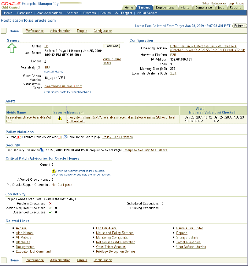

The Guest Virtual Machine Home page is available only for managed guest virtual machines. It is similar to the Host Home page in Enterprise Manager. On this page, you can view basic information about the guest virtual machine including configuration details, alerts, policy violations, job details, patch advisories details, and security details. For more information about hosts, see Host and Third-Party Target Management.
To get the complete benefits of managing and monitoring guest virtual machines using Enterprise Manager, the guest virtual machine must have an agent installed on it.
Figure 14-4 Guest Virtual Machine Home Page

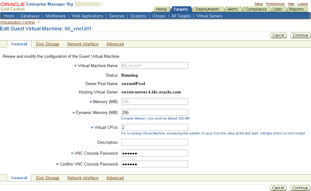

A guest virtual machine can be edited as shown in Figure 14-5.
Figure 14-5 Edit Guest Virtual Machine Page
You can edit the Name, Memory, Dynamic Memory, vCPUs, VNC Console Password, add and remove disk storage, add network interfaces, and modify the boot order for the guest virtual machine. Table 14-2 lists the guest virtual machine fields that can be edited and the action needed for the changes to take effect.
Table 14-2 Guest Virtual Machines: Editable Fields
| Editable Field | Action for Changes to Take Effect |
Virtual Machine Name |
This field can be edited only for guest virtual machines in the Halted status. Changes will take effect immediately when the guest virtual machine is started. |
Memory |
Dynamic Memory |
For para-virtualized guest virtual machines, changes to the memory take affect without rebooting the guest virtual machine. For hardware-virtualized guest virtual machines, changes to memory take affect only after rebooting the guest virtual machine. |
Virtual CPUs |
For para-virtualized guest virtual machines, number of vCPUs can be edited and changes take affect without rebooting the guest virtual machine. For hardware-virtualized guest virtual machines, changes to vCPUs take affect only after rebooting the guest virtual machine. |
VNC Console Password |
New password takes affect after the guest virtual machine is stopped and restarted. |
Add/Remove Disk Storage |
Changes take place immediately. |
Add/Remove Network Interface |
Boot Order |
Requires the guest virtual machine to be stopped and restarted. |
If you want to restrict certain guest virtual machines to run on only certain Oracle VM servers, use the Preferred server list feature. Preferred server list contains all the Oracle VM servers on which this guest virtual machine is allowed to run. If the "Automatic" option is selected when creating a guest virtual machine, Enterprise Manager picks the Oracle VM server with maximum resources to run the guest virtual machine. When auto-restarting guest virtual machines during fail-over scenario, Enterprise Manager picks a preferred Oracle VM server to auto-restart the guest virtual machine.

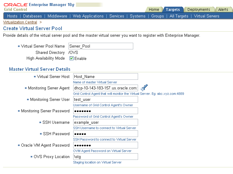

For Enterprise Manager to manage Oracle VM servers, you will need to create a virtual server pool. Each virtual server pool must have at least one Oracle VM virtual server. The first virtual server added to the pool acts as the master server for the server pool.
Figure 14-6 shows the Create Virtual Server Pool page. You can specify a virtual server pool and the master server.
Figure 14-6 Create Virtual Server Pool Page
You will need to specify the following fields:
Virtual Server Host — As part of the virtual server pool creation, one virtual server needs to be specified, which will act as the Master Server for the server pool.
Monitoring Server Agent — Virtual servers in a server pool are monitored remotely by an Enterprise Manager agent. Specify the agent that will monitor the virtual servers.
Monitoring Server User — Operating system user that owns the Enterprise Manager agent home/agent install and has read and write permission on agent home directory.
Monitoring Server Password — Password for the user that owns the Enterprise Manager agent home/agent install.
SSH Username and Password — User name and password for Enterprise Manager to SSH into the virtual server machine.
Oracle VM Agent Password — Every Oracle VM server has an in-built Oracle VM agent running on it. Specify the password for this agent.
OVS Proxy Location — This is a directory on the virtual server where the scripts required for monitoring are stored when the virtual server is registered with Enterprise Manager.

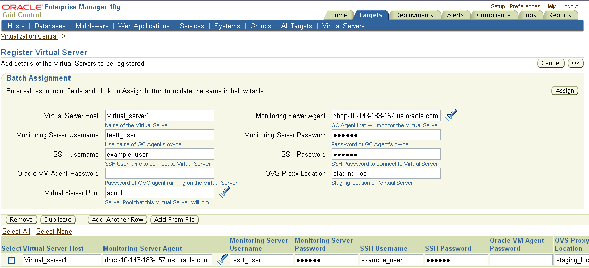

After creating a virtual server pool, you can register the virtual servers with the server pool (Figure 14-7). To register virtual servers, you will need to specify the fields described in Creating Virtual Server Pool.

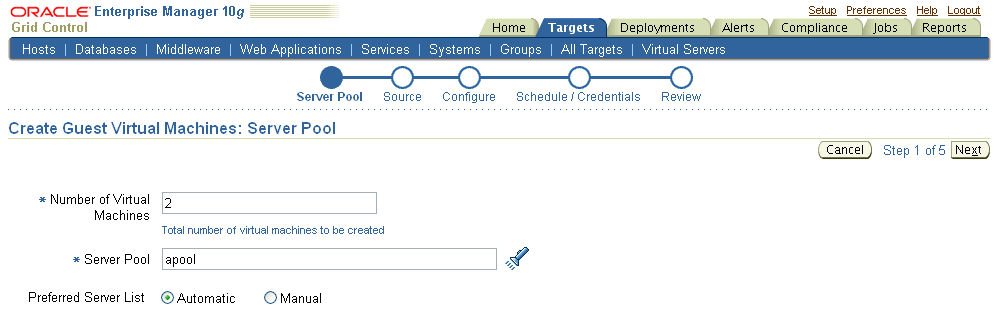

Figure 14-8 Create Guest Virtual Machines Wizard
Figure 14-8 shows the Create Guest Virtual Machines: Server Pool page from the guest virtual machine creation wizard. Navigate to the Create Guest Virtual Machines: Configure page and specify the following fields:
Virtual Machine Name Prefix — This string that will be used as a prefix in the guest virtual machine name. When more than one guest virtual machine is created using the Enterprise Manager Console, guest virtual machine names will be prefix1, prefix2, and so on.
Root Password — This is the operating system "root" password to log into the guest virtual machine once it is up and running.
Number Of Cores — Number of CPU cores to assign to this guest virtual machine. This will show up as virtual CPU (vCPU) configuration parameter for the guest virtual machine.
Memory Size (MB) — The amount of memory to be allocated to the guest virtual machine. The physical virtual server machine should have sufficient memory to run the guest virtual machine. Otherwise, the guest virtual machine will be created, but will not be started.
VNC Console Password — Enterprise Manager provides a VNC console to the newly created guest virtual machine. This is the VNC password to access the VNC console.
Number of Network Interfaces — Number of virtual network interfaces this guest virtual machine should have. The minimum value is 1.
Start VM after creation — Specify whether the guest virtual machine should be started automatically after it is created.
Enable High Availability Mode — When creating the guest virtual machine, if the "Auto-restart" flag is selected, this guest virtual machine will participate in the High Availability functionality. If its parent virtual server fails, this guest virtual machine will be auto-restarted on another Oracle VM server.
Enabling High Availability mode for the virtual server pool allows all the Oracle VM servers in the pool to be clustered. This provides for high availability/fail-over support. For more information about high availability failover for server pools, see Oracle VM Server User's Guide available at:
http://download.oracle.com/docs/cd/E11081_01/doc/doc.21/e10898/ha.htm#CHDEFABI
To enable High Availability, you will need the following configuration:
High Availability mode should be set for the virtual server pool.
Clustering configuration should be done for Master Server and other virtual servers in the server pool.
Auto-restart flag must be set for the guest virtual machines.
Additional Disks — Every guest virtual machine is created with at least one disk. Specify additional disks and their sizes. These disks will be added to the guest virtual machine. After the guest virtual machine is created, log into the guest virtual machine and reformat and mount the additional disks.
Shared Disks — Oracle VM allows sharing of disks between multiple guest virtual machines. Specify a shared disk that the guest virtual machine can access.
