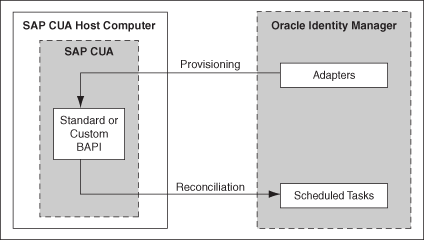

The adapters carry provisioning data submitted through the process form to the target system. Standards and custom BAPIs on the target system accept provisioning data from the adapters, carry out the required operation on the target system, and return the response to the adapters. The adapters return the response to Oracle Identity Manager.
This is the standard provisioning process. See Section 3.4, "Provisioning Operations Performed in an SoD-Enabled Environment" for detailed information about how provisioning takes places in an SoD-enabled environment.During reconciliation, the scheduled task establishes a connection with the target system and sends reconciliation criteria to the custom BAPIs.
You deploy these custom BAPIs on the target system as part of the connector deployment procedure.The custom BAPIs extracts SAP CUA Master system user records that match the reconciliation criteria and hand them over to the scheduled task, which brings the records to Oracle Identity Manager. Each record is compared with SAP CUA resources that are already provisioned to OIM Users. If a match is found, then the update made to the SAP CUA record from the target system is copied to the SAP CUA resource in Oracle Identity Manager. If no match is found between a record from the target system and an existing SAP CUA resource, then the user ID of the record is compared with the user ID of each OIM User. If a match is found, then data in the target system record is used to provision an SAP CUA resource to the OIM User.

Provisioning involves creating or modifying user data on the target system through Oracle Identity Manager.

Table 1-6 lists the supported user provisioning functions and the adapters that perform these functions. The functions listed in the table correspond to either a single or multiple process tasks.
