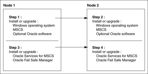

(The numbers in Figure 1-1 do not correspond to the numbered steps in the subsequent list because the list contains more detailed information than the figure.Figure 1-1 Recommended Order for Installing Software on a Two-Node Cluster
The following list provides more detail about the installation order and other tasks to help you get started with Oracle Fail Safe:

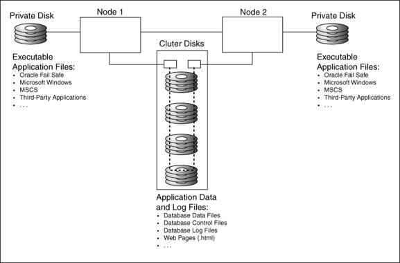

Figure 1-2 lists the software and the files that should be installed on private disks and shared-nothing cluster disks.
Figure 1-2 Software Installed on Private, Shared-Nothing Cluster Disks
