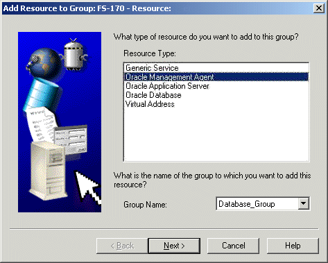

Use Oracle Fail Safe Manager to add the new Oracle Management Agent to the Fail Safe group that contains the databases it will monitor. You must add Oracle Management Agent to the group as a generic service. Follow these steps:
From the Resources menu, click Add to Group. The Add Resource to Group Wizard opens.
Figure 9-1 Add Resource to Group Wizard - Resource Page
In the Resource Type box, select Oracle Management Agent.
In the Group Name box, select the group to which you want to add Oracle Management Agent. This must be the group that contains the database you want to monitor with Oracle Management Agent.
Click Next. The Management Agent Oracle Home page opens.
