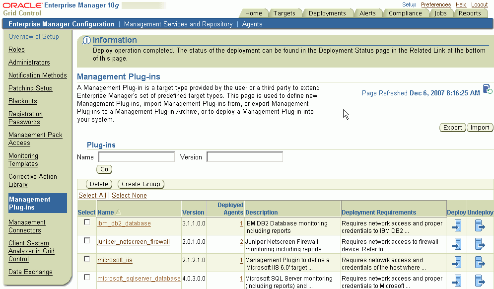

Download the SQL Server Plug-in archive to your desktop or computer on which the browser is launched. You can download the archive from the Oracle Technology Network (OTN).
Log into Enterprise Manager Grid Control as a Super Administrator.
Click the Setup link in the upper right corner of the Grid Control Home page, then click the Management Plug-ins link on the left side of the Setup page.
Click Import.
Click Browse and select the plug-in archive.
Click List Archive.
Select the plug-in and click OK.
Verify that you have set preferred credentials on all Agents where you want to deploy the plug-in.
In the Management Plug-ins page, click the icon in the Deploy column for the SQL Server plug-in. The Deploy Management Plug-in wizard appears.
Click Add Agents, then select one or more Agents to which you want to deploy the plug-in. The wizard reappears and displays the Agent you selected.
Click Next, then click Finish.
If you see an error message stating that the preferred credential is not set up, go to the Preferences page and add the preferred credentials for the Agent target type.
If there are no errors, then you will see the following screen:
To check the deployment status, go to Related Links and click the link Deployment Status.

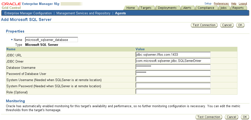

Follow these steps to add the plug-in target to Grid Control for central monitoring and management:
From the Agent home page where the plug-in was deployed, select the Microsoft SQL Server target type from the Add drop-down list, then click Go. The Add Microsoft SQL Server page appears.
If you are performing a local monitoring of SQL Server Cluster, then the Agent home page will be the Virtual Agent Service home page.Provide the following information for the properties:
Name — Unique target name across all the Grid Control targets, such as SqlServer2k_Hostname. This is the display name in the Grid Control. It represents this SQL Server target across all user interfaces within Grid Control.
JDBC URL — URL for JDBC.
For example,
jdbc:sqlserver://<host>:<port>
You can specify either IP Address or host name. However, ensure that the host name can be resolved consistently on the network. Standard TCP tools such as "nslookup" and "traceroute" can be used to verify the host name. Also, if you are monitoring a Microsoft SQL Server Cluster, then specify the IP address or host name of the virtual host of the cluster.JDBC Driver — (Optional) SQL+Driver JDBC driver class name.
For example,
com.microsoft.sqlserver.jdbc.SQLServerDriver
Database Username — Valid user for the database in sysadmin fixed server role.
Password for the Database User — Corresponding password for the database user
System Username — Valid host user name. Required only for remote Agent monitoring. For more information, see "Configuring Remote Connections to Monitor Targets".
System Password — Password for the Username. Required only for remote Agent monitoring.
Role — (Optional)
For Oracle Management Service 10g Release 3 (10.2.0.3), if you do not reenter the encrypted parameters (Database Username, Password for the Database User, System Username, System Password) before clicking OK, you might encounter an error informing you that the login failed.Click Test Connection to make sure the parameters you entered are correct.
Reenter the encrypted parameters from step 2 if the connection test was successful, then click OK.
Important:
If you do not reenter the encrypted parameters before clicking OK, you might encounter an error suggesting that the login failed.After you deploy and configure the plug-in to monitor one or more targets in the environment, you can customize the monitoring settings of the plug-in. This alters the collection intervals and threshold settings of the metrics to meet the particular needs of your environment. If you decide to disable one or more metric collections, this could impact the reports that the metric is a part of.

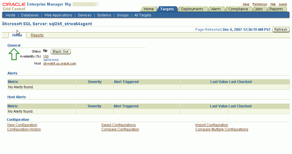

After waiting a few minutes for the plug-in to start collecting data, use the following steps to verify and validate that Enterprise Manager is properly monitoring the plug-in target:
Click the SQL Server target link from the Agent home page Monitored Targets table.
The Microsoft SQL Server home page appears.
Verify that no metric collection errors are reported in the Metrics table.
Ensure that reports can be seen and no errors are reported by clicking the Reports property page.
Ensure that configuration data can be seen by clicking the View Configuration link in the Configuration section. If configuration data does not immediately appear, click Refresh in the View Configuration page.
Remove blackout for the targets (required only if Step 9 applies).
Follow these steps to undeploy the plug-in from an Agent:
Log in to Enterprise Manager Grid Control as a Super Administrator.
Select the Targets tab, then the All Targets subtab. The All Targets page appears.
Select the Microsoft SQL Server Plug-in target and click Remove. You must do this step for all targets of the specific version of the plug-in.
Make sure that the preferred credentials are set on the Agents where the plug-in is deployed.
Click the Setup link in the upper right corner of the All Targets page, then click the Management Plug-ins link on the left side of the Setup page. The Management Plug-ins page appears.
Click the icon in the Undeploy column for the Microsoft SQL Server Plug-in. The Undeploy Management Plug-in page appears.
Check all the Agents that are currently deployed with the Microsoft SQL Server Plug-in and click OK.
You must undeploy the plug-in from every Agent in the system to completely remove it from the enterprise.
Select the Microsoft SQL Server Plug-in on the Management Plug-in page and click Delete.
