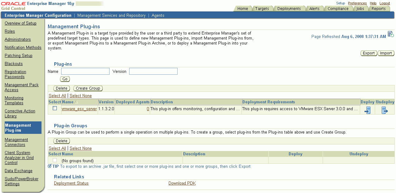

  1. Download the VMWare ESX Server Plug-in archive to your desktop or computer on which the browser is launched. You can download the archive from the Oracle Technology Network (OTN).
  2. Log on to Enterprise Manager Grid Control as a Super Administrator.
  3. Click the Setup link in the upper right corner of the Grid Control Home page, then click the Management Plug-ins link on the left side of the Setup page.
  4. Click Import.
  5. Click Browse and select the plug-in archive.
  6. Click List Archive.
  7. Select the plug-in and click OK.
  8. Verify that you have set preferred credentials on all Agents where you want to deploy the plug-in.
  9. In the Management Plug-ins page, click the icon in the Deploy column for the VMWare ESX Server plug-in. The Deploy Management Plug-in wizard appears.
  10. Click Add Agents, then select one or more Agents for which you want to deploy the plug-in. The wizard reappears and displays the Agent or Agents selected.
  11. Click Next, then click Finish.
    If you see an error message stating that the preferred credential is not set up, go to the Preferences page and add the preferred credentials for the Agent target type.
  12. If you are using HTTPS web service calls, you must copy the keystore file(s) to the location that you specify when adding target instances (this step must be completed before adding targets to these Agents).
    If there are no errors, you can see the following screen:

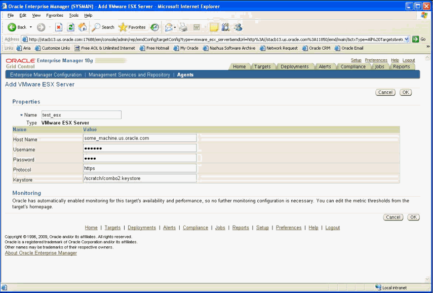

After successfully deploying the plug-in, follow these steps to add the plug-in target to Grid Control for central monitoring and management:
  1. From the Agent home page where the plug-in was deployed, select the VMware ESX Server target type from the Add drop-down list, then click Go. The Add VMware ESX Server page appears.
  2. Provide the following information for the properties:
    • Name — Name of the VMware ESX Server being monitored
    • Host Name — Fully qualified host name, including domain, of the ESX Server
    • Username — Name of the user with proper privileges for enabling the plug-in to access data through the embedded Web Service in the VMWare ESX Server
    • Password — Password for the specified Username
    • Protocol — Either HTTP or HTTPS can be specified. If HTTPS is specified, you must specify the Keystore parameter (with HTTP set, the Keystore parameter is left blank). However, due to an issue with the ESX Server, Oracle recommends using the HTTP protocol at this time. Refer to the section for more details.
    • Keystore — Either specify the full path and the file name to the keystore file, which contains the certificate for the VMware ESX Server (the agent must have access to this keystore file), or specify bypass to use the all-trusting Trust Manager as explained in Prerequisites.
  3. Click OK to add the target instance.
  4. To run EM jobs that stop, start and suspend VMs or set or exit ESX Server into/from maintenance mode, credentials must be supplied to the job. This can be accomplished either ahead of time by specifying the preferred credentials (both Agent Host Username/Password and Web Service Username/Password) in the Preferences section of EM or by specifying the same credentials when the job is actually submitted.
After you deploy and configure the plug-in to monitor one or more targets in the environment, you can customize the monitoring settings of the plug-in. This alters the collection intervals and threshold settings of the metrics to meet the particular needs of your environment. If you decide to disable one or more metric collections, this could impact the reports that the metric is part of.
Figure 2 Add VMWare ESX Server Page

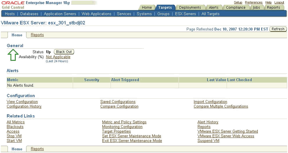

  1. Click the VMware ESX Server target link from the Agent home page Monitored Targets table. The VMware ESX Server home page appears.
    Figure 3 VMware ESX Server Home Page
    VMWare ESX Server Home Page
  2. Verify that no metric collection errors are reported in the Metrics table.
  3. Ensure that reports can be seen by selecting the Reports property page.
  4. Ensure that configuration data can be seen by clicking the View Configuration link in the Configuration section. If configuration data does not appear immediately, click Refresh in the View Configuration page.
