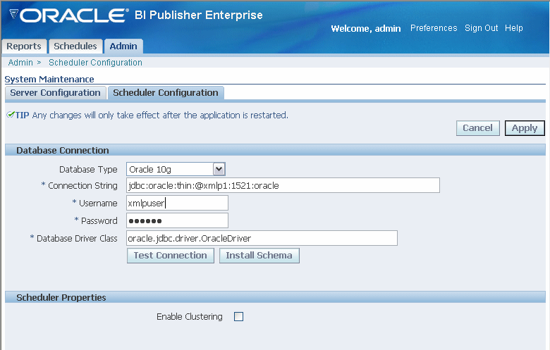

Set up the scheduler database for BI Publisher 10.1.3.2
Perform the steps for setting up the BI Publisher Scheduler in the Oracle Business Intelligence Infrastructure Installation and Configuration Guide, omitting the create user step. Use the same user and database that you used for XMLP 5.6.2.
The database information you used in XMLP 5.6.2 is stored in the xmlp-server-config.xml file that you backed up in the previous step. Note that this process does not overwrite the existing data because the table names are different in 10.1.3.2.

| Parameter in 5.6.2 Configuration File | Corresponding Field in 10.1.3.2 Scheduler Configuration Page | Value in the Sample Configuration File |
| url | Connection String | jdbc:oracle:thin:@xmlp1:1521:oracle |
| driver | Database Driver Class | oracle.jdbc.driver.OracleDriver |
| username | Username | xmlpuser |
| password | Password | xmlpuser |
The following figure shows a sample Scheduler Configuration page:

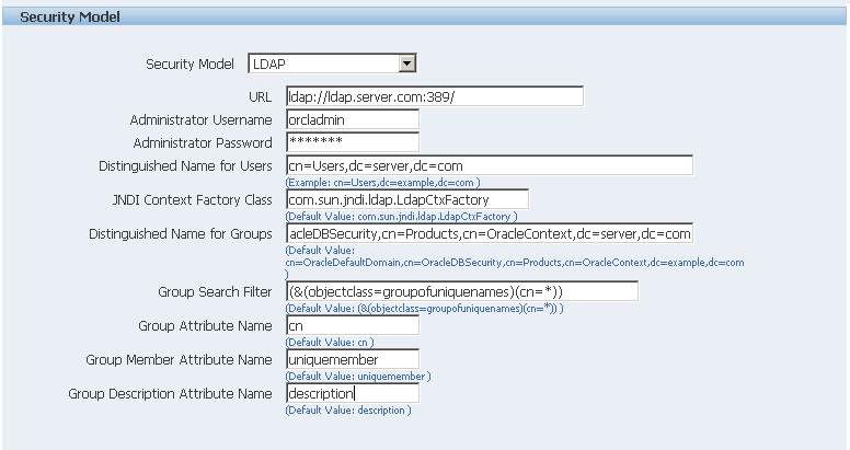

Migrate LDAP server settings.
If you have set up an LDAP server in 5.6.2, migrate the LDAP server configuration in 10.1.3.2 through the BI Publisher Admin interface.
Note: Open the 5.6.2 xmlp-server-config.xml and search for the LDAP server information. If the properties that start with "LDAP_" are commented out, you are not using an LDAP server and you can skip this step.
To migrate the LDAP settings:
Select the Admin tab.
Under Security Center, select Security Configuration.
Under Security Model, choose LDAP from the list.
Enter the LDAP server information based on the 5.6.2 xmlp-server-config.xml. See the following sample configuration file, mappings table, and Admin page sample for more detail.

| Parameter in the 5.6.2 Configuration File | Corresponding Field in the Admin Security Configuration Page | Value in the Sample Configuration File |
| LDAP_PROVIDER_URL | URL | ldap://ldap.server.com:389/ |
| LDAP_PROVIDER_ADMIN_USERNAME | Administrator Username | orcladmin |
| LDAP_PROVIDER_ADMIN_PASSWORD | Administrator Password | welcome |
| LDAP_PROVIDER_USER_DN | Distinguished Name for Users | cn=Users,dc=server,dc=com |
| LDAP_PROVIDER_FACTORY | JNDI Context Factory Class | com.sun.jndi.ldap.LdapCtxFactory |
| LDAP_PROVIDER_GROUP_SEARCH | Group Search Filter | (&(objectclass=groupofuniquenames)(cn=*)) |
| LDAP_PROVIDER_GROUP_SEARCH_ROOT | Distinguished Name for Groups | cn=OracleDefaultDomain,cn=OracleDBSecurity,cn=Products,cn=OracleContext,dc=server,dc=com |
| LDAP_PROVIDER_GROUP_ATTR_NAME | Group Attribute Name | cn |
| LDAP_PROVIDER_GROUP_ATTR_MEMBER | Group Member Attribute Name | uniquemember |
| LDAP_PROVIDER_GROUP_ATTR_DESCRIPTION | Group Description Attribute Name | description |
