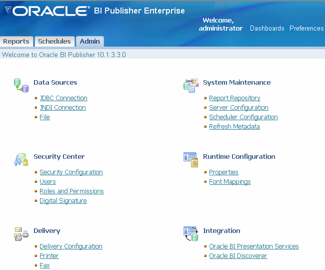

Select the Admin tab, and then from the Security Center menu select Digital Signature.
The following screenshot shows the new Digital Signature entry available from the Admin tab.

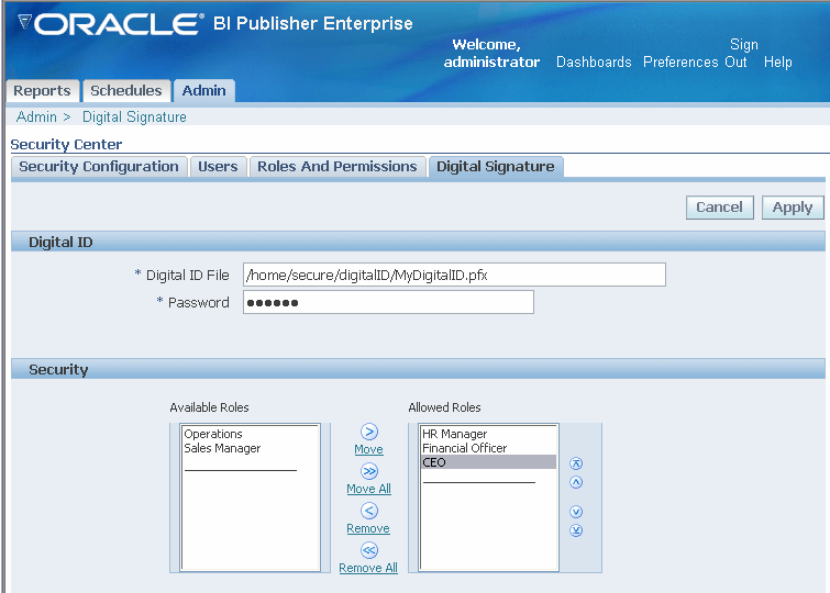

On the Digital Signature sub-tab, enter the file path to the digital ID file and enter the password for the digital ID.
Enable the Roles that will have the authority to sign documents with this digital ID. Use the shuttle buttons to move Available Roles to the Allowed Roles list.
Click Apply.
The following screenshot shows the Digital Signature sub-tab:

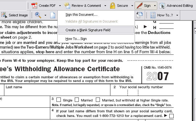

Select Sign from the toolbar and then select Create a Blank Signature Field. The following figure displays this selection from the Adobe Acrobat Professional toolbar.

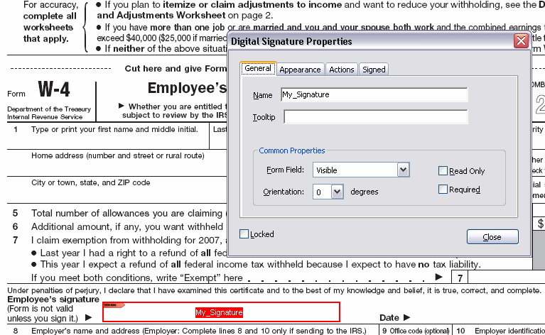

Draw the signature field in the desired location on the template. When you are finished drawing (that is, when you release the mouse button), the Digital Signature Properties dialog will display.
Assign a name to your signature field. The following figure shows an inserted digital signature field called "My_Signature."

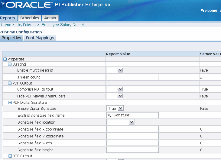

Select the Configure link for the report.
Scroll down to the PDF Digital Signature group of properties.
Set Enable Digital Signature to True.
Enter the field name from the PDF template for the property Existing signature field name.
The following screenshot shows the "My_Signature" field name entered into the properties field.

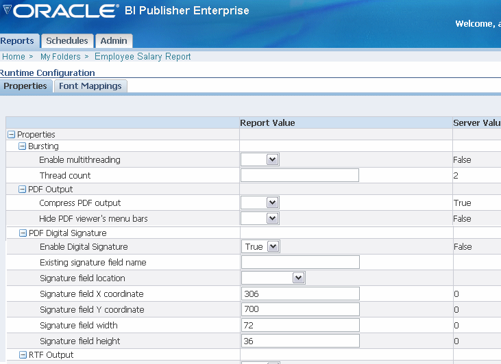

Specify the location in the document where you want the digital signature to appear by setting the appropriate properties as follows (note that the signature is inserted on the first page of the document only):
Existing signature field name – does not apply to this method.
Signature field location – provides a list containing the following values: Top Left, Top Center, Top Right. Choose one of these general locations and BI Publisher will insert the digital signature to the output document sized and positioned appropriately. If you set this property, do not enter X and Y coordinates or width and height properties.
Signature field X coordinate – using the left edge of the document as the zero point of the X axis, enter the position in points that you want the digital signature to be placed from the left. For example, if you want the digital signature to be placed horizontally in the middle of an 8.5 inch by 11 inch document (that is, 612 points in width and 792 points in height), enter 306.
Signature field Y coordinate – using the bottom edge of the document as the zero point of the Y axis, enter the position in points that you want the digital signature to be placed from the bottom. For example, if you want the digital signature to be placed vertically in the middle of an 8.5 inch by 11 inch document (that is, 612 points in width and 792 points in height), enter 396.
Signature field width – enter in points the desired width of the inserted digital signature field. This applies only if you are setting the X and Y coordinates.
Signature field height – enter in points the desired height of the inserted digital signature field. This applies only if you are setting the X and Y coordinates.
The following screenshot shows a report configured to place the digital signature at specific x and y coordinates in the document.
