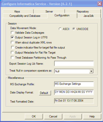

In the Configuration tab, set the Data Movement Mode.
Select the ASCII or UNICODE option.
If you select the UNICODE option, remove the check from the Validate Data Codepages check box, and check the Output Session Log in UTF8 check box.
Leave the default values in the remaining fields.
