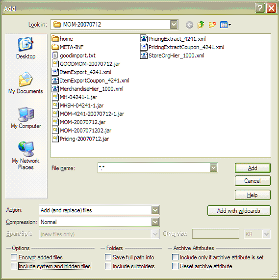

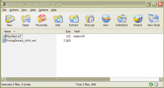

Figure 3-1 Adding Files To a Jar
WinZip can be used to create a bundle, inspect the bundle, as well as add, delete, or modify the XML contents. Care should be taken to use text editors that will not corrupt the contents, as often happens when using Notepad. Alternately, use the following jar command line utility (from a Java Standard Development Kit) to create a bundle:
C:\temp\dataimport\archive>%JAVA_HOME%\bin\jar -cvfm test_coupon3.jar manifest_details.txt PricingImportSample_addCouponDiscount.xml ItemImportSample_addCoupon.xml
In Figure 3-2, note that the Save full path info option at the bottom is not selected.
Figure 3-2 Adding Files To A WinZip Archive
The following is an example of a manifest file:
Manifest-Version: 1.0
# This manifest describes the contents of an archive referred to as a
# bundle. The following two values list the ID of the batch that
# produced this bundle and the ID of the destination store to receive
# it. The BatchID should be numeric less than 2^32-1.
BatchID: 1
StoreID: 04241
# The following section lists the files contained in this bundle archive.
# Each key should begin with "FileN" without quotes and N being a number.
# The value of the key consists of a bundle entry file name followed
# by hard brackets containing a list of files that should be processed
# before it.
# e.g. File1: ItemImport.xml[TaxImport.xml,StoreHierarchyImport.xml]
# The order of the files or their dependency list is not important.
File1: TaxImport.xml[]
File2: MerchandiseHierarchyImport.xml[]
File3: ItemImport.xml[TaxImport.xml,MerchandiseHierarchyImport.xml,StoreHierarchyImport.xml]
File4: ItemImport2.xml[ItemImport.xml]
File5: PriceImport.xml[ItemImport2.xml]
File6: StoreHierarchyImport.xml[]
File7: EmployeeImport.xml[StoreHierarchyImport.xml]
