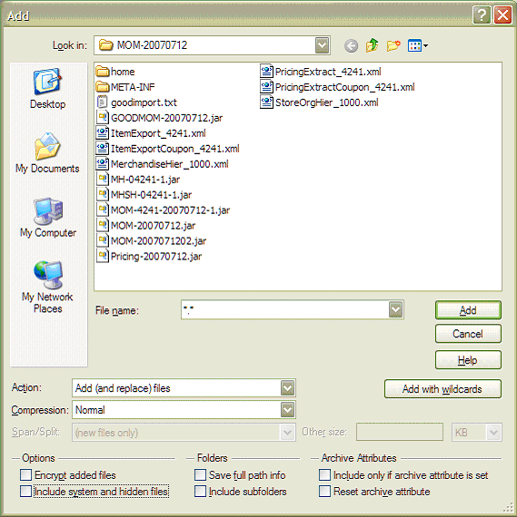

With the exception of manifest.mf, path names should not be used when creating the manifest. In Figure 3-1, note that the path column is empty except for meta-inf, the path for manifest.mf.
Note: WinZip can be used to create a bundle, inspect the bundle, as well as add, delete, or modify the XML contents. Care should be taken to use text editors that will not corrupt the contents, as often happens when using Notepad. Alternately, use the following jar command line utility (from a Java Standard Development Kit) to create a bundle:C:\temp\dataimport\archive>%JAVA_HOME%\bin\jar -cvfm test_coupon3.jar manifest_details.txt PricingImportSample_addCouponDiscount.xml ItemImportSample_addCoupon.xml |
In Figure 3-2, note that the Save full path info option at the bottom is not selected.
