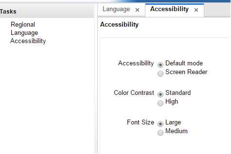

ReSA provide the ability to switch between the above accessibility support levels in the application, so that users can choose their desired type of accessibility support, if required. ReSA exposes a user preferences screen in which the user can specify the accessibility preferences/mode which will allow the user to operate in that mode.
Users can configure their session to the accessibility mode by setting user preferences on the home page of the ReSA application as shown below.

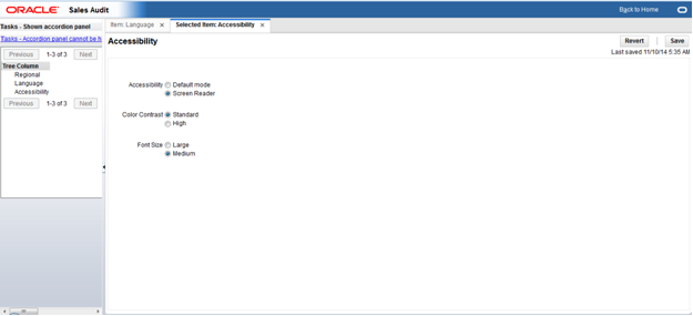

Perform the following procedure to configure a user preference for screen reader mode.
Log into the ReSA Portal.
From the ReSA application home page, select Preferences from the logged in user menu.
From the Tasks pane, click Accessibility to open the Accessibility tab.
Select Screen Reader to enable accessibility mode and click Save.
Click on Back to Home to return to the ReSA home page.
Now the application is enabled in the screen reader mode to assist a visibly challenged user. Some of the graphical content of Operational Insights is also displayed in a tabular mode.

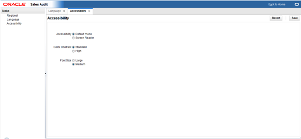

Perform the following procedure to set Accessibility mode to Default mode.
Select Default mode.
Click Save to save the settings.
Click Back to Home to return to the ReSA home page.
ReSA is returned to default mode and you can view graphical reports.
