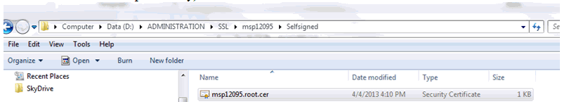

Perform the following steps to import the root certificates:
Backup cacert at <JRE_HOME>/lib/security/cacert.
Import the certificate using keytool utility as shown in the following example:
C:\Program Files\Java\jre7\lib\security>..\..\bin\keytool.exe -import -trustcacerts -file D:\ADMINISTRATION\SSL\apphost2\Selfsigned\apphost2.root.cer -alias apphost2 -keystore "C:\Program Files\Java\jre7\lib\security\cacerts" Enter keystore password: [default is changeit] Owner: CN=apphost2, OU=<department>, O=<company>,L=<city>,ST=<state or province>, C=<country>", Issuer: CN=apphost2, OU=<department>, O=<company>,L=<city>,ST=<state or province>, C=<country>" Serial number: 515d4bfb Valid from: Thu Apr 04 15:16:35 IST 2013 until: Fri Apr 04 15:16:35 IST 2014 Certificate fingerprints: MD5: AB:FA:18:2B:BC:FF:1B:67:E7:69:07:2B:DB:E4:C6:D9 SHA1: 2E:98:D4:4B:E0:E7:B6:73:55:4E:5A:BE:C1:9F:EA:9B:71:18:60:BB SHA256: F3:54:FB:67:80:10:BA:9C:3F:AB:48:0B:27:83:58:BB:3D:22:C5:27:7D: F4:D1:85:C4:4E:87:57:72:2B:6F:27 Signature algorithm name: SHA1withRSA Version: 3 Trust this certificate? [no]: (yes) Certificate was added to keystore C:\Program Files\Java\jre7\lib\security>
