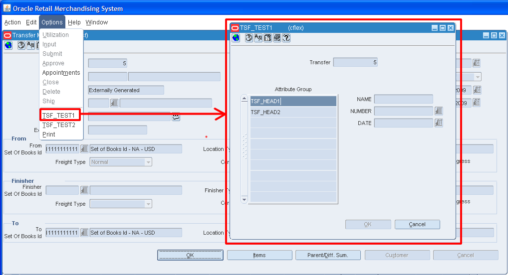

Example: Additional CFAS Attributes in the Transfer Maintenance Form
The following figure illustrates a CFAS user interface that can be accessed by clicking the TSF_TEST1 option from the Options menu of the Transfer Maintenance form:
In the illustration above,
The Transfer Maintenance form is an entity that has been extended to use the CFAS framework.
Additional attributes for the Transfer Maintenance form can be accessed using the TSF_TEST1 menu option from the Options menu.
In the TSF_TEST1 screen, the NAME, NUMBER, and DATE fields correspond to individual CFAS attributes.
These attributes belong to the TSF_HEAD1 attribute group. Each attribute group can include up to 22 such attributes including the header fields. For example, if the attribute group has 4 header fields, only 18 attributes can be under each attribute group.
TSF_HEAD1 and TSF_HEAD2 attribute groups belong to the TSF_TEST1 attribute group set. Attribute group sets appear as menu options in the Options menu and can include many attribute groups.
For more information on these attributes, see Planning Custom Flex Attributes.

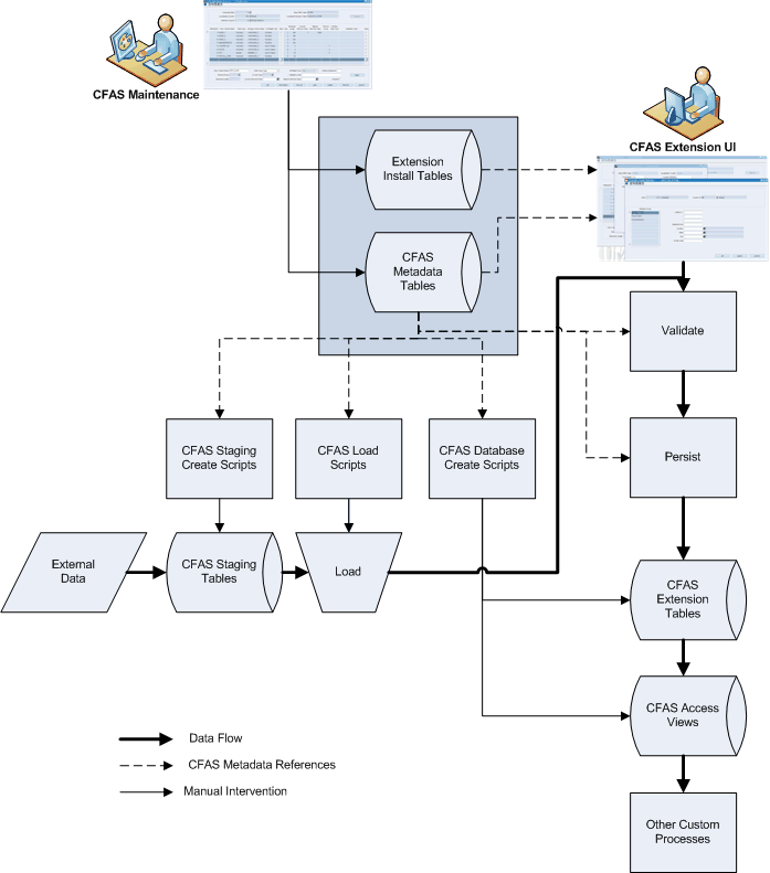

The following figure displays the data flow in a CFAS framework:
The Extension Installation Tables define the entities and tables that can be customized using the CFAS framework. By default, only certain entities are enabled for customization with initial entries already defined out of the box. Data can be added to these tables using a simple seed data script. In case you want to extend entities other than the ones already defined, you must use the CFAS Maintenance screens.
The CFAS Metadata Tables define the business extensions for your implementation. These tables are used to drive the CFAS Extension UI that will be available for end users and store the data entered. These tables are part of the base RMS data model and include information defined based on your implementation.
Note: The Extension Installation Objects and CFAS Metadata Tables are maintained using the CFAS Maintenance screens. |
The CFAS Extension UI is installed as an additional window on the relevant enabled form. This user interface is a reusable component that reads from the CFAS Metadata Tables to display the captured attribute data for the entity in an user-friendly way.
To ensure that the data in the user interface are accurate, the user interface automatically includes validation rules based on the type of attribute set up. As an end user enters relevant values in the fields on the CFAS Extension UI, the relevant validation rules defined in the CFAS Metadata Tables are called out. Validated data is then written to the CFAS Extension Storage Tables. You can choose to define a custom validation function and reference it when you set up an entity, attribute group set, attribute group, or attribute.
The CFAS Extension Storage Tables are used to store the data entered in the CFAS Extension UI or loaded from the metadata generated staging tables. These tables are created as part of the process of implementing the CFAS framework for an entity.
The CFAS Staging Tables enables you to import bulk data from external sources to the CFAS Extension Tables. These tables are created using scripts that function based on the metadata definitions.
The CFAS Load Script (cfastgload.ksh) can then be used to load the data from the CFAS Staging Tables to the CFAS Extension Tables. This script includes procedures that use the metadata definitions to properly insert data to the CFAS Extension Tables.
CFAS Access Views represent the information stored in the CFAS Extension Tables. These views enable you to easily access data or make the data available to custom processes. The views are generated by scripts. For more information, see CFAS Access Views.
Note: The CFAS Access Views and CFAS Staging Tables are automatically created when you run the CFAS Database Create Scripts (cfagen.ksh) after setting up the Extension Installation Objects and CFAS Metadata Tables. |
