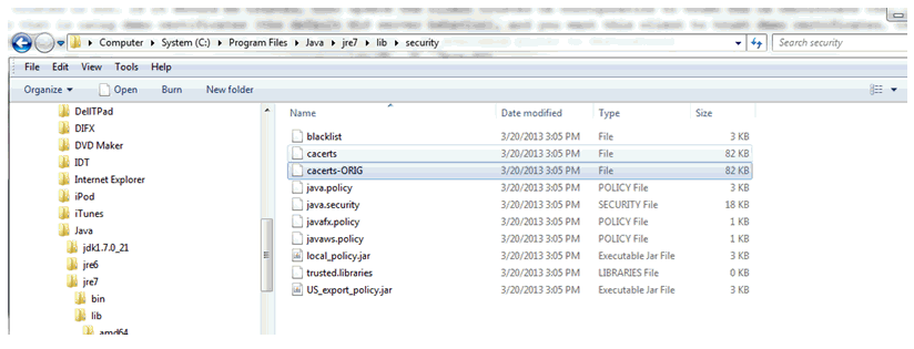

  1. Backup cacert at <JRE_HOME>/lib/security/cacert.
    Figure 5-1 Cacert Backup

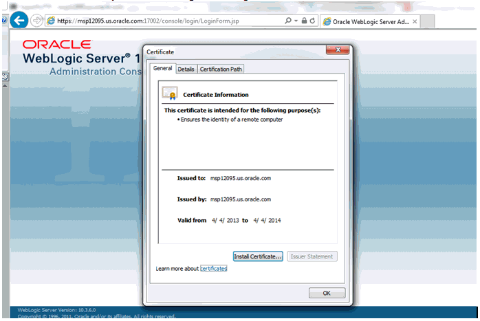

  1. Copy the Root Certificate file to the workstation.
  2. Rename the file to fa_root_cert.cer (this is a quick and easy way to associate the file with the Windows certificate import utility).
    Figure 5-2 Importing the Root Certificate File to the Workstation

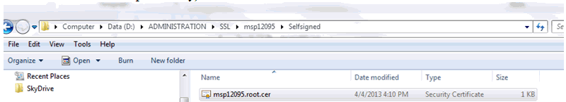

  4. In Certificate Manager, click the Authorities tab and then the Import button.
  5. In the Downloading Certificate dialog, choose Trust this CA to identify websites and click OK.
  6. Click OK in Certificate Manager.
  7. Open a browser and test the URL using the SSL port.
    Figure 5-3 Importing the Root Certificate File through Mozilla Firefox
