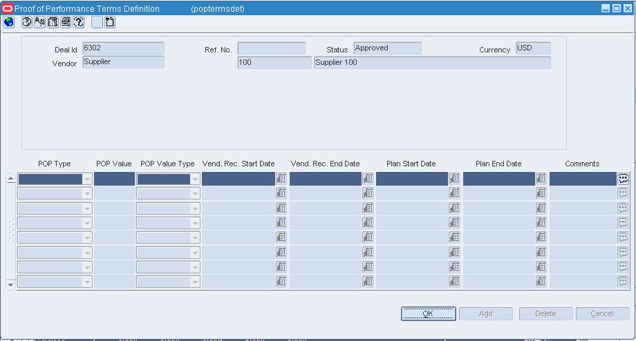

Additionally, you can define the proof of performance (POP) terms for a deal. POP terms are defined by the deal vendor that offers the deal. For deals, POP terms can be defined at the deal, deal/component or deal/component/item-loc combination. For fixed deals, the POP terms are defined at the deal level.

Edit Proof of Performance Definition
See "Edit Proof of Performance fulfillment Information" in the Purchasing chapter

View Proof of Performance Definitions
View Proof of Performance Fulfillment Information

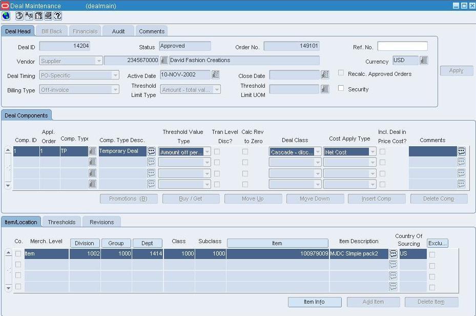

The Deal Maintenance window allows you to create, edit, and view deals with deal partners for items or items at specific locations. You can also create deals for items on a specific purchase order.
Items in a deal can exist at the department, class, or subclass level. Each item can also use up to four diffs to differentiate that item from a related higher level item. Deals can be created for any item that is at, or above, the transaction level.

The Proof of Performance window can be accessed from Options > Proof of Performance Terms > Deal, Deal Component, or Deal Component/Item Loc. Each of the three windows displays similar information regarding the proof of performance terms for the selected Deal ID. The Component/Item Loc menu option displays the additional fields: Merchandise Level, Department, Class, Subclass, and Org. Level, and District.
This window is divided into several tabs and sections where you enter or view information about each deal.
On the Deal Head tab, you enter the foundation information for the deal. You select the deal partner and the type of deal. You also enter when the deal starts and ends. For PO-specific deals, this information is filled in automatically.
The status of a deal changes as it passes through an approval process. Depending on your user role, you can change the status of a deal. The status can be Worksheet, Submitted, Approved, Rejected, or Closed. A deal is not effective until it is approved.
On the Bill Back tab, you enter the bill back information for the deal. You select how often to bill the supplier, and how the amount you receive is calculated.
On the Financials tab, you review and update the financial information for the deal. You can also indicate if deal income should be included in the stock ledger and if VAT should be included in the deal calculations.
The component type description can be added for deal component information as well as a defaulting contribution percentage. This contribution percentage will only be used as the default when the deal is attached to RPM and never be updated by RPM. This allows the user to add all relevant Vendor Funded Promotion information to the deal and yet allows for the flexibility to define it at a promotion component level.
Note: RMS is the custodian of the invoicing logic and will drive the invoicing functionality. |
On the Deal Components tab, you enter deal component information. Deal components are discounts or rebates included in the deal. When you enter deal component information, you determine the billing type, the collection dates, how the deal component is calculated, and the value of the discount or rebate from the deal partner. You can create multiple deal components in a single deal. You can also specify that a deal component is a transaction level discount that applies to entire purchase orders rather than individual items.
On the Item/Location tab, you select the items to which the deal components are applied. You can also specify specific locations for the items. Items and items at specific locations can also be excluded from deal component.
The item/location information is set up per component. This information is shared with RPM and the promotion setup is restricted in RPM based on the information that is pulled in from the component detail if a Vendor Funded Promotional deal is attached to a promotion.
On the Thresholds tab, you specify how much must be purchased or sold in order to receive a discount or rebate. You also indicate the value of the discount or rebate.
The Revisions tab tracks changes to the threshold limits, why the changes were made and when the changes are active for the deal.

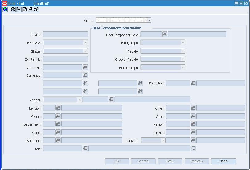

Navigate: From the main menu, select Ordering > Deals Management. The Deal Find window opens.
Search for and retrieve a deal in View mode. The Deal Maintenance window opens.
Select any of the enabled tabs to view additional information about a deal.
Click Close to close the window.

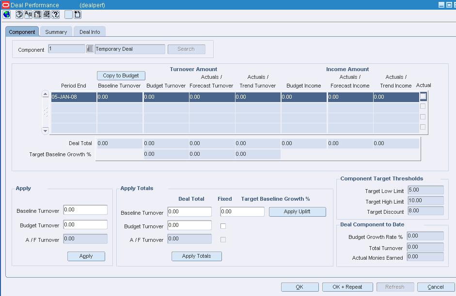

Search for and retrieve a promotional deal in View mode. The Deal Maintenance window opens.
Click Deal Income. The Deal Performance window opens.
To view the deal income by component, select the Component tab.
To view the deal income for the aggregate of the components, select the Summary tab.
To view the a summary of the deal information, select the Deal Info tab.

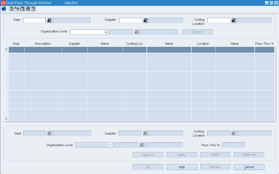

Navigate: From the main menu, select Ordering > Deal Pass Through > View. The Deal Pass Through window opens.
Enter a department, or click the LOV button and select the department.
Enter a supplier, or click the LOV button and select the supplier.
Enter a warehouse, or click the LOV button and select the warehouse.
Select an Organization Level.
Enter an appropriate item in the field, or click the LOV button and select the appropriate item.
Click Search. The items matching your criteria will populate the table.
Select an item from the table.
Click OK.

From the Options menu, select Proof of Performance Terms.
From the Proof of Performance Terms menu, select Deal, Deal Component, or Deal Component/Item Loc. The Proof of Performance Terms Definition window opens.
Note: If proof of performance information was created, but is not displayed at the deal level selected, you may have created the definition at a different deal level. |
Click OK to close the window.
Navigate: From the Main menu, select Ordering > Proof of Performance Fulfillment> View. The POP Terms Fulfillment window opens.
Select the level at which you want to search for proof of performance definitions. Options are: Deal, Deal Detail/Component, Deal Item/Location, Item, or Location.
Enter additional search criteria in the enabled fields.
Click Search to display deals with proof of performance definitions that match your criteria.
Select the definition that you would like to view.
If there is existing fulfillment information for that definition, it will be displayed in the Proof of Performance Fulfillment table.

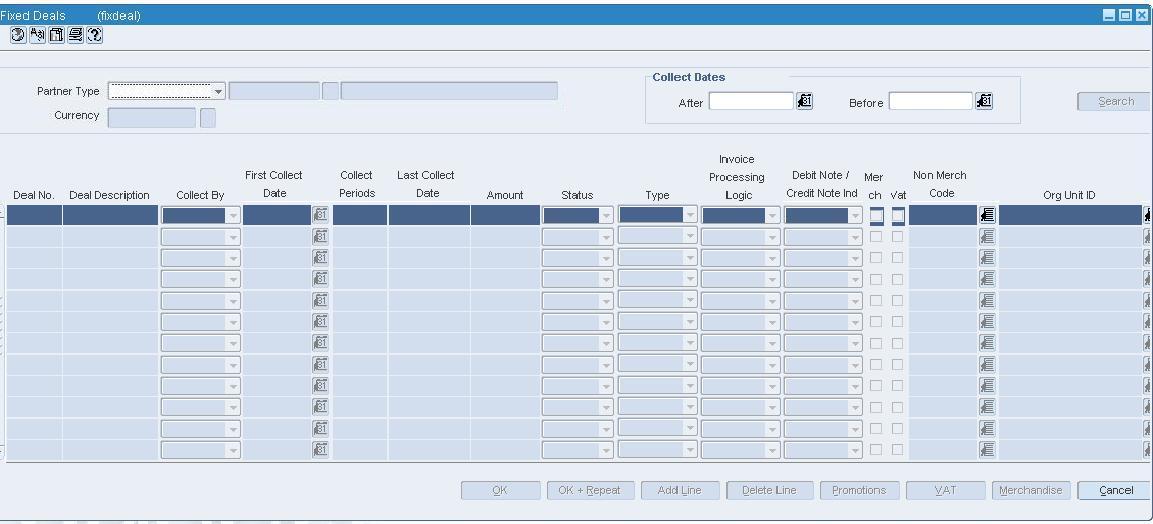

Navigate: From the main menu, select Ordering > Fixed Deals > View. The Fixed Deals window opens.
Enter the ID of the supplier, or click the LOV button and select the supplier.
To further restrict your search for a supplier, enter search criteria in the Collect Dates fields.
Click Search.

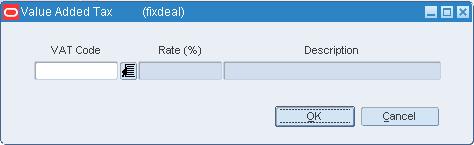

Click VAT to view associated VAT information for the deal. The Value Added Tax window opens.

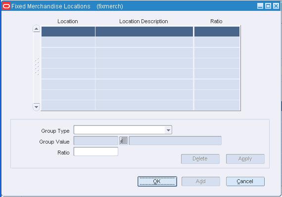

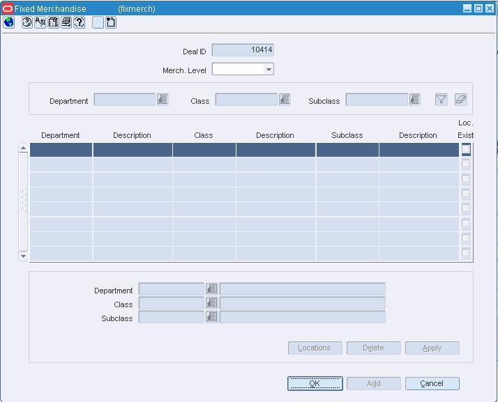

Click Merchandise to view associated item/location information for the deal. The Fixed Merchandise window opens.

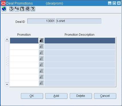

Click Promotions to view associated promotion information for the deal. The Deal Promotions window opens.
Click OK to close the windows.
In the Action field, select New.
Click OK. The Deal Maintenance window opens.
In the Vendor field, select the type of deal vendor.
Enter the ID of the deal vendor, or click the LOV button and select the deal vendor.
Search for and retrieve a deal in Edit mode. Restrict the search to deals in Worksheet or Submitted status. The Deal Maintenance window opens.
Click Delete Deal.
When prompted to delete the record, click Yes.
In the Action field, select either Edit or View.
Enter additional criteria as desired to make the search more restrictive.
Click Search. The Deal Find window displays the deals that match the search criteria.
Select a task:
To perform another search, click Refresh or Back.
To display the deal information, select a record and click OK. The Deal Maintenance window opens.

On the Deal Components Tab, click Insert Comp. The table is enabled.
In the Comp. field, enter the ID of the deal component, or click the LOV button and select the deal component.
In the Cost Apply Type field, select how the deal component is used to calculate future costs:
Note: The value in this field is defaulted based on the type of deal you selected, but can be changed. |
Net cost: Base cost of the item less off-invoice discounts.
Net net cost: Net cost of the item less bill-back amounts.
Dead net cost: Net net cost of the item less rebate amounts.
For an off-invoice deal, in the Deal Class field, select how the components are calculated in relation to each other.
Note: For a Bill Back, Vendor Funded Promotion, and Vendor Funded Markdown this field will default to Cascade and cannot be changed. |
Cumulative: The values of the deal components are added together and then applied to the total purchase amount to determine the discount or rebate.
Cascade: Each value of the deal components is applied to the total purchase amount minus the value of the previous deal component.
Exclusive: Exclusive deal components supersede any other deal components, and only one exclusive deal component can be applied to an item at any time. Exclusive deals at the highest level in the item hierarchy are applied instead.
In the Threshold Value field, select the what you get when the threshold is reached. If you selected Buy/Get Free or Disc Items, the Buy/Get Item/Location Threshold Information window opens.
Enter the appropriate information in each of the fields as appropriate.
After you complete both windows, click Finish.
On the Thresholds tab, click Add Thresh.
Enter the limits and value of the threshold.
Select the Target Lvl Ind of the threshold that your organization plans to meet.
or
From the main menu, select Ordering > Fixed Deals > Edit. The Fixed Deals window opens.
In the Supplier field, enter the ID of the supplier for which you want to edit a deal, or click the LOV button and select the supplier.
To further restrict your search for a supplier, enter search criteria in the Promotion No or Collect Dates field.
Click Search.
From the Options menu, select Proof of Performance Terms. The Proof of Performance Terms Definition window opens.
In the POP Type field, select what must be done to comply with the terms of the deal.
In the POP Value field, enter the monetary amount you receive by complying with the terms of the deal.
In the POP Value Type field, select the period of time that you have to comply to the terms of the deal.
In the Vend Rec Start Date field, enter the vendor's recommended start date, or click the LOV button and select a date.
In the Vend Rec End Date field, enter the vendor's recommended end date, or click the LOV button and select a date.
In the Plan Start Date field, enter the date you intend to start complying, or click the LOV button and select a date.
In the Plan End Date field, enter the date you intend to finish complying, or click the LOV button and select a date.
In the Comments field, enter any additional comments as necessary.
Click OK to save your changes and close the window.

The Deal Promotions window allows you to associate a fixed deal with a promotions. You can attach multiple promotions to a fixed deal. The promotion is set up in the pricing system and can then be attached to the fixed deal.
Add a Promotion to a Fixed Deal
The Value Added Tax window allows you to define the VAT rates for non-merchandise items on a fixed deal.
In the Apply Totals area, in the Baseline Turnover field, enter the previous year's turnover.
In the Apply Totals area, in the Budget Turnover field, enter the expected amount of turnover.
Click Apply Totals.
Note: You can click Copy Budget at any time to apply the baseline turnover totals to the Budget Turnover field. |
In the Target Baseline Growth % field, enter the percentage you expect the baseline to grow.
Click Apply Uplift. The Budget Turnover field is updated with the new totals.
When the budget turnovers are set, select the Fixed check box to the right of the Budget Turnover field.
Click OK to save any changes and close the window.
Select the period you want to update.
In the Apply area, in the Baseline Turnover field, enter the previous year's turnover.
In the Apply area, in the Budget Turnover field, enter the expected amount of turnover.
Click Apply.

This Deal Pass through window allows the user to set a pass-through percent value for each combination of department/supplier/warehouse/location. These values can be available to use to calculate a franchise store's acquisition cost.
Deal passthrough allow RMS to pass on a percentage of deal savings from one location to another. For example, if a client has a source warehouse (1000) and a WF store (2000) serviced by it, they could setup a deal passthrough of 50%. In this case if warehouse 1000 realized a deal value of $10 for an item the WF store would have $5 (.50 * $10) of the deal ”passed on” to it. The system takes the base cost for the source warehouse and subtracts the savings resulting from a deal passthrough.
Navigate: From the main menu, select Ordering > Deal Pass Through > Edit. The Deal Pass Through Window opens.
Enter Department or select from the list.
Enter Supplier or select from the list.
Enter Costing Location or select from the list.
Select an Organization Level from the list.
Enter an appropriate item in the field, or select from the list.
Click Search. The items matching your criteria will populate in the grid.
Enter a Department or select from the list.
Enter Pass-Through% to pass along to the customer location.
Click Apply.
Click OK.
The Deal Performance window allows you to enter forecasts for a deal, view period by period performance, and compare the actual deal performance against the actual results. The Deal Performance window is composed of three tabs:
Component tab: The Component tab allows you to enter the budgeted turnover expected for the deal component. The budgeted turnover is compared against the baseline turnover. The baseline turnover is the previous year's turnover. The baseline turnover can be entered manually if no information exists for a deal component.
As actuals are accrued, you can view the actual performance of the deal, at the component level, against the forecasted performance of the deal.
Summary tab: The Summary tab allows you to view the deal performance for the deal for all components on the deal. The periods displayed on the tab depends on the bill back periods that were selected during deal set up.
Deal Info tab: The Deal Info tab displays deal information, including a summary of deal performance to date.

This form is used to define proof of performance terms for a given deal, deal/deal component or deal/deal component/deal item-loc combination. These terms are defined by the deal partner that offers the deal. Access this window from the Options menu on the Deal Maintenance window.
Search for and retrieve a deal. The Deal Maintenance window opens.
or
Click Search.
Edit the enabled fields as necessary.
Use this form to record or view proof of performance term fulfillment for a deal at the following levels:
Deal
Deal/deal component
Deal Item/Location
Item
Location
Recording the fulfillment of these terms is a manual process and no fulfillment is calculated from other merchandising transactions.
An example: A supplier may define a proof of performance stating: "In order to qualify for the deal, the retailer needs to promote the item by displaying it on an end cap for 28 days." You may want to enter the start and end dates of the display period and/or promotion as a proof of performance fulfillment requirement.
The Fixed Deals window allows you to create, edit, or view fixed deals. With fixed deals, your organization receives payments from suppliers in return for mentioning their products in promotions or for displaying their products on prime shelf space. Fixed deal payments can be claimed from the supplier either periodically or all at once.
You can create fixed deals and set up a collection schedule, from which you can make claims against the supplier and receive payments.
To create a fixed deal, you must first specify a supplier and then search for all fixed deals for that supplier. Then you can edit existing fixed deals or add a new fixed deal.
Fixed deals are typically created in Active status; however, you can create a fixed deal in Inactive status. Inactive status holds the claim in merchandising.
The Fixed Deal Report provides you with information about active claims. Claim information for inactive fixed deals is not included in the report.
Navigate: From the main menu, select Ordering > Fixed Deals > Edit. The Fixed Deals window opens.
In the Partner Type field, select the type of vendor for which you are creating the fixed deal. Enter the ID of the supplier for which you want to create a deal, or click the LOV button and select the vendor.
Click Search. The Deal No field is filled in automatically with a unique ID for the fixed deal.
In the Deal Description field, enter a description of the deal.
In the Collect By field, select how often payment for the fixed deal is collected from the supplier.
In the First Collect field, enter the date, or click the calendar button and select the date.
In the Collect Period field, enter the number of collection periods.
Note: If you select Date in the Collect By field, the number of collection periods is always one. |
In the Amount field, enter the payment amount from the supplier.
In the Status field, select the status of the deal.
In the Invoice Processing Logic field, select how invoices are created for the fixed deal.
If the deal is associated to the merchandise hierarchy, select the Merch check box. The Fixed Merchandise window opens.
In the Merch Level field, select the merchandise level that the deal information is held at.
In the Apply area, enter the ID of the department, class and subclass in the appropriate fields, or click the LOV button and select the department, class, and subclass.
Click Apply. The merchandise level is added to the table.
Click Locations. The Fixed Merchandise Locations window opens.
In the Group Type field, select the location type you want to add to the deal.
In the Group Value field, enter the ID of the location group or click the LOV button and select the group.
In the Ratio field, indicate what percentage of the deal the location contributes.
Click Apply. The location and ratio is added to the table.

If VAT is included in the deal, select the VAT check box.
Click VAT. The Value Added Tax window opens.
In the VAT Code field, enter the VAT code to apply to the fixed deal, or click the LOV button and select a VAT code.
Click Search.
Edit the fields in the table as necessary.
Click VAT to update Value Added Tax information for the deal. The Value Added Tax window opens.
Click Merchandise to update the item/location information for the deal. The Fixed Merchandise window opens.

Click Promotions. The Deal Promotions window opens.
In the Promotion field, enter the promotion ID, or click the LOV button and select a promotion.
Click Add. The next line is enabled.
The Fixed Merchandise window allows you to define which items are associated to the a fixed by merchandise hierarchy.
The Fixed Merchandise Locations window allows you to indicate at which locations the deal is effective.

When a deal is added to the system, it must go through a series of checks before it is accessible in the system. Depending on your user role, you may not be able to move the deal to the next status. A deal may be in any of the following statuses:
Table 7-1 Deals Approval Process Status
| Status | Definition |
Worksheet |
The deal has been started, but not completed. |
Submitted |
The deal has been completed and is pending review. |
Approved |
The deal has been reviewed and has been approved. |
Rejected |
The deal has been submitted, reviewed, and has been rejected. |
Closed |
The deal is complete. |
Search for and retrieve a deal in Edit mode. Restrict the search to deals in Worksheet status. The Deal Maintenance window opens.
From the Options menu, select Submit. The Status field changes to Submitted.
Click Close to exit. You are prompted to save the changes.
Click Yes.
Search for and retrieve a deal in Edit mode. Restrict the search to deals in Submitted status. The Deal Maintenance window opens.
From the Option menu, select Approve. The Status field changes to Approved.
When prompted to save the changes, click Yes.
Search for and retrieve a deal in Edit mode. Restrict the search to annual deals. The Deal Maintenance window opens.
From the Option menu, select Close. The Status field changes to Closed.
From the Options menu, select Reject. The Status field changes to Rejected.
Click Yes.
