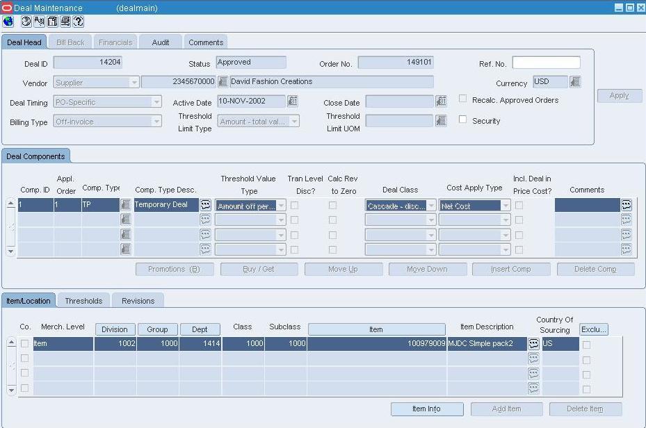

Deal Maintenance Window [dealmain]
The Deal Maintenance window allows you to create, edit, and view deals with deal partners for items or items at specific locations. You can also create deals for items on a specific purchase order.
Items in a deal can exist at the department, class, or subclass level. Each item can also use up to four diffs to differentiate that item from a related higher level item. Deals can be created for any item that is at, or above, the transaction level.
The EDI Deal Upload process can be used to create off invoice deals through a batch upload. Deals that are entered into RMS through the EDI batch upload must be manually approved before they can be used. Bill back deals must be manually entered.
Off invoice deals are applied when purchase orders with the items on a deal are approved. If a manual cost is entered for the item on the purchase order, deals are not applied to the item unless you request an override of manual costs. Deals that cause the unit cost of an item to be below zero are not applied.
All purchases-based bill back deals will generate income on the net cost of the purchase order, after the off invoice deals have been applied.

Deal Components Tab
On the Deal Components tab, you enter deal component information. Deal components are discounts or rebates included in the deal. When you enter deal component information, you determine the billing type, the collection dates, how the deal component is calculated, and the value of the discount or rebate from the deal partner. You can create multiple deal components in a single deal. You can also specify that a deal component is a transaction level discount that applies to entire purchase orders rather than individual items.
Deal Detail Area
Item/Location Tab
On the Item/Location tab, you select the items to which the deal components are applied. You can also specify specific locations for the items. Items and items at specific locations can also be excluded from deal component.
The item/location information is set up per component. This information is shared with RPM and the promotion setup is restricted in RPM based on the information that is pulled in from the component detail if a Vendor Funded Promotional deal is attached to a promotion.

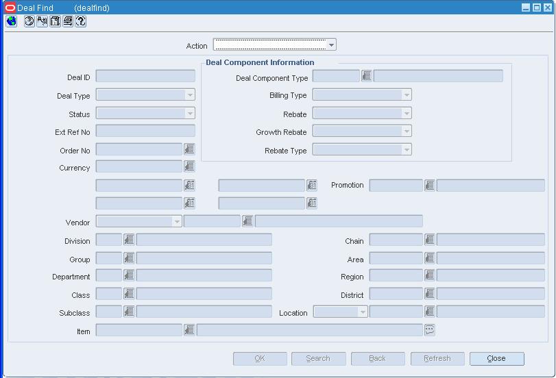

View a Deal
Navigate: From the main menu, select Ordering > Deals Management. The Deal Find window opens.
Search for and retrieve a deal in View mode. The Deal Maintenance window opens.
  1. Select any of the enabled tabs to view additional information about a deal.
  2. Click Close to close the window.

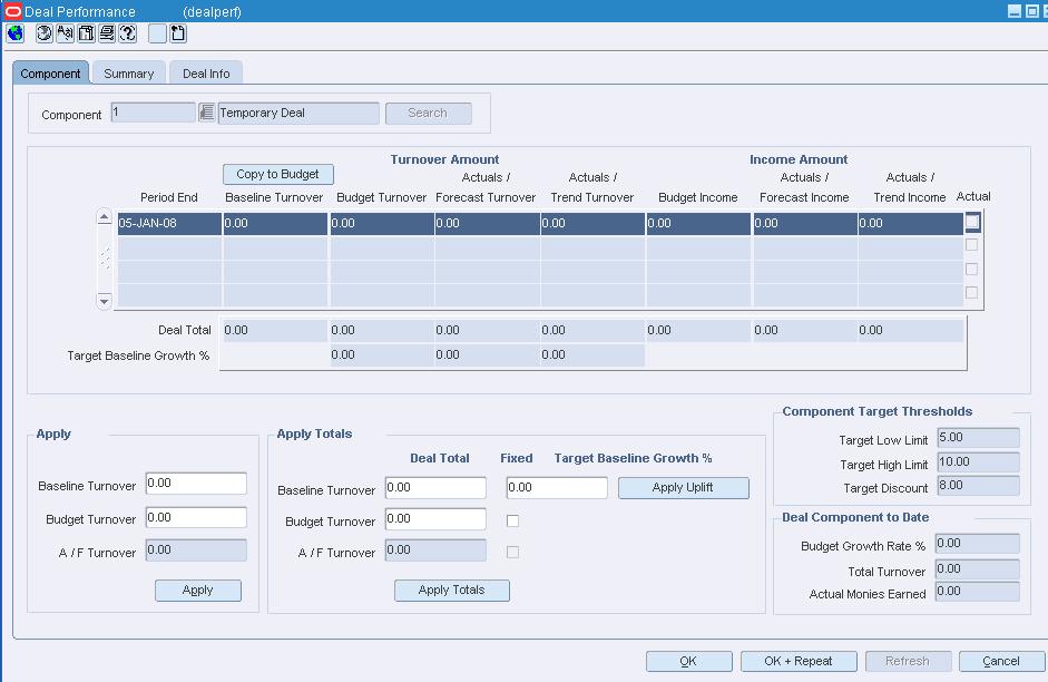

View Expected Deal Income
Search for and retrieve a promotional deal in View mode. The Deal Maintenance window opens.
  1. Click Deal Income. The Deal Performance window opens.
  2. To view the deal income by component, select the Component tab.
  3. To view the deal income for the aggregate of the components, select the Summary tab.
  4. To view the a summary of the deal information, select the Deal Info tab.
  5. Click Close to close the window.

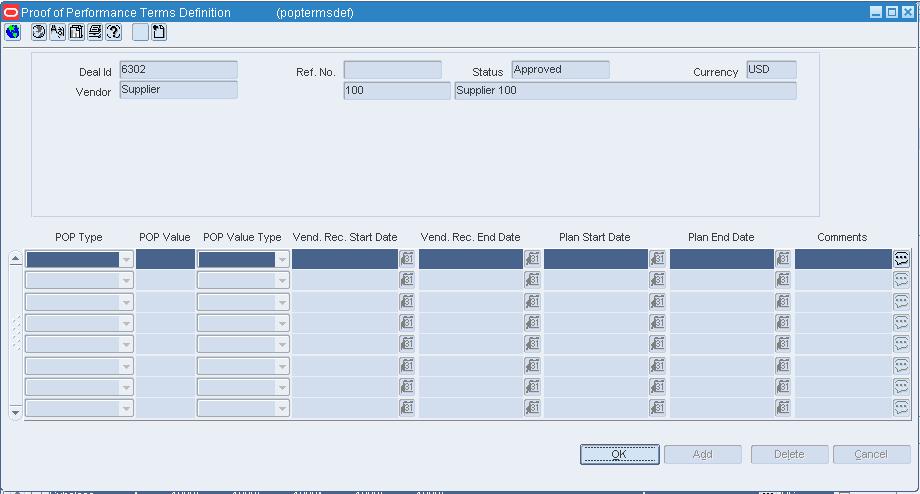

View Proof of Performance Definitions
Search for and retrieve a deal. The Deal Maintenance window opens.
or
From the main menu, select Ordering > Fixed Deals > Edit. The Fixed Deals window opens.
In the Supplier field, enter the ID of the supplier for which you want to edit a deal, or click the LOV button and select the supplier.
To further restrict your search for a supplier, enter search criteria in the Promotion No or Collect Dates field.
Click Search.
  1. From the Options menu, select Proof of Performance Terms.
  2. From the Proof of Performance Terms menu, select Deal, Deal Component, or Deal Component/Item Loc. The Proof of Performance Terms Definition window opens.
    If proof of performance information was created, but is not displayed at the deal level selected, you may have created the definition at a different deal level.
  3. Click OK to close the window.

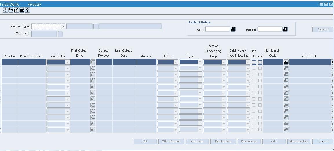

View a Fixed Deal
Navigate: From the main menu, select Ordering > Fixed Deals > View. The Fixed Deals window opens.
  1. Enter the ID of the supplier, or click the LOV button and select the supplier.
  2. To further restrict your search for a supplier, enter search criteria in the Collect Dates fields.
  3. Click Search.

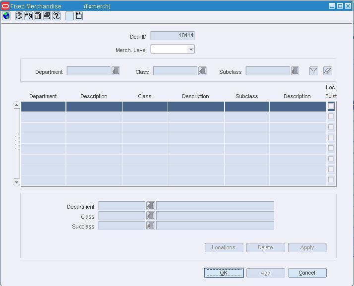

  4. Click VAT to view associated VAT information for the deal. The Value Added Tax window opens.
  5. Click Merchandise to view associated item/location information for the deal. The Fixed Merchandise window opens.

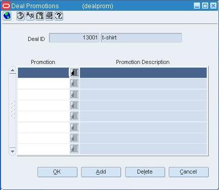

  6. Click Promotions to view associated promotion information for the deal. The Deal Promotions window opens.
  7. Click OK to close the windows.
Figure 7-1 Deal Find Window
Surrounding text describes Figure 7-1 .
  1. In the Action field, select New.
  2. Click OK. The Deal Maintenance window opens.
Figure 7-4 Deal Find Window
Surrounding text describes Figure 7-4 .
  1. In the Action field, select either Edit or View.
  2. Enter additional criteria as desired to make the search more restrictive.
  3. Click Search. The Deal Find window displays the deals that match the search criteria.

Add Deal Components
Search for and retrieve a deal in Edit mode. Restrict the search to deals in Worksheet status. The Deal Maintenance window opens.
Figure 7-6 Deal Maintenance Window
Surrounding text describes Figure 7-6 .
  1. On the Deal Components Tab, click Insert Comp. The table is enabled.
  2. In the Comp. field, enter the ID of the deal component, or click the LOV button and select the deal component.
  3. In the Cost Apply Type field, select how the deal component is used to calculate future costs:
    The value in this field is defaulted based on the type of deal you selected, but can be changed.
    • Net cost: Base cost of the item less off-invoice discounts.
    • Net net cost: Net cost of the item less bill-back amounts.
    • Dead net cost: Net net cost of the item less rebate amounts.
  4. For an off-invoice deal, in the Deal Class field, select how the components are calculated in relation to each other.
    For a Bill Back, Vendor Funded Promotion, and Vendor Funded Markdown this field will default to Cascade and cannot be changed.
    • Cumulative: The values of the deal components are added together and then applied to the total purchase amount to determine the discount or rebate.
    • Cascade: Each value of the deal components is applied to the total purchase amount minus the value of the previous deal component.
    • Exclusive: Exclusive deal components supersede any other deal components, and only one exclusive deal component can be applied to an item at any time. Exclusive deals at the highest level in the item hierarchy are applied instead.
  5. In the Threshold Value field, select the what you get when the threshold is reached. If you selected Buy/Get Free or Disc Items, the Buy/Get Item/Location Threshold Information window opens.
    1. Enter the appropriate information in each of the fields as appropriate.
    2. After you complete both windows, click Finish.
  6. On the Thresholds tab, click Add Thresh.
    1. Enter the limits and value of the threshold.
    2. Select the Target Lvl Ind of the threshold that your organization plans to meet.

From the Options menu, select Proof of Performance Terms. The Proof of Performance Terms Definition window opens.
Figure 7-14 Proof of Performance Terms Definition Window
Surrounding text describes Figure 7-14 .
  1. In the POP Type field, select what must be done to comply with the terms of the deal.
  2. In the POP Value field, enter the monetary amount you receive by complying with the terms of the deal.
  3. In the POP Value Type field, select the period of time that you have to comply to the terms of the deal.
  4. In the Vend Rec Start Date field, enter the vendor's recommended start date, or click the LOV button and select a date.
  5. In the Vend Rec End Date field, enter the vendor's recommended end date, or click the LOV button and select a date.
  6. In the Plan Start Date field, enter the date you intend to start complying, or click the LOV button and select a date.
  7. In the Plan End Date field, enter the date you intend to finish complying, or click the LOV button and select a date.
  8. In the Comments field, enter any additional comments as necessary.
  9. Click OK to save your changes and close the window.

Figure 7-16 Deal Maintenance Window
Surrounding text describes Figure 7-16 .
  1. On the Deal Head tab, in the Threshold Limit Type field, select how the threshold is defined.
  2. Add deal components.
  3. Add item/locations to a deal.
  4. Add threshold information.
  5. Click Close to exit.
  6. When prompted to save the changes, click Yes.

Define Expected Deal Income
Figure 7-17 Deal Find Window
Surrounding text describes Figure 7-17 .
  1. Create a deal.
    You can define deal income only for bill back and rebate deals.
  2. Click Deal Income. The Deal Performance window opens.
    Figure 7-18 Deal Performance Window
    Surrounding text describes Figure 7-18 .
Apply Total Turnover Amount to All Periods on a Deal
  1. In the Apply Totals area, in the Baseline Turnover field, enter the previous year's turnover.
  2. In the Apply Totals area, in the Budget Turnover field, enter the expected amount of turnover.
  3. Click Apply Totals.
    You can click Copy Budget at any time to apply the baseline turnover totals to the Budget Turnover field.
  4. In the Target Baseline Growth % field, enter the percentage you expect the baseline to grow.
  5. Click Apply Uplift. The Budget Turnover field is updated with the new totals.
  6. When the budget turnovers are set, select the Fixed check box to the right of the Budget Turnover field.
  7. Click OK to save any changes and close the window.
Apply Turnover Amount to Individual Periods
  1. Select the period you want to update.
  2. In the Apply area, in the Baseline Turnover field, enter the previous year's turnover.
  3. In the Apply area, in the Budget Turnover field, enter the expected amount of turnover.
  4. Click Apply.
  5. Click OK to save any changes and close the window.
Deal Find Window [dealfind]
The Deal Find window allows you to enter criteria in order to search for deals and view the results of the search.
The default view for the Deal Find window opens when you open the window for the first time. You can also create a custom view.
Search for a Deal

Deal Performance Window [dealperf]
The Deal Performance window allows you to enter forecasts for a deal, view period by period performance, and compare the actual deal performance against the actual results. The Deal Performance window is composed of three tabs:
  • Component tab: The Component tab allows you to enter the budgeted turnover expected for the deal component. The budgeted turnover is compared against the baseline turnover. The baseline turnover is the previous year's turnover. The baseline turnover can be entered manually if no information exists for a deal component.
    As actuals are accrued, you can view the actual performance of the deal, at the component level, against the forecasted performance of the deal.
  • Summary tab: The Summary tab allows you to view the deal performance for the deal for all components on the deal. The periods displayed on the tab depends on the bill back periods that were selected during deal set up.
  • Deal Info tab: The Deal Info tab displays deal information, including a summary of deal performance to date.
More information can be found in these related topics:

Figure 7-22 Proof of Performance Terms Definition Window
Surrounding text describes Figure 7-22 .
Edit Proof of Performance Definition
  1. Edit the enabled fields as necessary.
  2. Click OK to save any changes and close the window.
Delete Proof of Performance Definition
  1. Select the proof of performance definition you want to delete.
  2. Click Delete. You are prompted to confirm the deletion.
  3. Click Yes.
  4. Click OK to save any changes and close the window.

Fixed Deals Window [fixdeal]
The Fixed Deals window allows you to create, edit, or view fixed deals. With fixed deals, your organization receives payments from suppliers in return for mentioning their products in promotions or for displaying their products on prime shelf space. Fixed deal payments can be claimed from the supplier either periodically or all at once.
You can create fixed deals and set up a collection schedule, from which you can make claims against the supplier and receive payments.
To create a fixed deal, you must first specify a supplier and then search for all fixed deals for that supplier. Then you can edit existing fixed deals or add a new fixed deal.
Fixed deals are typically created in Active status; however, you can create a fixed deal in Inactive status. Inactive status holds the claim in merchandising.
The Fixed Deal Report provides you with information about active claims. Claim information for inactive fixed deals is not included in the report.
Create a Fixed Deal
Edit a Fixed Deal
View a Fixed Deal
Create a Fixed Deal
Navigate: From the main menu, select Ordering > Fixed Deals > Edit. The Fixed Deals window opens.
Figure 7-23 Fixed Deals Window
Surrounding text describes Figure 7-23 .
  1. In the Partner Type field, select the type of vendor for which you are creating the fixed deal. Enter the ID of the supplier for which you want to create a deal, or click the LOV button and select the vendor.
  2. Click Search. The Deal No field is filled in automatically with a unique ID for the fixed deal.
  3. In the Deal Description field, enter a description of the deal.
  4. In the Collect By field, select how often payment for the fixed deal is collected from the supplier.
  5. In the First Collect field, enter the date, or click the calendar button and select the date.
  6. In the Collect Period field, enter the number of collection periods.
    If you select Date in the Collect By field, the number of collection periods is always one.
  7. In the Amount field, enter the payment amount from the supplier.
  8. In the Status field, select the status of the deal.
  9. In the Invoice Processing Logic field, select how invoices are created for the fixed deal.

    Figure 7-24 Fixed Merchandise Window
    Surrounding text describes Figure 7-24 .
    1. In the Merch Level field, select the merchandise level that the deal information is held at.
    2. In the Apply area, enter the ID of the department, class and subclass in the appropriate fields, or click the LOV button and select the department, class, and subclass.
    3. Click Apply. The merchandise level is added to the table.
    4. Click Locations. The Fixed Merchandise Locations window opens.

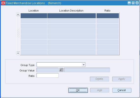

      Figure 7-25 Fixed Merchandise Locations Window
      Surrounding text describes Figure 7-25 .
    5. In the Group Type field, select the location type you want to add to the deal.
    6. In the Group Value field, enter the ID of the location group or click the LOV button and select the group.
    7. In the Ratio field, indicate what percentage of the deal the location contributes.
    8. Click Apply. The location and ratio is added to the table.
    9. Click OK to save any changes and close the window.
    10. Click OK to save any changes and close the window.

Maintain a Fixed Deal
Figure 7-27 Fixed Deals Window
Surrounding text describes Figure 7-27 .
  1. In the Supplier field, enter the ID of the supplier for which you want to edit a deal, or click the LOV button and select the supplier.
  2. To further restrict your search for a supplier, enter search criteria in the Promotion No or Collect Dates field.
  3. Click Search.
Edit a Fixed Deal
  1. Edit the fields in the table as necessary.
  2. Click VAT to update Value Added Tax information for the deal. The Value Added Tax window opens.
    Figure 7-28 Value Added Tax Window
    Surrounding text describes Figure 7-28 .
  3. Click Merchandise to update the item/location information for the deal. The Fixed Merchandise window opens.
    Figure 7-29 Fixed Merchandise Window
    Surrounding text describes Figure 7-29 .
  4. Click OK to save your changes and close the window.
Delete a Fixed Deal
  1. Select the fixed deal.
  2. Click Delete Line. You are prompted to confirm the deletion.
  3. Click OK.
Add a Promotion to a Fixed Deal
Navigate: From the main menu, select Ordering > Fixed Deals > Edit. The Fixed Deals window open.
Figure 7-30 Fixed Deals Window
Surrounding text describes Figure 7-30 .
  1. In the Partner Type field, select the type of vendor for which you are creating the fixed deal. Enter the ID of the supplier for which you want to create a deal, or click the LOV button and select the partner.
  3. Create a fixed deal, or select an existing deal.
  4. Click Promotions. The Deal Promotions window opens.
    Figure 7-31 Deal Promotions Window
    Surrounding text describes Figure 7-31 .
  5. In the Promotion field, enter the promotion ID, or click the LOV button and select a promotion.
  6. Click OK to save any changes and close the window.
Maintain Promotions for a Fixed Deal
Figure 7-32 Fixed Deals Window
Surrounding text describes Figure 7-32 .
  3. Select an existing deal.
    Figure 7-33 Deal Promotions Window
    Surrounding text describes Figure 7-33 .
  5. Click Add. The next line is enabled.
  6. In the Promotion field, enter the promotion ID, or click the LOV button and select a promotion.

Fixed Merchandise Window [fixmerch]
The Fixed Merchandise window allows you to define which items are associated to the a fixed by merchandise hierarchy.
Create a Fixed Deal
View a Fixed Deal
Fixed Merchandise Locations Window [fixmerch]
The Fixed Merchandise Locations window allows you to indicate at which locations the deal is effective.
Search for and retrieve a deal in Edit mode. Restrict the search to deals in Submitted status. The Deal Maintenance window opens.
Figure 7-37 Deal Maintenance Window
Surrounding text describes Figure 7-37 .
  1. From the Option menu, select Approve. The Status field changes to Approved.
  2. Click Close to exit.
  3. When prompted to save the changes, click Yes.
