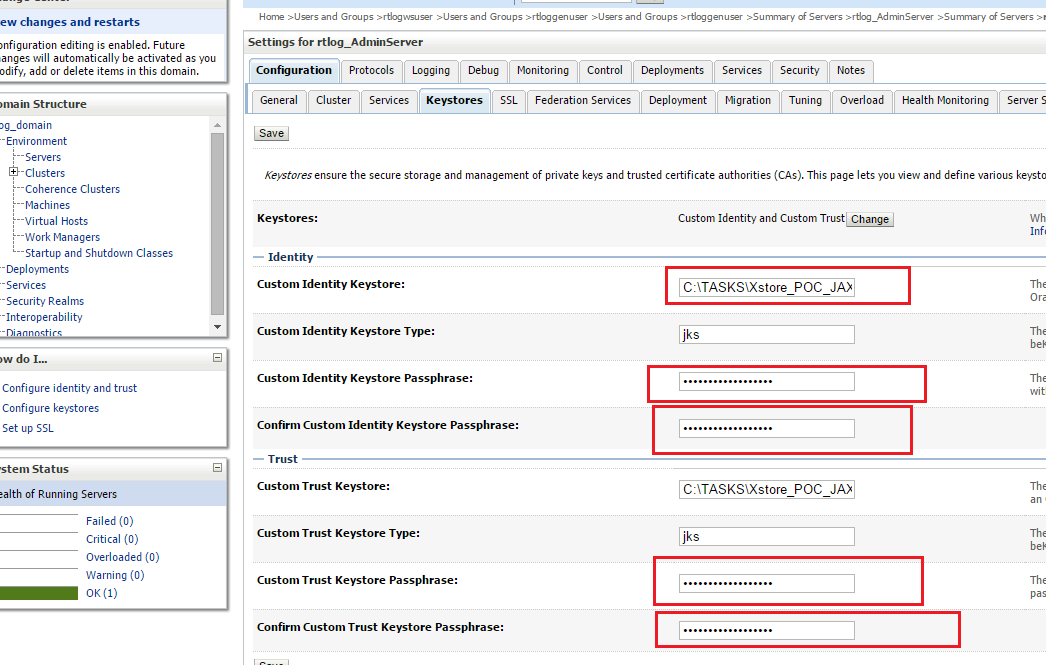

To set up the external configuration feature:
  1. Extract the configuration file's content into the C:\<rtlog-gen-config> directory if installing on Microsoft Windows or /usr/local/<rtlog-gen-config> on Linux OS. These directories are the default locations where the RTLog Generator application will look for the configuration files. These default locations can be overridden/changed by using one of the following ways:

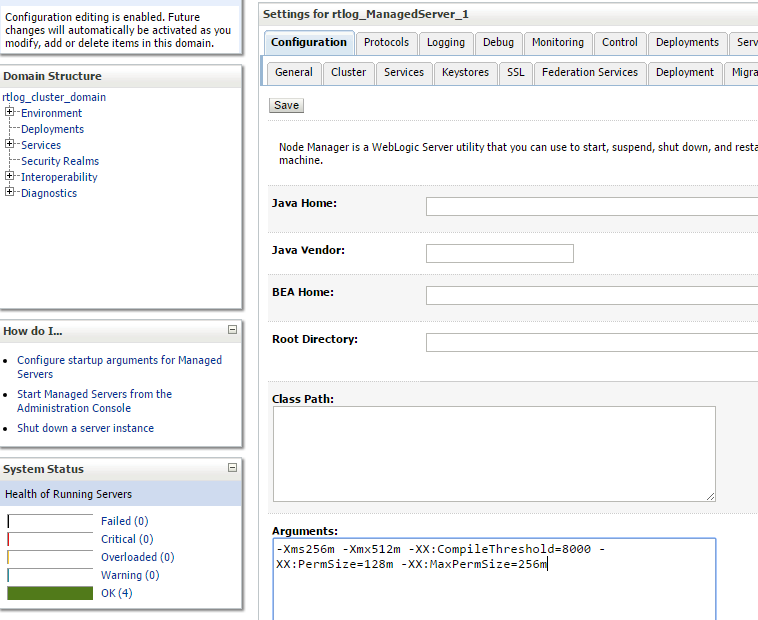

    • Pass a JVM argument to the server startup script and bounce the server:
      -Drtloggen.config.dir=C:/<custom_directory>/
      If the WebLogic domain is created with a Node manager, the same argument can be passed from the Administration Console in the Arguments field. See Figure 6-1.
      Figure 6-1 Administration Console Configuration Page
      Surrounding text describes Figure 6-1 .

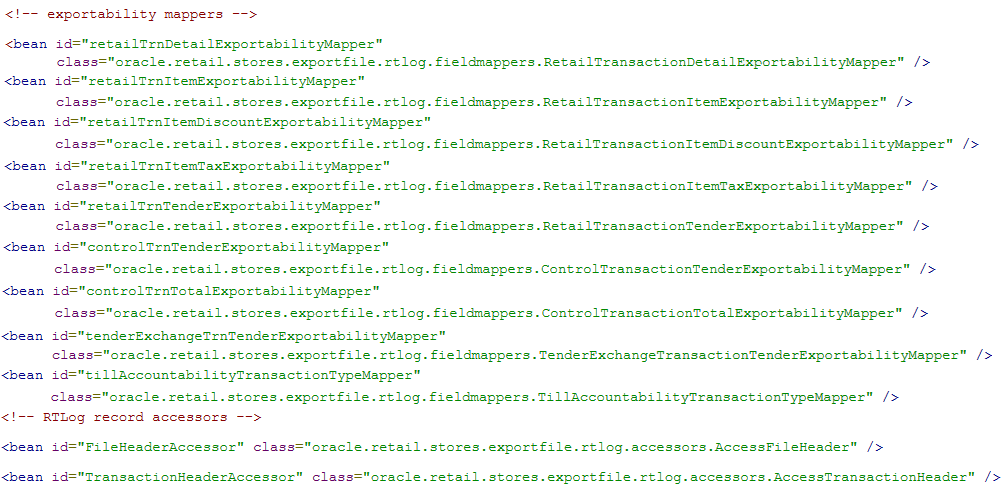

    • RTLogMappingBean.xml:
      This is a spring configuration XML file that provides metadata for the FieldMapper and Record Accessor beans which get injected into the RTLog Generator business logic classes. The following example is an excerpt from this file:
      Figure 6-3 RTLogMappingBean.xml File Excerpt
      Surrounding text describes Figure 6-3 .

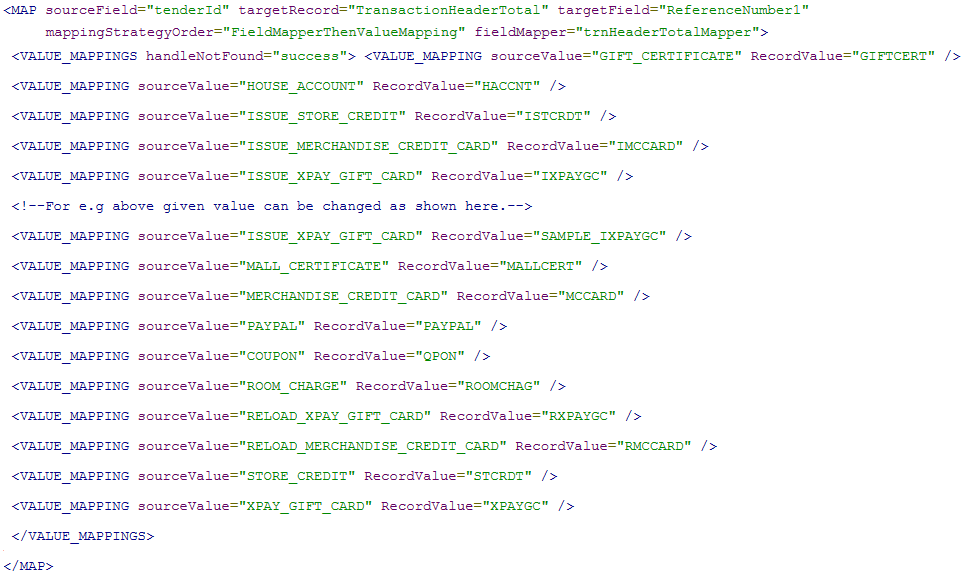

      • FieldMapperThenValueMapping: The RecordValue attribute values as shown in the following example can be changed:
        <MAP sourceField="tenderId" targetRecord="TransactionHeaderTotal" targetField="ReferenceNumber1" mappingStrategyOrder="FieldMapperThenValueMapping" fieldMapper="trnHeaderTotalMapper">
         <VALUE_MAPPINGS handleNotFound="success"> <VALUE_MAPPING sourceValue="GIFT_CERTIFICATE" RecordValue="GIFTCERT" />
         <VALUE_MAPPING sourceValue="HOUSE_ACCOUNT" RecordValue="HACCNT" />
         <VALUE_MAPPING sourceValue="ISSUE_STORE_CREDIT" RecordValue="ISTCRDT" />
         <VALUE_MAPPING sourceValue="ISSUE_MERCHANDISE_CREDIT_CARD" RecordValue="IMCCARD" />
         <VALUE_MAPPING sourceValue="ISSUE_XPAY_GIFT_CARD" RecordValue="IXPAYGC" />
         <!--For e.g above given value can be changed as shown here.-->
         <VALUE_MAPPING sourceValue="ISSUE_XPAY_GIFT_CARD" RecordValue="SAMPLE_IXPAYGC" />
         <VALUE_MAPPING sourceValue="MALL_CERTIFICATE" RecordValue="MALLCERT" />
         <VALUE_MAPPING sourceValue="MERCHANDISE_CREDIT_CARD" RecordValue="MCCARD" />
         <VALUE_MAPPING sourceValue="PAYPAL" RecordValue="PAYPAL" />
         <VALUE_MAPPING sourceValue="COUPON" RecordValue="QPON" />
         <VALUE_MAPPING sourceValue="ROOM_CHARGE" RecordValue="ROOMCHAG" />
         <VALUE_MAPPING sourceValue="RELOAD_XPAY_GIFT_CARD" RecordValue="RXPAYGC" />
         <VALUE_MAPPING sourceValue="RELOAD_MERCHANDISE_CREDIT_CARD" RecordValue="RMCCARD" />
         <VALUE_MAPPING sourceValue="STORE_CREDIT" RecordValue="STCRDT" />
         <VALUE_MAPPING sourceValue="XPAY_GIFT_CARD" RecordValue="XPAYGC" />
         </VALUE_MAPPINGS>
        </MAP>
        Figure 6-4 RTLogMappingConfig.xml Field Mapper Example 1
        Surrounding text describes Figure 6-4 .

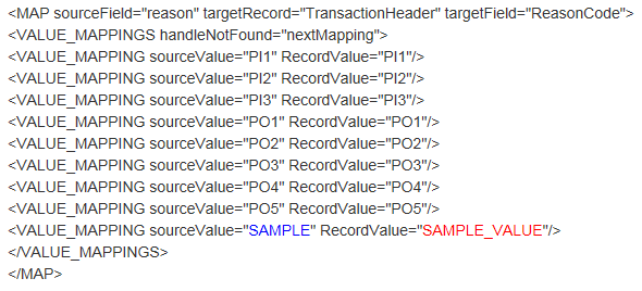

      • No mappingStrategyOrder and fieldMapper attributes are defined: The RecordValue attribute values shown in the following example can be changed or a new value can be added:
        <MAP sourceField="reason" targetRecord="TransactionHeader" targetField="ReasonCode">
         <VALUE_MAPPINGS handleNotFound="nextMapping">
         <VALUE_MAPPING sourceValue="PI1" RecordValue="PI1"/>
         <VALUE_MAPPING sourceValue="PI2" RecordValue="PI2"/>
         <VALUE_MAPPING sourceValue="PI3" RecordValue="PI3"/>
         <VALUE_MAPPING sourceValue="PO1" RecordValue="PO1"/>
         <VALUE_MAPPING sourceValue="PO2" RecordValue="PO2"/>
         <VALUE_MAPPING sourceValue="PO3" RecordValue="PO3"/>
         <VALUE_MAPPING sourceValue="PO4" RecordValue="PO4"/>
         <VALUE_MAPPING sourceValue="PO5" RecordValue="PO5"/>
        <VALUE_MAPPING sourceValue="SAMPLE" RecordValue="SAMPLE_VALUE"/>
         </VALUE_MAPPINGS>
         </MAP>
        Figure 6-5 RTLogMappingConfig.xml Field Mapper Example 2
        Surrounding text describes Figure 6-5 .

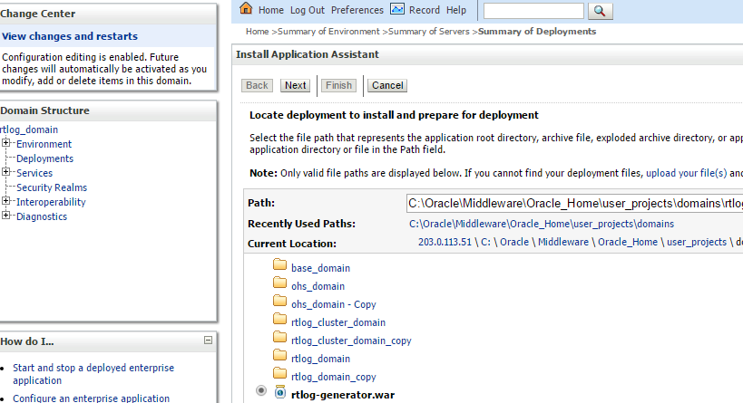

To deploy the RTLog Generator application:
  1. Log in to the WebLogic 12 Server Administration Console (http://<hostName>:<port>/console).
  2. Click the Deployment link from the left navigation menu.
  3. Click Install.
    Figure 6-7 Administration Console Control Page
    Surrounding text describes Figure 6-7 .

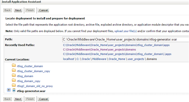

  4. Navigate to the rtlog-generator.war file directory. Select the rtlog-generator.war option.
    Figure 6-8 Administration Console Install Application Assistant Page
    Surrounding text describes Figure 6-8 .

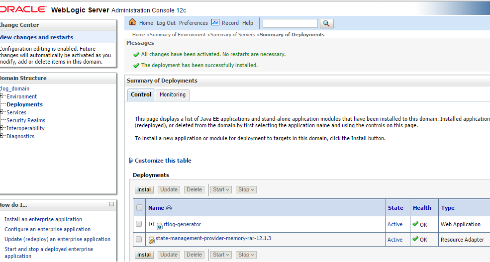

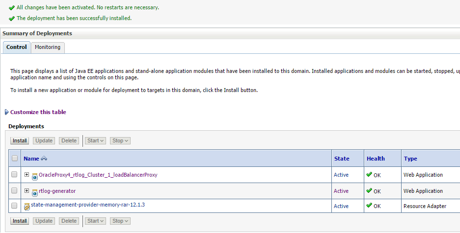

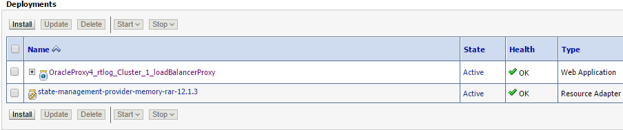

  5. Click Next and then Finish. Once deployed, RTLog Generator should be listed as one of the deployed applications as shown in Figure 6-9.
    Figure 6-9 Administration Console Summary of Deployments
    Surrounding text describes Figure 6-9 .

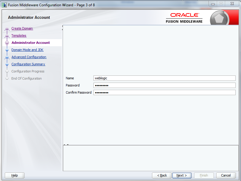

  4. On the Administrator Account page, enter the Administrator user name and password. Enter the password a second time to confirm. Click Next.
    Figure 6-12 Configuration Wizard Administrator Account Page
    Surrounding text describes Figure 6-12 .

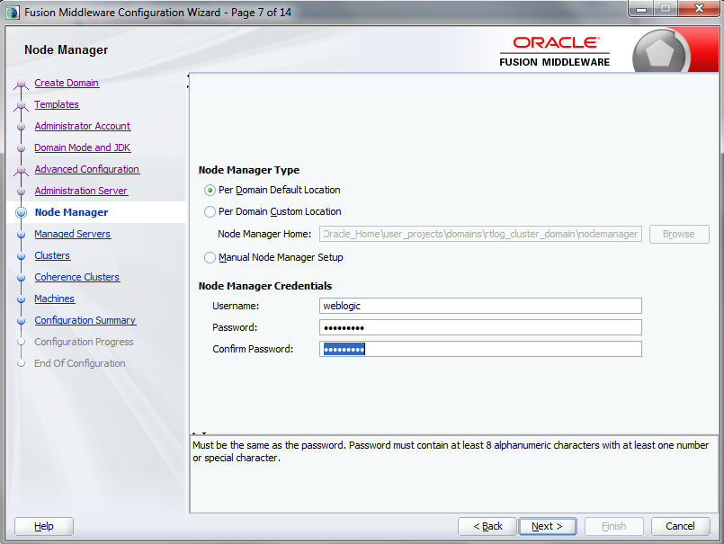

  8. On the Node Manager page, do not change the default node manager settings. For the credentials, enter weblogic as the user name and enter the password. Click Next.
    Figure 6-16 Configuration Wizard Node Manager Page
    Surrounding text describes Figure 6-16 .

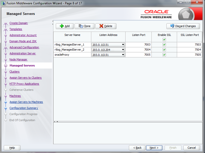

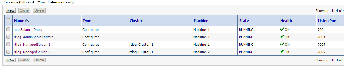

  9. On the Managed Servers page, add and configure each managed server:
    1. For the listen address, enter the IP address of the managed server. Do not select All local Addresses.
    2. rtlog_ManagedServer_1 will be running on Machine_1 in this configuration. Enter the Machine_1 IP address for the server.
    3. rtlog_ManagedServer_2 will be running on Machine_2 in this configuration. Enter the Machine_2 IP address for this server.
    4. oracleProxy is running on Machine_1, but is not a part of the cluster. It is an Oracle proxy HTTP cluster servlet used for failover and load balancing purposes. Enter the Machine_1 IP address for this server.
    5. Enable SSL for all the managed servers.
    6. Click Next.
    Figure 6-17 Configuration Wizard Managed Servers Page
    Surrounding text describes Figure 6-17 .

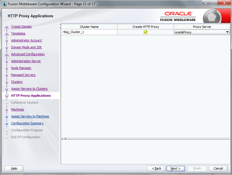

  12. On the HTTP Proxy Applications page, select Create HTTP Proxy and then select the server from the drop-down list. By default, it should have already been selected. Click Next.
    Figure 6-20 Configuration Wizard HTTP Proxy Applications Page
    Surrounding text describes Figure 6-20 .

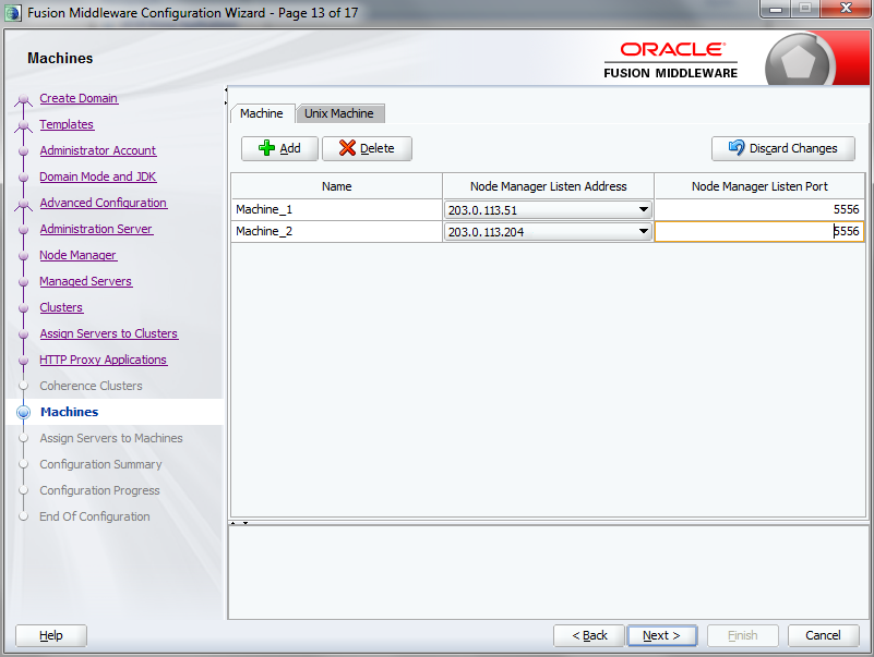

  13. On the Machines page, add and configure each machine. To add Machine_1 and Machine_2, click Add and enter the respective IP addresses. This configuration is for setting up the Node managers on both the machines. Since these node managers are physically separated, you can select the same host. Click Next.
    Figure 6-21 Configuration Wizard Machines Page
    Surrounding text describes Figure 6-21 .

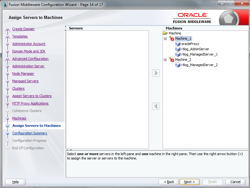

  14. On the Assign Servers to Machines page, assign the servers to the machines. In this example, Oracle proxy (load balancer), Administration server, and one managed server are configured on Machine_1. Another managed server is configured on Machine_2. Click Next.
    Figure 6-22 Configuration Wizard Assign Servers to Machines Page
    Surrounding text describes Figure 6-22 .

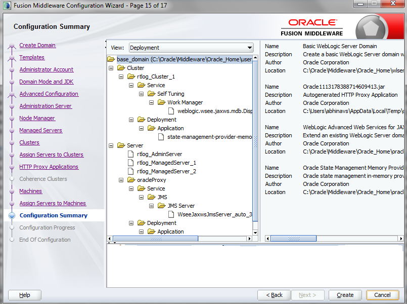

  15. On the Configuration Summary page, verify the selected configuration. Click Create. The domain is created.
    Figure 6-23 Configuration Wizard Configuration Summary Page
    Surrounding text describes Figure 6-23 .

    2. Create a folder named security under the <rtlog_clust_domain>\servers\Admin server.
    3. Create the boot.properties file with the following entries under the security folder:
      password=%admin_server_password%
      username=%admin_server_username%
      %admin_server_password% and %admin_server_username% are the administrator password and user name.

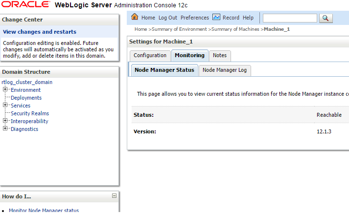

  7. Log in to the Administration Server console and make sure all the node managers are reachable. This can be found under Machines. Repeat this step for all the clustered machines to ensure all of them are reachable.
    Figure 6-24 Administration Console Settings Page
    Surrounding text describes Figure 6-24 .
  8. For each managed server, select the Server Start tab. In the Arguments text box, add the following if it does not already exist:
    -Xms512m -Xmx512m -XX:CompileThreshold=8000 -XX:PermSize=512m -XX:MaxPermSize=512m
    Figure 6-25 Administration Console Configuration Page
    Surrounding text describes Figure 6-25 .
    If you want to configure the non-default external RTLog configuration directory, include an additional JVM argument:
    -Drtloggen.config.dir=C:/<rtlog-gen-config_1>/
    The server-start arguments only work when you are using a NodeManager. If you do not have a NodeManager, specify the JVM argument in the start up scripts. You can also configure the same ext directory location in the RTLog Generator WAR's context-param. For more information, see "Configuration".
  9. Start all the managed servers including the Oracle proxy. Figure 6-26 shows an example of the list of managed servers.
    Figure 6-26 Administration Console List of Servers
    Surrounding text describes Figure 6-26 .

  2. Navigate to the Administration Console home page and click Deployments in the left navigation menu. Figure 6-27 shows an example of the page before deploying the RTLog Generator application.
    Figure 6-27 Administration Console Deployments Page
    Surrounding text describes Figure 6-27 .
  3. Click Install. The Install Application Assistant page appears. Select the path to the RTLog Generator WAR directory. Select the rtlog-generator.war option. Click Next.
    Figure 6-28 Administration Console Install Application Assistant Page
    Surrounding text describes Figure 6-28 .
  4. Select only the managed servers and click Next to finish the deployment.
    Figure 6-29 Install Application Assistant Select Deployment Targets Page
    Surrounding text describes Figure 6-29 .
    After it is successfully deployed, the RTLog Generator application appears in the Summary of Deployments page.
    Figure 6-30 Summary of Deployments Page
    Surrounding text describes Figure 6-30 .

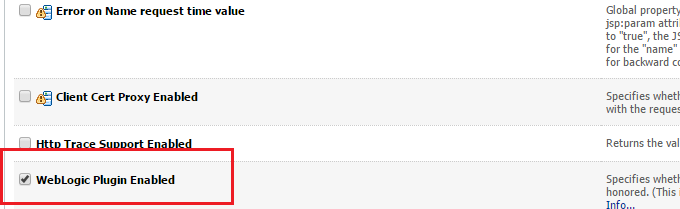

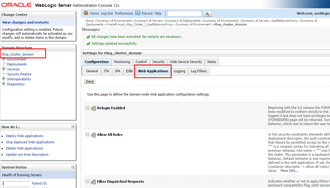

  6. To enable the WebLogic Plugin Enabled parameter from the cluster domain:
    1. Click the <rtlog_cluster_domain> link in the left navigation menu. Navigate to the Web Application tab.
      Figure 6-31 Administration Console Settings Page
      Surrounding text describes Figure 6-31 .
    2. Scroll down the page and select WebLogic Plugin Enabled. Click Save.
      Figure 6-32 WebLogic Plugin Enabled Parameter
      Surrounding text describes Figure 6-32 .

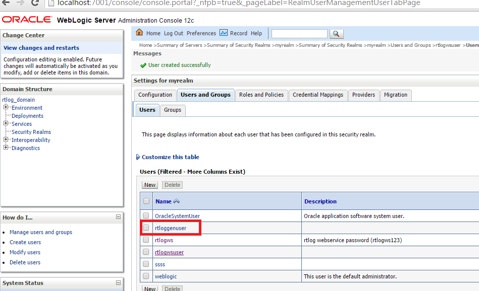

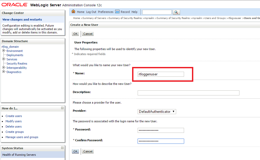

  5. Select the Users tab and click New. Enter a user name and password and click OK.
    Figure 6-35 Create a New User Page
    Surrounding text describes Figure 6-35 .
  6. In the list of users, click the newly created user.
    Figure 6-36 Users Page
    Surrounding text describes Figure 6-36 .
  7. Select the Groups tab. Assign this user to the same group created in Step 4.

  6. Enter the path to keystore.jks, including the file name, and enter the custom Identity Keystore passphrase you created for the keystore. Repeat this for trustore.jks, but enter the appropriate passphrase for the truststore. For an example, see Figure 6-41.
  7. Switch to the SSL tab. Enter the alias name and private keyphrase as created during the certificate generation. To save the changes, click Save.
    Figure 6-42 Save Settings for Administration Server
    Surrounding text describes Figure 6-42 .
