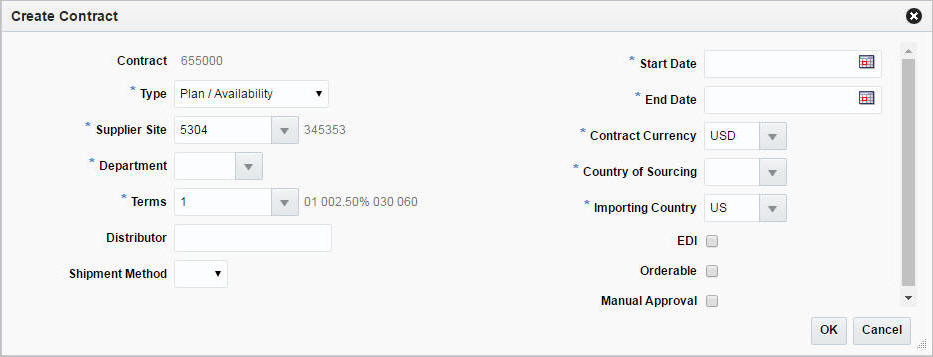

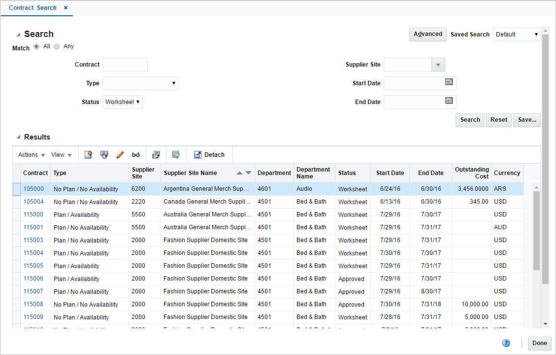

To create a contract follow the steps below.
From the Tasks menu, select Orders > Contracts > Create Contract. The Create Contract window appears.
Note: You can also create a contract in the Contract Search window. For more information about how to create a contract in the Contract Search window, see the Managing a Contract section. |
In the Contract field, the contract ID is filled in automatically.
In the Type field, select one of the following contract types:
Plan/Availability - refers to Type A contracts
Plan/No Availability - refers to Type B contracts
No Plan/No Availability - refers to Type C contracts
No Plan/Availability - refers to Type D contracts
Note: When using a Type B (Plan/No Availability) contract, purchase orders are generated automatically. Manual and Replenishment orders are never created from a Type B contract. |
In the Supplier Site field, enter, select or search for the supplier site. The fields such as Terms, Contract Currency and Importing Country are filled with default values based on the entered supplier site. You can change these values, if necessary. This is a required field.
Note: A Type C contract (No Plan/No Availability) does not require a supplier to provide availability information; therefore, it is possible that an order can be placed that a supplier cannot fulfill. |
In the Department field, enter, select or search for the department. Only items from this department can be placed on the contract. This field is a required field.
In the Terms field, enter, select or search for the contract terms, if you want to change the default value.
In the Distributor field, enter the distributor.
In the Shipment Method field, select the shipment method, for example, Air.
In the Start Date field, enter the contract start date or click the Calendar icon to specify the start date of the contract. This field is a required field.
In the End Date field, enter the contract end date or click the Calendar icon to specify the end date of the contract. This field is a required field.
In the Contract Currency field, enter, select or search for the currency of the contract, if you want to change the default value. This field is a required field.
In the Country of Sourcing field, enter, select or search for the country of sourcing for the contract. This field is a required field.
In the Importing Country field, enter, select or search for the importing country of the contract, if you want to change the default value. This field is a required field.
Check the EDI check box, to indicate that the contract is transmitted to the supplier via an EDI transaction.
Check the Orderable check box, to indicate that orders can be placed against this contract.
Check the Manual Approval check box, to indicate that all purchase orders will be created in Worksheet status and must be manually approved.
Note: All required fields are marked with an asterisk. If you do not enter a value for one of the required fields, an error message is shown. |
After you have entered all the necessary data for the contract, choose one of the following options.
Click OK, to create the contract. The Contract window appears in a new tab. For more information about the Contract window, see the Contract section.
Click Cancel, to reject all entries and close the Create Contract window.

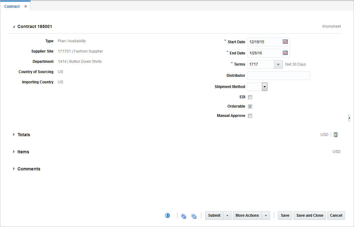

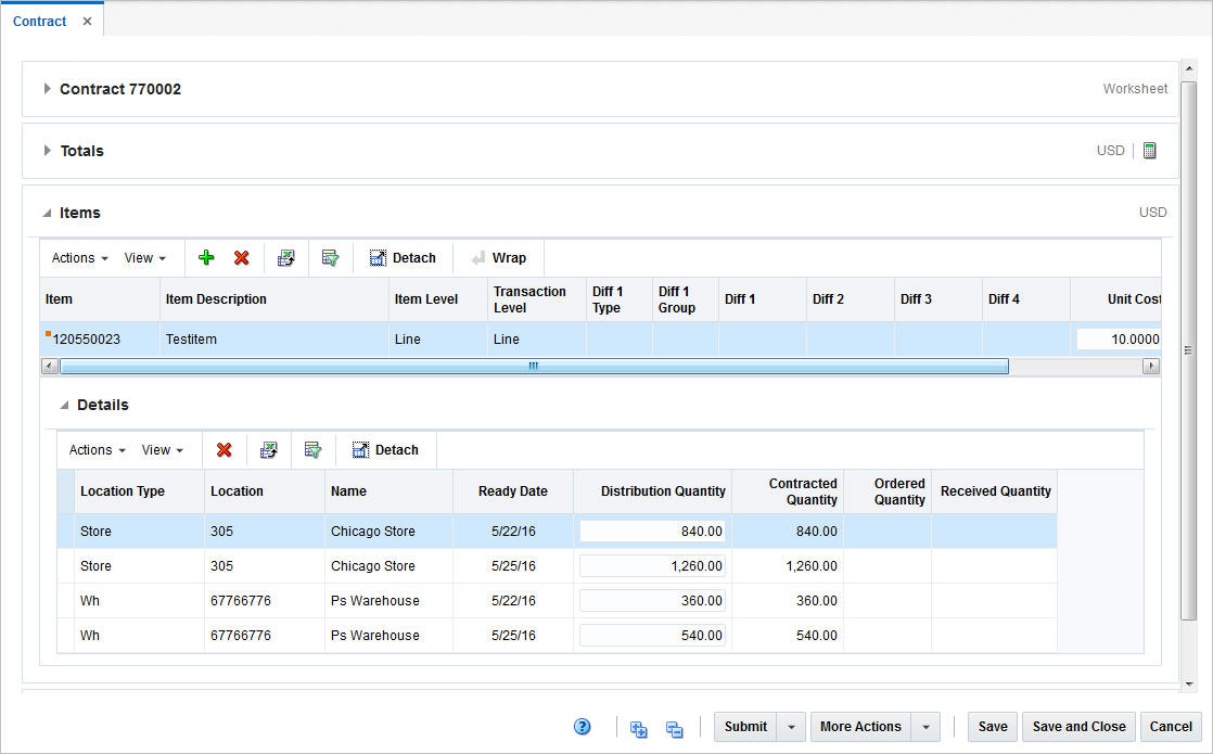

The Contract window allows you to create or maintain a contract. You can also add, edit and view the items, cost and distribution details on the contract. Moreover, you can navigate to the Parent/Diff summary screen, where you can view the details of the diffs for an item parent on a contract along with the quantity contracted, ordered, and received, as well as the ready date by diff value.
The Contract window consists of the following sections:
The Contract Header section contains the contract ID number and the status of the contract, for example Worksheet. Additionally the Contract Header section shows all values, entered in the Create Contract window. For more information about the values entered in the Create Contract window, see the following section:
Table 5-1 Contract Header - Fields and Description
| Fields | Description |
Type |
Displays the contract type. Possible contract types are:
For more information about the different contract types, see the Contract Types section. This field is a view-only field. |
Supplier Site |
Displays the supplier site. This field is a view-only field. |
Department |
Displays the department. Only items from this department can be placed on the contract. This field is a view-only field. |
Country of Sourcing |
Displays the country of sourcing for the contract. This field is a view-only field. |
Importing Country |
Displays the importing country for the contract. This field is a view-only field. |
Start Date |
Displays the contract start date. You can edit this field, if the contract is still in Worksheet status. |
End Date |
Displays the contract end date. You can edit this field, if the contract is still in Worksheet status. |
Terms |
Displays the contract terms, for example, Net 30 Days. You can edit this field, if the contract is still in Worksheet status. |
Distributor |
Displays the distributor for the contract. You can edit this field, if the contract is still in Worksheet status. |
Shipment Method |
Displays the shipment method for the contract. You can edit this field, if the contract is still in Worksheet status. |
EDI |
If the EDI check box is checked, the data is exchanged electronically. You can edit this field, if the contract is still in Worksheet status. |
Orderable |
If the Orderable check box is checked, orders can be placed against this contract. You can edit this field, if the contract is still in Worksheet status. |
Manual Approve |
If the Manual Approve check box is checked, all purchase orders will be created in Worksheet status and must be manually approved. You can edit this field, if the contract is still in Worksheet status. |

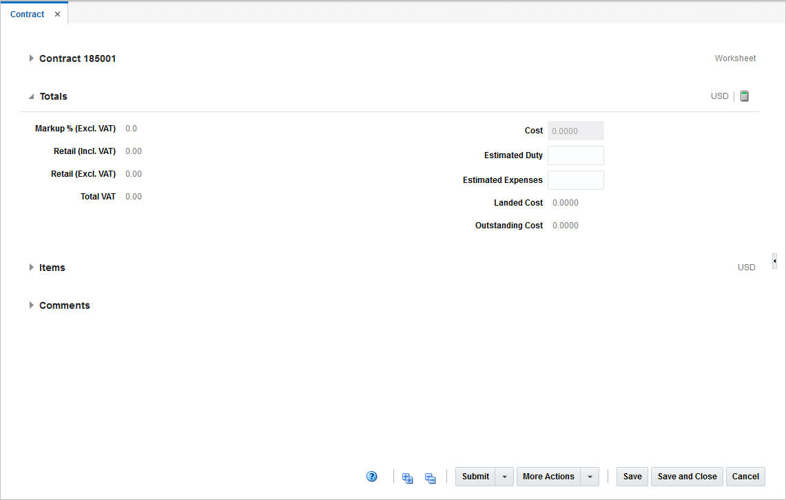

The Totals section contains the currency and Recalculation icon
in the title bar. Additionally the Totals section displays VAT information such as Markup % Excl. VAT, Retail Incl. VAT, Retail Excl. VAT and Total VAT. Moreover, cost, estimated duty, estimated expenses, landed and outstanding costs are shown. For more information about the displayed VAT information, see Table 5-2, "Totals - Fields and Description".
Note: If you create a new contract, the fields in the Totals section are empty. Total cost need to be added to type C and D contracts, before you add items. |
The following table describes the fields in the Totals section.
Table 5-2 Totals - Fields and Description
Markup % Retail |
This field shows the markup in %. When the retailer uses Simple VAT or Global Tax, this value excludes VAT. |
Retail (Incl. VAT) |
This field shows the total retail value of all items on the contract, including the VAT amount. This field only displays, if the retailer uses Simple VAT or Global Tax. |
Retail (Excl. VAT) |
This field shows the total retail value of all items on the contract, excluding the VAT amount. When the retailer uses Simple VAT or Global Tax, this value excludes VAT. |
Total VAT |
This field shows the total VAT of the contract. This field only displays, if the retailer uses Simple VAT or Global Tax. |
Cost |
This field shows the total cost of the contract. If you create a Type A or B contract this field is calculated automatically. You can not edit this field for these contract types. If you create a Type C or D contract, you can edit this field. The cost need to be added before you add items. |
Estimated Duty |
This field shows the estimated duties, taxes, and fees the retailer must pay to import the goods on this contract. You can specify this value for any contract type. |
Estimated Expenses |
This field shows the value of the estimated expenses that occurred for this contract. You can specify this value for any contract type. |
Landed Cost |
This field shows the sum of the cost, duty, and expenses for the shipments of the contract. |
Outstanding Cost |
This field shows the amount that is still open for this contract. |

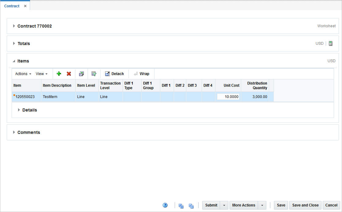

The Items section contains the contract item, contract item description, item level, diffs and unit costs by default. You can add items to the contract in this section. For more details about how to add items to a contract, see the Adding Items to a Contract section. Additionally, you can update the unit cost per item. For more information about how to update the unit cost for an item, see the Editing the Unit Cost of Single Items on a Contract section.
Use the Actions Menu and Icons to apply actions to table. You can perform the actions listed below.
Table 5-3 Items - Actions Menu/Icons and Description
| Actions Menu/Icons | Description |

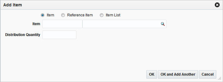

Add and Add icon |
You can add items to a contract by selecting Actions > Add or using the Add icon For more information about how to add items to a contract, see the Adding Items to a Contract section. |
Delete and Delete icon |
You can delete items from a contract by selecting Actions > Delete or using the Delete icon
Export to Excel and Export to Excel icon |
You can copy the records in the table to a Microsoft Excel spreadsheet by selecting Actions > Export to Excel or by using the Export to Excel icon |
You can customize the view of the table. Use the View Menu and icons to customize the view as listed below.
Table 5-4 Items - View Menu/Icons and Description
| View Menu/Icons | Description |
Columns |
You can manage which of the columns will be shown in the table by clicking the Show All and Manage Columns options. |
Detach and Detach icon |
You can view the tables in the application in a separate window by clicking Detach or by using the Detach icon |
Sort |
You can sort columns by the following options:
Reorder Columns |
You can reorder columns by clicking the Reorder Columns option. |
Query by Example and Query by Example icon |
You can filter the items by one or multiple column values by clicking the Query by Example option or by using the Query by Example icon |
The Details section displays the item distribution details by ready date and/or location. Columns shown are location type, location, name and ready date as well as the distribution, ordered and received quantity. The Details section is only displayed for Type A and B contracts, after items have been added and distributed.
You can edit the distribution quantity in this table. For more information about how to edit the distribution quantity, see the Editing the Distribution Quantity on a Contract section.
Use the Actions Menu and icons to apply actions to the table. You can perform the actions listed below.
Table 5-5 Details - Actions Menu/Icons and Description
You can delete an item distribution record from a contract by selecting Actions > Delete or by using the Delete icon |
You can customize the view of the table by using the options in the View Menu and icons listed below.
Table 5-6 Details - View Menu/Icons and Description
Columns |
Sort |
Reorder Columns |
You can filter the items by one or multiple column values by clicking Query by Example or by using the Query by Example icon |
In the Comments section you can enter necessary comments for the contract.

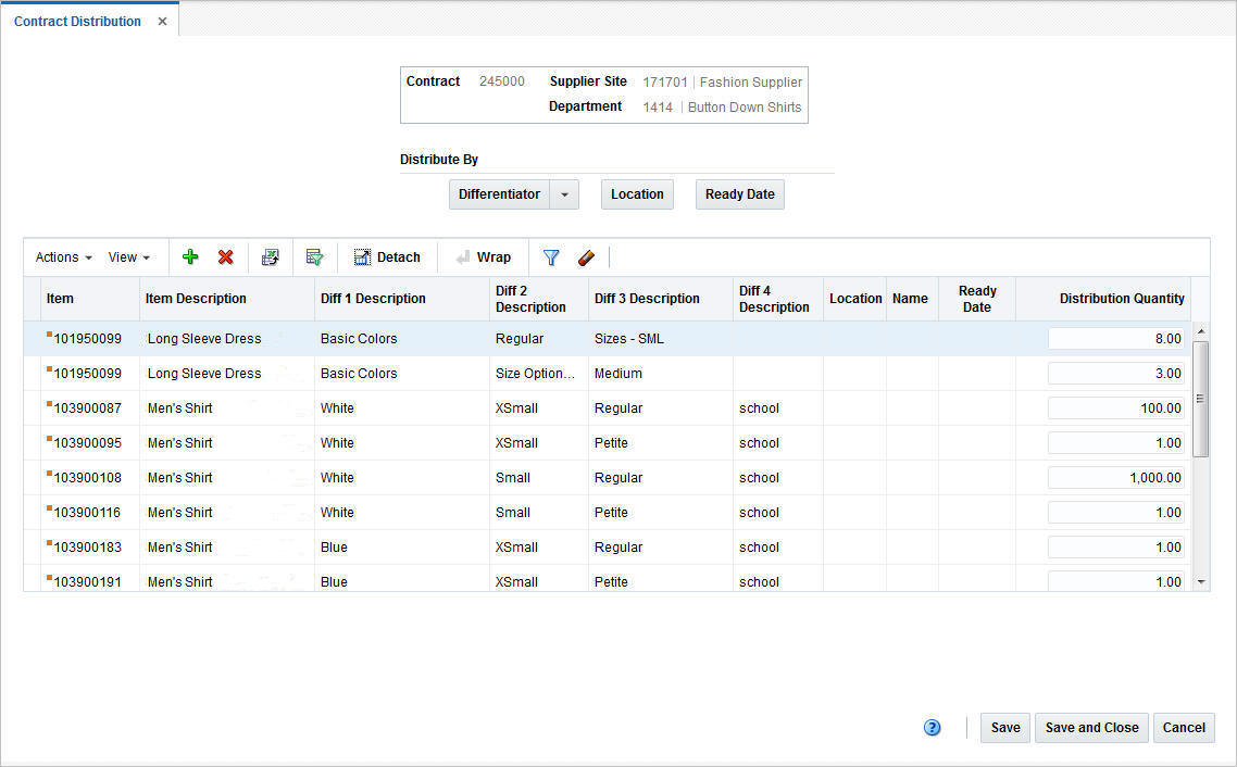

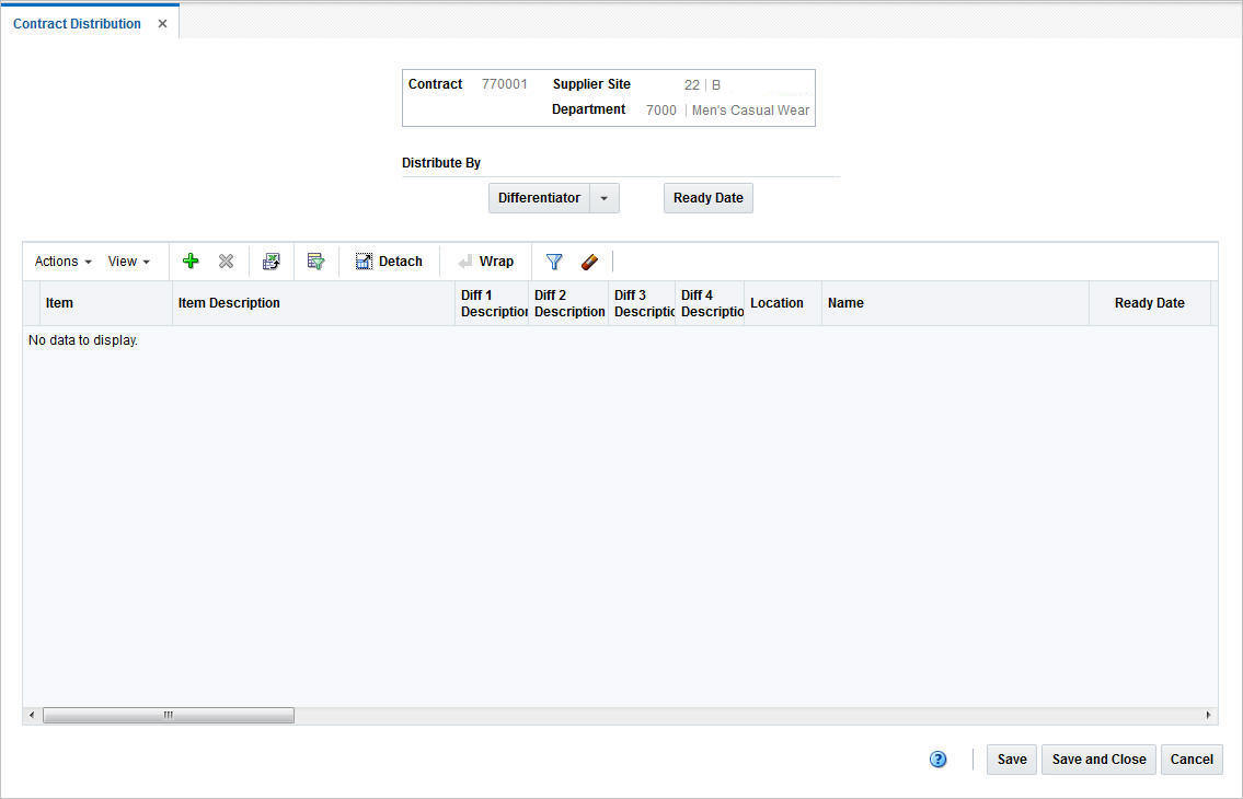

Distribute |
Opens the Contract Distribution window. For more information about how to distribute items on a contract, see the Contract Distribution section. |

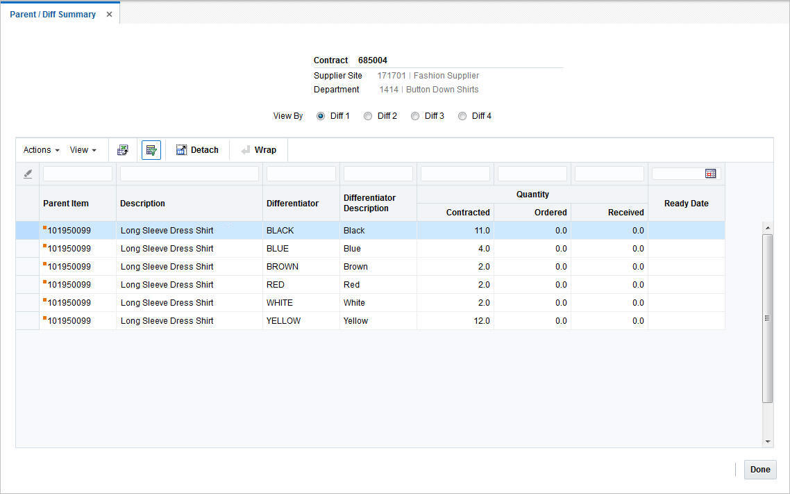

Parent Diff/Summary |
Opens the Parent Diff/Summary window. For more information about the parent diff/summary, see the Parent/Diff Summary section. |

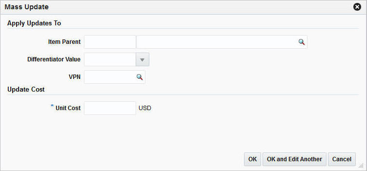

Mass Update Cost |
Opens the Mass Update window. For more information about how to update the costs for all items on a contract, see the Mass Update Cost section. |

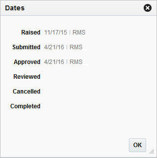

Dates |
Opens the Dates window. For more information on contract dates, see the Dates section. |

Before you can add items to Type C and D contracts, you have to add the total cost to the contract.
In the Contract window, go to the Totals section.
In the Cost field, enter the total cost of the contract.

In the item table, select Actions > Add, or use the Add icon
to add an item, reference item or list item to the contract. The Add Item window appears.
Select the item hierarchy level, you want to add item/items by. Items can be added at the transaction/item level, reference/item level or multiple items can be added by adding an existing item list.
In the Item/Reference Item/Item List field, select, enter or search for the item, reference item or item list.
In the Distribution Quantity field, enter the distribution quantity.
Note: The Distribution Quantity field is only available for type A and B contracts. For type C and D contracts, the quantity is not required. |
After you have entered all necessary data, choose one of the following options.
Click OK to add the item/items to the contract and exit the Add Item window. The system returns to the Contract Distribution window. The item/items is/are displayed in the item table.
Click OK and Add Another to add more items to the contract.
Click Cancel to reject all entries and close the window. The system returns to the Contract Distribution window.

Typically the contract cost is negotiated with the supplier. Therefore, the contract cost is lower than the default cost. To edit the cost of the contract item, follow the steps below.
In the Contract window, go to the Item section. Choose an item.
In the Unit Cost column, verify and/or edit the unit cost as necessary.
After you have entered the new unit cost for the item, choose one of the following options.
Click Save to save the entered records.
Click Save and Close to save the entered records and close the window.
To recalculate the costs of the contract follow the steps below.
Use the Recalculate icon
to update the costs and retail value.
Review the entered data and choose one of the following options to complete the contract:

From the Tasks menu, select Orders > Contracts > Manage Contracts. The Contract Search window appears.
Enter or select search criteria as desired to make the search more restrictive.
Click Search. The contracts that match the search criteria are displayed in the Results section.
In the Contract column, click the contract ID link, or mark a record and select Actions > Edit, or use the Edit icon

In the Toolbar, select More Actions > Mass Update Cost.
The Mass Update window appears.
If you want to apply the update to the item parent, you can choose the differentiator value or VPN.
Update by Item Parent: In the Item Parent field, enter or search for the corresponding item parent.
Update by Differentiator Value: In the Differentiator Value field, enter, select or search for the corresponding diff value, such as Small.
Update by VPN: In the VPN field, enter or search for the corresponding VPN.
In the Unit Cost field, enter the new unit cost.
After you have entered the necessary information:
Click OK to apply the mass update by the selected value and exit the Mass Update window. The system returns to the Contract window.
Click OK and Edit Another to apply another unit cost mass update.
Click Cancel to reject all entries and exit the Mass Update window.
The Contract Distribution window allows you to add or delete items on a contract and distribute those items. Items can be distributed by item parent or diffs. Additionally for Type A contracts you can distribute the items by ready date or location. For more information about distribution items of Type A contracts, see the Distributing Items of a Contract section. For Type B contracts the items can be distributed by location and by ready date. For more information about how to distribute items of Type B contracts, see the Distributing Items by Location and Distributing Items by Ready Date sections.
The Contract Distribution window consists of the following sections:
The header section of the Contract Distribution window displays the following information:
Contract ID
Supplier Site
Department
The Distribute By section contains options by which you can distribute the items of the contract.
Table 5-9 Distribute By Options
| Buttons | Description |
Differentiator |
Opens list with Diff options 1 - 4. |
Location |
Opens the Distribute By Location window. You can distribute the item by location. For more information about this distribution method, see the Distributing Items by Location section. Only available for Type B contracts. |

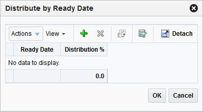

Ready Date |
Opens the Distribute By Ready Date window. You can distribute the item by ready date. For more information about this distribution method, see the Distributing Items by Ready Date section. Only available for Type A and B contracts. |
The Item table contains the contract items. By default the table displays the contract item, item description, diff 1-4 description, location, location name and ready date as well as distribution quantity.

In the Toolbar select More Actions > Distribute. The Contract Distribution window appears.
To filter the items shown in the item table, click the Apply Filter icon
. The Contract Distribution Advanced Filter window appears.
Enter, select or search for the criteria by which you want to filter the item table.
Select Add Filter Criteria. The filtered criteria is added to the Filter Criteria table.
To delete a criterion from the Filter Criteria table, follow the steps below.
Select the record.
Select Actions > Delete or use the Delete icon
. You are prompted to delete the record.
Confirm with Yes. The record is removed from the Filter Criteria table.
After you have added all filter criteria, choose one of the following options.
Click Apply Filter, to display the results of the filter in the Order Distribution window and close the Contract Distribution Advanced Filter window.
Click Cancel, to reject the filter criteria and close the Contract Distribution Advanced Filter window.
Click the Reset icon
, to reject the filter criteria and stay in the Contract Distribution Advanced Filter window.
In the Contract Distribution window, edit the filter results as needed.
To clear the filter, select Actions > Clear Filter, or use the Clear Filter icon
. All items are displayed in the item table again.

To distribute the items by location, follow the steps below.
From the Contract window select More Actions > Distribute. The Contract Distribution window appears. Go to the item table.
If you are already in the Contract Distribution window, go to the item table.
In the item table select a record.
In the Distribute By section, click the Location button. The Distribute by Location window appears.
In the Distribute By section, select the method of distribution, such as percent, quantity or ratio.
Note: You can distribute by quantity only, if you did not enter a quantity in the Contract Distribution window. |

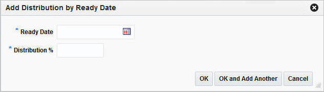

To distribute the items by ready date, follow the steps below.
In the item table, select a record.
In the Distribute By section, click the Ready Date button. The Distribute by Ready Date window appears.
Click Actions > Add or use the Add icon
to add a ready date. The Add Distribution by Ready Date window appears.
In the Ready Date field enter or use the Calendar icon to select a ready date.
In the Distribution % field, enter the percentage of the goods that are due by the ready date.
Then choose one of the following options.
Click OK to add the ready date and close the Add Distribution by Ready Date window. The entered ready date and distribution percentage are shown in the table of the Distribute by Ready Date Window.
Click OK to distribute the item. The system returns to the Contract Distribution window. The item table shows the item including the ready date and the corresponding distribution quantity.
Click Cancel to reject all entered records and close the Ready Date Window.
Click OK and Add Another to add additional ready dates for the selected item.
Click Cancel to reject all entered records and close the Add Distribution by Ready Date window.
The Distribute by Diff window allows you to distribute an item by the differentiator groups attached to the item. The user may use differentiator ranges and ratios while performing the distribution, or perform the process manually. For each selected differentiator, the distribution can be carried out on the basis of quantity, percentage or ratio.
To distribute the items previously added to the contract, by individual diffs, follow the steps below.
In the Distribute By section, select a diff from the list. The Differentiator Distribution window appears.
The Differentiator Distribution window contains the following sections.
Header: The header contains the selected diff group.
Diff Range: The Diff Range section contains a subset of diff groups.
Diff Ratio: The Diff Ratio section shows the ratio of diff IDs based on the sales history, which is used to assist in the distribution.
To limit the available diffs, go to the Diff Range field and enter or select a diff range ID.
Click Apply. The Available Differentiator column now only contains diff IDs limited to the chosen range.
Note: To apply multiple diff ranges, choose more than one valid range. |
In the Available Differentiator area, choose one of the following options.
Select a diff and click the right arrow button. The diff is moved to the Diff Ratio section to the Applied Differentiator column.
Select all diffs and click the move all right arrow button. All diffs are moved to the Diff Ratio section to the Applied Differentiator column.
Note: To deselect diffs, select the individual diff or all diffs. Then use the left arrow or move all left arrow buttons. The selected diffs move from the Applied Differentiator to the Available Differentiator column. |
Select one of the following distribution methods.
Percent: Enter the percentage of the items you want for each diff.
Quantity: Enter the number of items you want for each diff.
Note: You can only distribute by quantity, if you did not enter a quantity in the Order Distribution window. |
Ratio: Enter the proportion of the items you want for each diff.
Note: You can distribute the diffs and enter a percentage, quantity or ratio of zero (0). |
After you have selected the diffs and the distribution method, choose one of the following options.
Click OK to distribute by the selected diffs and exit the Differentiator Distribution window. The system returns to the Contract Distribution window. The individual diff distributions are shown in the table.
Click Cancel to reject all entries and close the Differentiator window. The system returns to the Contract Distribution window.
The Manage Contracts option opens the Contract Search window. In the Contract Search window you can perform the following actions.
Search for contracts by various search criteria
View the entered search results
View a contract
Create a contract
Create a contract from an already existing contract
Edit a contract
You can access the Contract Search window from the Task menu, select Orders > Contracts > Manage Contracts. The Contract Search window appears.
The Contract Search window contains the following sections.
Search
For more information about how to search for contracts, see the Searching for a Contract section.
To search for a contract:
From the Task menu, select Orders > Contracts > Manage Contracts. The Contract Search window appears.
You can search for a contract using basic or advanced search criteria, depending on the requirement. The basic mode is the default search mode.
Click Advanced to access the search section in advanced mode.
Click Basic to return to the basic mode.
To search for a contract using basic search criteria:
Enter, select or search for one or all of the following basic search criteria.
Table 5-15 Contract Search - Basic Search Criteria and Description
Match option |
Check radio button All or Any. All - only contracts matching all entered search criteria are shown. Any - contracts matching any of the entered search criteria are shown. |
Click Reset to clear the search section and results.
Click Save As... to save the current search criteria. The Create Saved Search window appears.
For more information about how to save your search criteria, see the Common User Interface Controls chapter, section "Create Saved Search".
Click Done to close the window.

The Parent/Diff Summary window allows you to view the parent/diff summary of the diffs for an item parent on a contract. You can view the quantity contracted, quantity ordered, quantity received, and the ready date by diff value.
The Parent/Diff Summary window consists of the following sections:
The header of the Parent/Diff Summary window contains the contract ID and the supplier site as well as the department of the contract.
In the View By section, you can choose to view records either by diff 1 to diff 4. Diff 1 is selected by default.
The Parent/Diff Summary table displays the following columns by default:
Parent Item
Description
Differentiator
Differentiator Description
Quantity
Contracted
Ordered
Received
Ready Date
Use the Actions Menu and Icons to apply actions to the table. You can perform the actions listed in the table below.
Table 5-19 Parent/Diff Summary Table - Actions Menu/Icons and Description
Wrap icon |
You can wrap the values in the table column by first clicking the column on which you would like the text to wrap and then using the Wrap icon |
You can customize the view of the table. Use the View Menu to customize the view as listed in the table below.
Table 5-20 Parent/Diff Summary Table - View Menu and Description
| View Menu | Description |
Columns |
Sort |
Reorder Columns |
To view the parent/diff summary of a contract follow the steps below.
In the Contract column, click the contract number link, or mark a record and select Actions > Edit, or use the Edit icon
. The Contract window appears.
In the Toolbar select the More Action > Parent/Diff Summary. The Parent Diff/Summary window appears.
The window displays the contract ID, the supplier site and the department in the Header section.
In the View By section select the differentiator 1, 2, 3 or 4.
Note: Diff 1 is selected by default. If you selected Diff 2, the content of the summary table is refreshed to display details corresponding to differentiator 2. |
The items are displayed in the Parent/Diff Summary table in the lower section of the window. The table contains the following information.
Parent Item
Description
Differentiator
Contracted, ordered and received Quantity
Ready Date
Note: Use the header row of the Parent/Diff Summary table to further narrow down the displayed records. Enter a value in the corresponding column. To clear the filter, click the Clear All icon |
To exit the Parent Diff /Summary window press Done.
The Dates window displays the following dates:
Raised - shows the date, the contract was issued
Submitted - shows the date, the contract was submitted
Approved - shows the date, the contract was approved
Reviewed- shows the date, the contract was reviewed
Cancelled - shows the date, the contract was cancelled.
To view the contract dates, follow the steps below:
In the Toolbar select More Actions > Dates, the Dates window appears.
View the displayed contract dates.
Click OK to close the window.

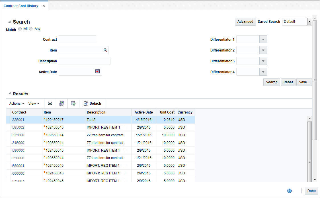

In the Contract Cost History window you can search for and view the cost of items by contract.
You can access the Contract Cost History window from the Task menu, select Orders > Contracts > Contract Cost History. The Contract Cost History window appears.
The Contract Cost History window contains the following sections.
Search
For more information about how to search for the cost of items by contract, see the Searching the Cost of Items by Contract section.
To search for the cost of items by contract follow the steps below.
From the Task menu, select Orders > Contracts > Contract Cost History. The Contract Cost History window appears.
You can search for the cost of items by contract by using basic or advanced search criteria, depending on the requirement. The basic mode is the default search mode.
To search for the cost of items by contract using basic search criteria:
Table 5-21 Contract Cost History - Basic Search Criteria and Description
Match option |
Contract |
Enter the contract number. |
Item |
Enter the item number. |
Description |
Enter the item description. |
Active Date |
Enter the active date of the contract. |
Differentiator 1 - 4 |
Enter the value for Differentiator 1 - 4. |
Click on the Saved Search list to select one of the saved search criteria. Selecting a saved search populates the search section with the saved search criteria. If the run automatically function is enabled for the search, the search is executed immediately.
You can also personalize your saved searches by selecting Personalize. The Personalize Saved Searches window appears.
For more information about the Personalized Saved Search, see the Common User Interface Controls chapter, section "Personalize Saved Search".
To search using advanced search criteria, enter or select one or all of the advanced search criteria.
To narrow down the search, use the list next to the search fields. For example, determine if the entered value should equal or not equal the search result.
Click Add Fields to add more fields for the advanced search. To remove the field from the search, click the x right next to the field.
Click Reorder to change the order of the available search fields. The Reorder Search Fields window appears.
Select the desired search field and use the up and down arrows to rearrange the order of the fields.
Click OK to confirm the new order of the fields and close the window.
Click Cancel to reject any changes and close the window.
The Results section lists the retrieved contracts. The Results table shows the following columns by default.
Contract
Item
Description
Active Date
Unit Cost
Currency
Use the Actions Menu and Icons to apply actions to the Results table. You can perform the actions listed below.

From the Tasks menu, select Orders > Contracts > Manage Contracts . The Contract Search window appears.

To edit the distribution quantity for Type A and Type B contracts follow the steps below.
Restrict your search for Type A and Type B contracts in Worksheet status.
Open the Items section.
In the Item section, open to the Details section.
In the Distribution Qty field, enter the quantity as necessary.
Click Save to save your changes.
Click Save and Close to save the change and close window.
Click Cancel to reject your changes and close the window.
When a contract is added to the system, it must go through a series of checks before it is accessible in the system. Depending on your user role, you may not be able to move the contract to the next status. A contract may be in any of the following statuses:
| Status | Definition |
| Worksheet | The contract is newly created or manually placed in Worksheet status. The contract can be edited in this status. |
| Submitted | The contract has been completed and is pending review.
Once the contract is submitted it cannot be edited. |
| Approved | The contract has been reviewed and has been approved.
Once approved, POs can be written against the contract. If no orders have been written against the contract, the contract can be changed to Worksheet status, if any further changes are required. |
| Canceled | The contract has been manually closed and is no longer valid.
A cancelled contract can be reinstated for re-use. |
| Completed | The contract is complete. |
| Reviewed | The contract has been reviewed, but not completed.
All contract types can be set to status Review after a specified period of inactivity. Type C and D contracts will also be set to status Review, if the contract has an open commitment and is past its end date. When in status Reviewed, orders can be called off the contract and retailers can choose to extend the end date or renew the supplier agreement. |
To submit a contract for approval follow the steps below.
Restrict your search to contracts in Worksheet status.
Click Search. The contracts in Worksheet status are displayed in the Results section.
In the Toolbar select Approve > Submit.
When prompted to submit the contract, choose one of the following options.
Click Yes to submit the contract and close the prompt. The system returns to the Contract window. The status of the contract is changed to Submitted.
Click No to end the process and close the prompt. The system returns to the Contract window. The status of the contract did not change.
To end the submit process, choose one of the following options.
Select Save to save your changes.
Select Save and Close to save your changes and close the window.
Select Cancel to reject your changes and close window.

To cancel a contract follow the steps below.
From the Tasks menu, select Orders > Contracts >Manage Contracts. The Contract Search window appears.
Click Search. The contracts in Worksheet, Submitted and Approved status are displayed in the Results section.
In the Toolbar select the status button. Then select Cancel.
When prompted if you want to cancel the contract, choose one of the following options.
Click Yes to cancel the contract and close the prompt. The system returns to the Contract window. The status of the contract changes to Cancel.
Click No to end the process and close the prompt. The system returns to the Contract window. The status of the contract does not change.
To end the cancellation process, choose one of the following options.
Select Cancel to reject your changes and close the window.
To reinstate cancelled contract follow the steps below.
Restrict your search to contracts in Cancel status.
Click Search. The contracts in Cancel status are displayed in the Results section.
In the Toolbar select the Reinstate button.
When prompted if you want to reinstate the cancelled contract, choose one of the following options.
Click Yes to reinstate the selected the contract and close the prompt. The system returns to the Contract window. The status of the contract changes to Worksheet.
To end the reinstate process, choose one of the following options.
