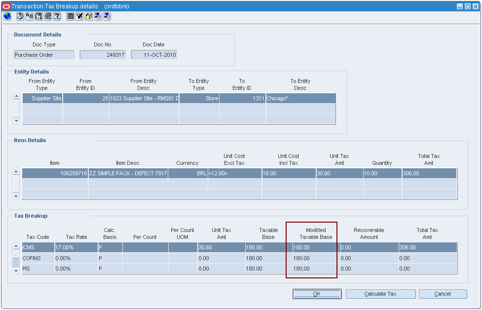

In the above window, the Tax Breakup section displays the tax details for each item.
A new column called Modified Taxable Base has been added in the Tax Breakup section of the Transaction Tax Breakup window.
For some items in Brazil, a tax rule is applicable that modifies the taxable basis. For such items, the tax rate is applied on the modified taxable basis. The Modified Taxable Base column displays the modified taxable basis applicable for the item.
In the Transaction Tax Breakup Details window, click the Calculate Tax button.
A call is made to TaxWeb Tax Rules. Relevant transaction details such as PO number, PO date, supplier, store/warehouse, item code, cost, utilization code, quantity and necessary calculations for tax are sent. TaxWeb Tax Rules sends the tax back to RMS. The calculation of tax happens on an on-demand basis.
If the tax calculation is not done before PO approval, it takes place during the PO approval. For externally or automatically generated orders, the tax calculation during approval is automatic and not on demand.
For items that are eligible for a change in the taxable basis, the tax rate is applied on the modified taxable basis. The Modified Taxable Basis column depicts the basis at which the tax is applied.

A new button called Tax Breakup is added on the PO/Item Location window to view the tax details at the item/location level. Click the Tax Breakup button, and the Transaction Tax Breakup Details window opens.
This window displays the tax details for the items. The new column called Modified Taxable Base displays the changed taxable base applicable for certain items in Brazil.
