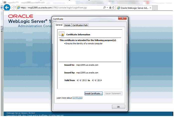

You need to add the signed Weblogic server certificate in the browser to avoid certificate verification error, if the Root Certificate is not in that list of trusted CAs.
Perform the following steps to import the Root Certificate through Internet Explorer:
Copy the Root Certificate file to the workstation.
Rename the file to fa_root_cert.cer (this is a quick and easy way to associate the file with the Windows certificate import utility).
Select the file.
Click Install Certificate and click Next.
Select Place all certificates in the following store and click Browse.
Select trusted Root Certification Authorities and click OK.
Click Next.
Click Finish and then Yes at the Security Warning prompt.
Click OK to close the remaining open dialog boxes.
