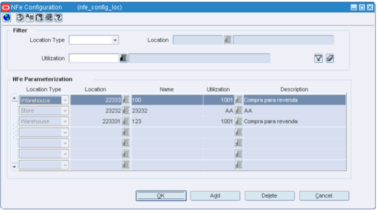

Navigate: From the RMS Start Menu, select Fiscal Management, then System Setup. From System Setup, select NF-e Model.

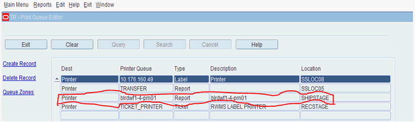

The steps to configure printer (setup in BI publisher) in RWMS are as follows:
Note: Part of customer order packing (for wh-c customer order shipping), this printer should be used in packing screen (Processing > Packing). |
Login to RWMS, navigate to Setup - Administration > Print Queue Editor.
Click Create Record > Fill detail Dest=printer, Type=Report, Printer Queue=description=printer name (setup in BI publisher), location=SHIPSTAGE
