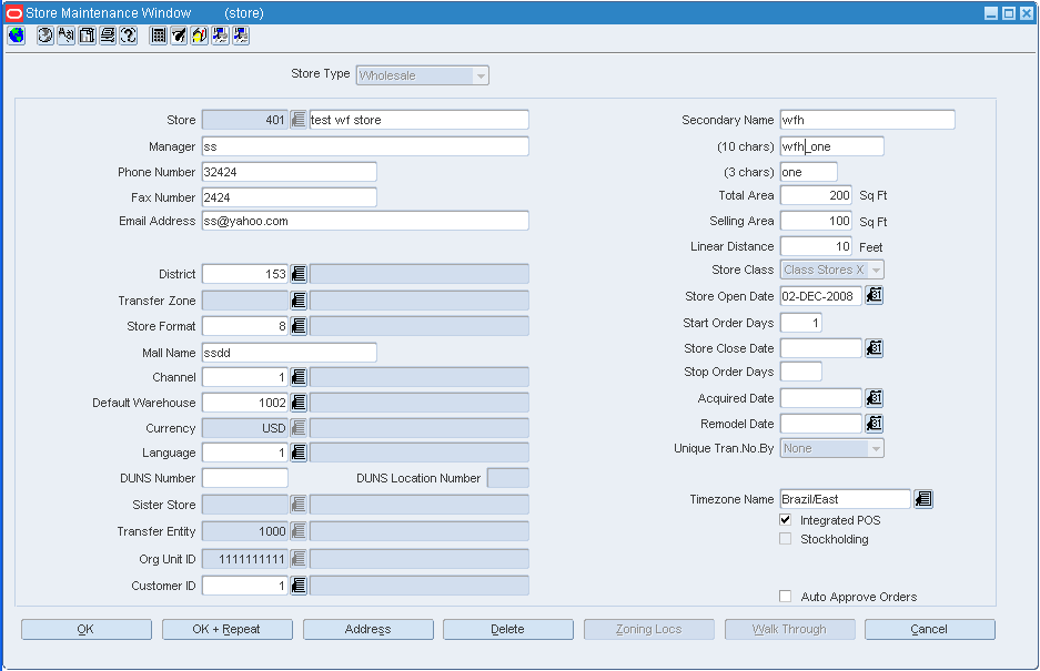

Store Maintenance
This section describes the updates in the Store Maintenance window to meet the Brazil market requirements.
To view/edit the changes made to the Store Maintenance window, do the following:
Navigate: From the RMS Start Menu, select Action, then select Organizational Hierarchy. The Organization Hierarchy Main Window is displayed.
  1. On the tree structure, select Store.
  2. Click View or Edit. The Store Maintenance window appears.
    Figure 1-6 Store Maintenance Window
    company_maintain

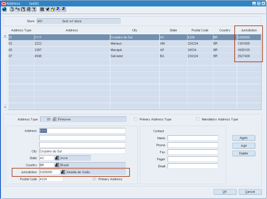

  3. A new field called Secondary Name has been added. Enter the secondary name of the store here.
  4. Click Address on the Store Maintenance window. A new column called Jurisdiction has been added. This column displays the identification number associated with the tax jurisdiction of the country-state relationship. In this Address window, you can enter multiple addresses for the store.
    Figure 1-7 Store Address Window
    Surrounding text describes Figure 1-7 .

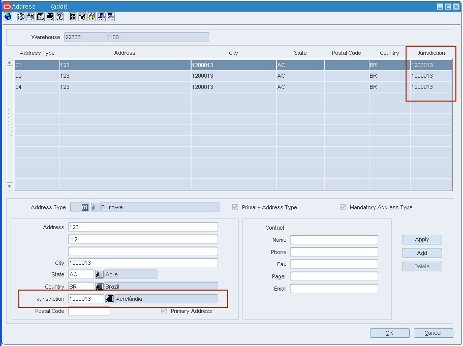

  4. Click Address on the Warehouse Maintenance window. A new column called Jurisdiction has been added to the Address window. This column displays the jurisdiction code depending on the given state, country or state/country combination.
    Figure 1-17 Address Window

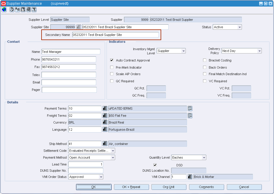

Figure 1-25 Supplier Maintenance Window
supplier_maintain
A new field – Secondary Name has been added. Enter the secondary address of the supplier.

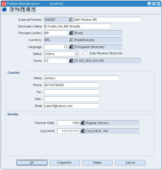

Navigate: From the RMS Start Menu, select Control, then Partner. The Partner Find window appears.
Search for and retrieve a partner in Edit mode. The Partner Maintenance window appears.
Figure 1-34 Partner Maintenance Window
partner_maintain
Two new fields have been added to meet the requirements of the Brazilian market. The two fields are:
  • Secondary Name – Enter the formal name of the partner.
  • Auto Receive Stock Ind – Select this check box to update the stock for the external finisher after the first leg of the shipment is transferred.
The Auto Receive Stock Ind option is highlighted on the Partner Maintenance page only when the Partner Type is chosen as External Finisher on the Partner Find page.

Outside Locations
The Outside Locations window has been changed to suit the requirements of the Brazilian market.
Navigate: From the RMS Start Menu, select Control, then Setup. From Setup, select Outside Locations.
In the Contents Of Outside Locations window, select Edit. The Outside Locations window appears.
Figure 1-41 Outside Locations Window
partner_maintain
In order to meet the requirements of the Brazilian market, two new fields have been added:
  • Secondary Name – Enter the formal name of the Outside Location.
  • Jurisdiction – Select the ID associated to the tax jurisdiction of the country-state relationship.

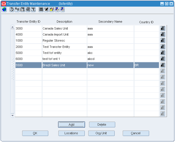

Transfer Entities
If the transfer entity is considered as the legal entity (based on system options), the fiscal attributes are set up as follows:
Navigate: From the RMS Start Menu, select Control, then select Setup. From the Setup, select Transfer Entities.
In the Contents Of Transfer Entities window, select View or Edit. The Transfer Entity Maintenance window appears.
Figure 1-50 Transfer Entity Maintenance Window
Surrounding text describes Figure 1-50 .
  1. In the Transfer Entity Maintenance window, set the Country ID as BR. In the Options menu, the Fiscal Attributes menu item is enabled only after setting the Country ID to Brazil.

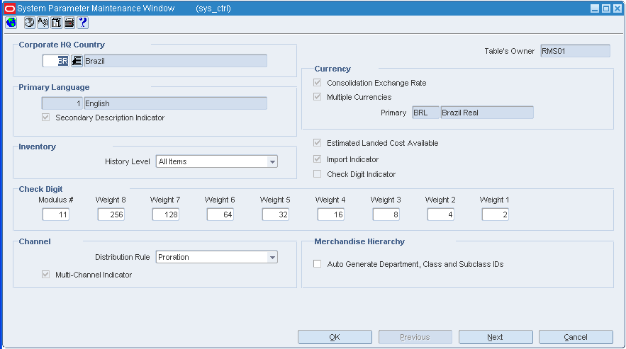

System Parameter Maintenance
The System Parameter Maintenance window enables you to customize various parameters, defaults, and constants that are used throughout the system. Normally, these elements are set when RMS is installed by the system or database administrator. They tend to remain fixed unless a business practice is changed which necessitates a change in RMS.
In order to suit the Brazilian requirements, a new tax type, Global Tax, is added to the default tax type LOV for RMS system options.
Navigate: From the RMS Start Menu, select Control, then System. From System, select System Variables. The System Parameter Maintenance window appears.
Figure 1-53 System Parameter Maintenance Window
system_parameter_maintenace
There are several windows associated with this window.
  • To view, and edit the values of the various windows that are associated with this window, click Next.
  • To go back to the previous window, click the Previous button.
  • To set the options for Brazil, in the Corporate HQ Country field, select BR from the LOV.
  • In the Tax form of the System Parameter Maintenance window, the Default Tax Type field is set to Global Tax.

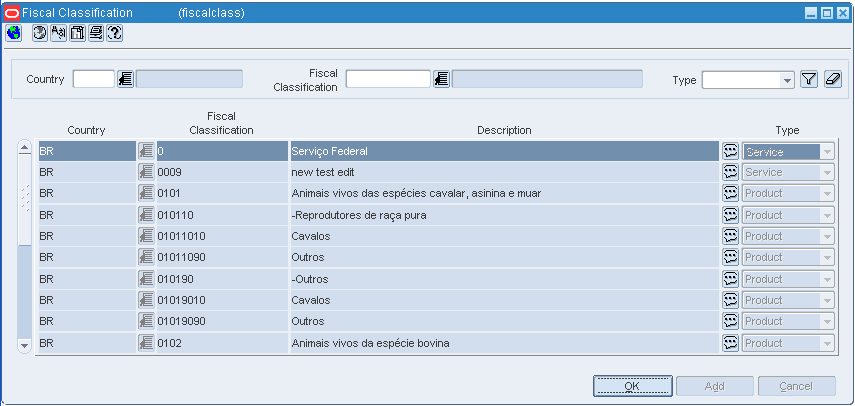

Fiscal Classification Codes
In Brazil, every item has a fiscal classification code called as Nomenclatura Comum do Mercosul or NCM. NCM codes, in general, are a classification of merchandise issued by the Brazilian government and are used to determine the taxes applicable to an item. As NCM codes are applicable to all the Mercosur countries, the new Fiscal Classification window provides the option to capture the country code along with the NCM codes.
Editing/Viewing the Fiscal Classification
To edit/view the fiscal classification, do the following:
Navigate: From the RMS Start Menu, select Items, then Fiscal Classification.
  1. In the Contents Of Fiscal Classification window, select Edit or View. The Fiscal Classification window appears.
    In View mode, the fields are disabled.
    Figure 1-55 Fiscal Classification Window
    fiscal_classification
  2. Select the country from the LOV in the Country field.
  3. Select the NCM codes/fiscal classification in the Fiscal Classification LOV.
  4. From the list in the Type column, select Product. Click the filter button.
    The multi-record block displays the country, fiscal classification, description, and the type for the criteria entered in the above fields.
  5. If the Type is Service, the multi-record block displays the Federal Service Codes. A Tax Engine supplies these codes.
  6. Click OK to close the window.

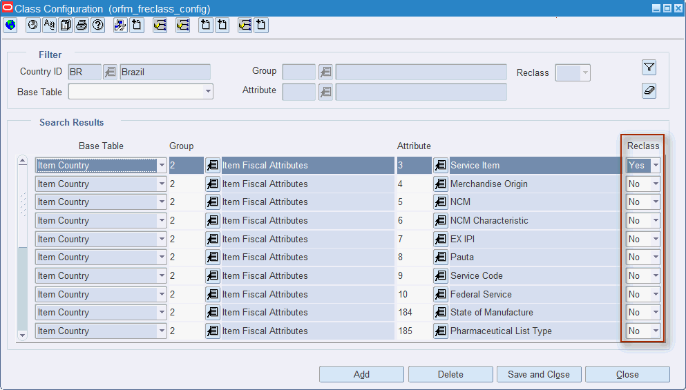

Configuring Fiscal Attributes Maintenance
To setup the behavior of the fiscal attributes maintenance process, do the following:
Navigate: From the RMS Start Menu, select Items, then Fiscal Attributes Maintenance. In the Content of Fiscal Attributes Maintenance, select Fiscal Attributes Configuration.
Figure 1-56 Class Configuration - New Window
Surrounding text describes Figure 1-56 .
Through this functionality the user can define which fiscal attributes, previously created in LFAS (Localization Flex Attributes System), will be displayed on the maintenance window. The setup will also determine if these configured attributes will trigger tax recalculation or not. With this setup it will be possible to update fiscal attributes and not recalculate taxes. Foundation updates can happen in the same day. Tax Recalculation will follow the existing batch window schedule. It will also be possible to plan future changes with a future effective date.
In the Class Configuration window, you have to select the country ID in order to start the setup.
The fields in the upper session of the window are available to be used as filters in order to list the existing lines already configured that can be updated. If nothing else but the country ID is selected, you will select the Filter button and the list will be populated with the existing setup if there is any. The Add button will then be enabled.
You can add a new line and fill the columns as following:
  • Base Table: LOV with options that identify which level the fiscal attribute belongs to
  • Group: Group from LFAS setup
  • Attributes: Which attribute from the selected group will be added
  • Reclass: Identifies if the attribute added will trigger tax recalculations or not.
You can delete any line using this window. After the setup is done, select the Save and Close button. You can select the Close button and a warning message will be displayed asking whether or not to save the transaction.

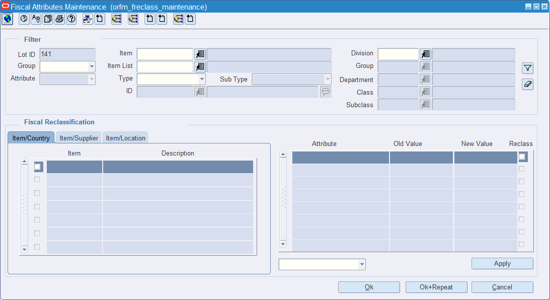

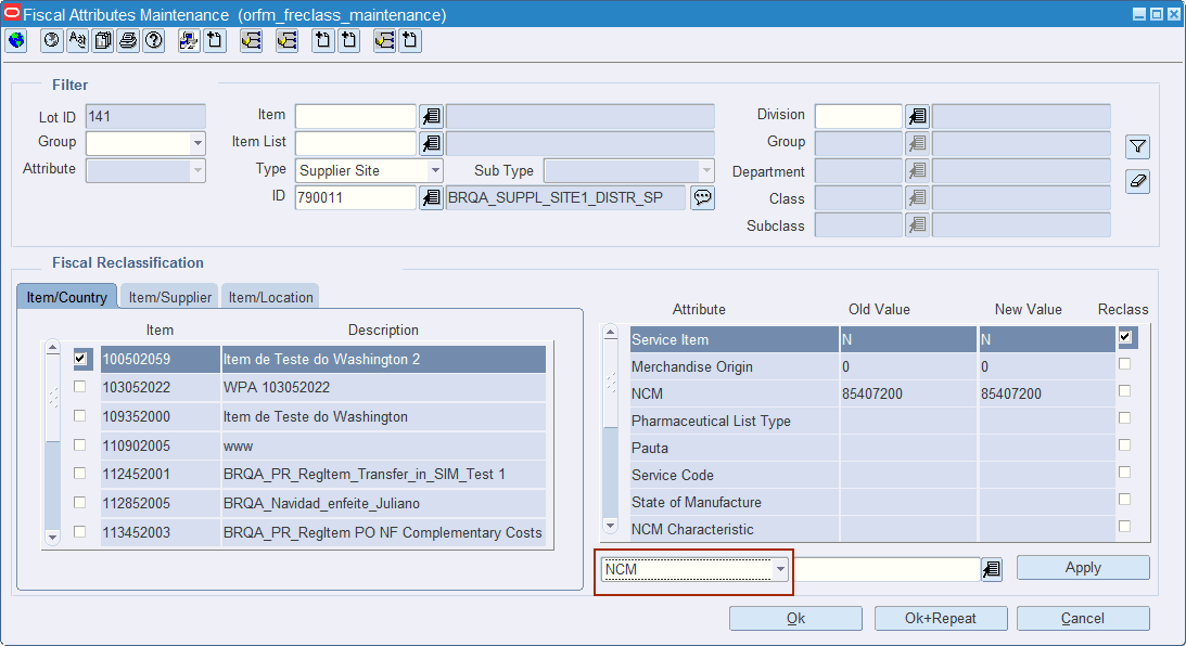

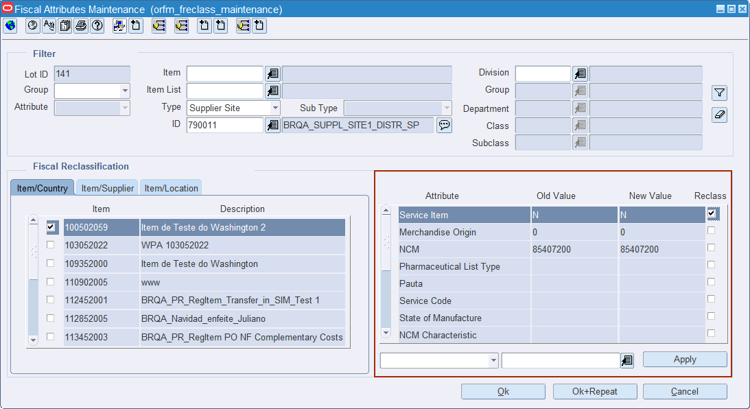

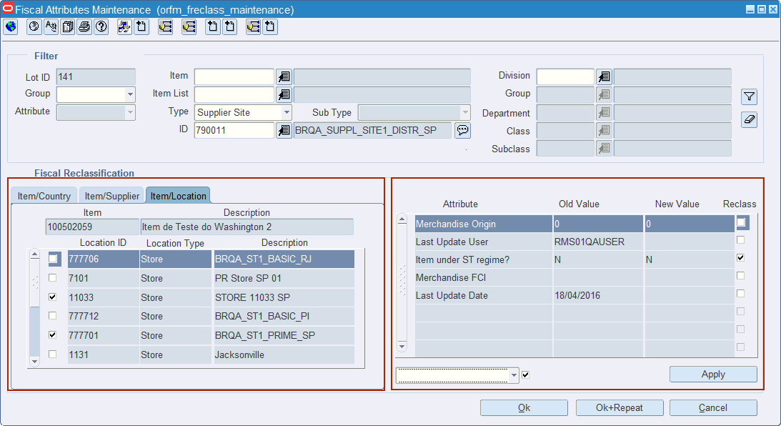

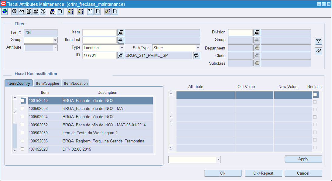

Maintaining Fiscal Attributes
To edit a fiscal attribute, do the following:
Navigate: From the RMS Start Menu, select Items, then Fiscal Attributes Maintenance. In the content of Fiscal Attributes Maintenance, select Fiscal Attributes Maintenance.

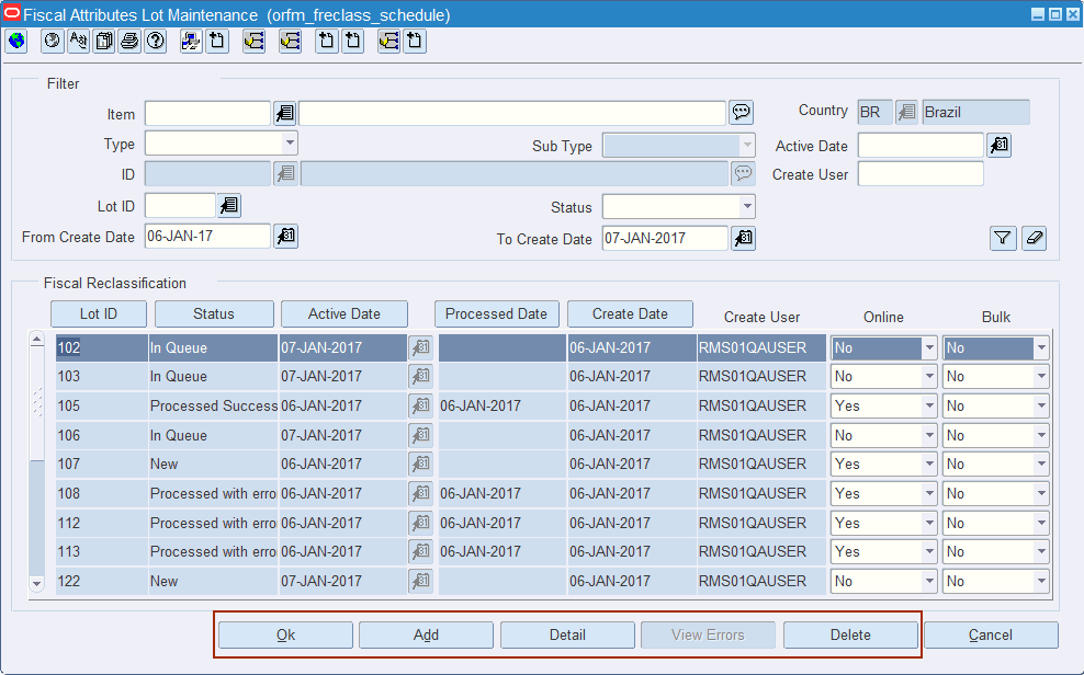

Figure 1-57 Fiscal Attributes Lot Maintenance
Surrounding text describes Figure 1-57 .
This new window allows you to create a lot for fiscal attributes maintenance. A lot can be one or multiple items to be reclassified. Each lot can be viewed or edited depending on its processing status.
The lots can be selected by using the filters available in the upper section of the window.
Table 1-2 Available Fields in the Filter Section
Fields Label Fields Description
Item
Field for insertion or selection through the component "List of Items", the code and the description of the item for which you want to refer to lots of change.
Country
Field for insertion or selection through the component "List of Countries", the country related to the item for which you want to refer to lots of change.
Note: The system should always automatically load, the country of the item defined in location, by default.
Type
Field to check through the list of values, the type of entity (Location or Supplier Site) for which you want to query lots of change.
Sub Type
Field to check through the list of values, the entity type (Store or Virtual Warehouse) for which you want to query lots of change.
Note: This field should only be enabled, if the field Type has been selected in the Location option.
ID
Field for insertion or selection through the component "List of Supplier Sites" or "List of Locations" (depending on the selection carried out in the field Type) of the entity for which you want to query lots of change.
Lot ID
Field for insertion or selection through the component "List of Lots", the number of the lot that you want to consult.
Status
Field to check through the list of values, the status of the lots of change that you want to consult (New, Processing, In Queue, and Processed with Errors, Processed Successfully or Canceled).
From Create Date
Field for entering or selecting through the "Date Entry" component, the initial date of the creation of the lots of change that you want to consult.
Note: The system should always automatically load SYSDATE, by default.
To Create Date
Field for entering or selecting through the "Date Entry" component, the end date of the creation of the lots of change that you want to consult.
Active Date
Field for insertion or selection through component "Data Entry", the date of activation of lots of change that if you want to consult.
Create User
Field for insertion or selection through the component "List of User Ids", the user responsible for the creation of the lots of change that you want to consult.
Table 1-3 Available Data in the Result Grid
Data Label Data Description
Lot ID
Lot number
Status
Lot status
Active Date
Allows you to set the activation date of the maintenance (maintenance and reclassification). Must be compulsorily reported (from VDate + X days, set in System Options).
Processed Date
Lot processing date
Create Date
Lot creation date
Create User
Lot creation user
Online
Indicates, if the maintenance must occur immediately, without ties to the reclassification. The use of this flag is subject to a System Option.
Bulk
Indicates, whether the lot comes change in bulk.
Table 1-4 Available Buttons at the Window Bottom
Button Label Button Description
Ok
Allows you to confirm maintenance actions performed on the screen "Fiscal Attributes Maintenance View" and return to the menu.
Add
Allows you to create a new lot by opening the "Fiscal Attributes Maintenance" window in edit mode.
Detail
Allows you to access the contents of a lot previously created, providing the "Fiscal Attributes Maintenance" window in edit mode or query mode (depending on the status of the lot).
View Errors
Allows you to view the reason of errors that prevented the change of all attributes contained in the lot.
Delete
Allows you to logically delete a previously created lot that has not yet been processed (depending on the status of the lot).
Cancel
Allows you exit the "Fiscal Attributes Maintenance View" window and return to the menu without confirming the maintenance actions performed.
You can add a new lot without using any of the filters. Once the new lot line is created, click Details to start building your reclassification lot.
After clicking Detail, the Lot details window appears.
Figure 1-58 Fiscal Attribute Maintenance - Lot Details
Surrounding text describes Figure 1-58 .
In this window you can create the lot for reclassification by selecting items to be part of the lot, using the filters available in the upper section of the window.

Table 1-7 Available Data in the Item/Country Attributes Results Grid (right hand side)
Field Label Field Description
Attribute
Related attributes to the item selected in the grid (left).
OLD Value
Current values (before the change) of the attributes related to the selected item in the grid (left).
NEW Value
New values (after change) of the attributes related to the selected item in the grid (left).
This value can be overridden through the Apply button (below the grid). The Apply button works together with the other two fields to your left:

The item location tab is also available for the item/location attributes maintenance. A similar display behavior as pervious tabs is present.
Figure 1-61 Fiscal Attributes Maintenance - Item/Location
Surrounding text describes Figure 1-61 .
Table 1-11 Available Fields in the Item/Location Tab
Item
Code of the previously selected item in the tab "Item/Country".
Description
Description of the previously selected item in the tab "Item/Country".
Table 1-12 Available Data in the Item/Location Location Results Grid (left hand side)
Checkbox
This flag is purely informative, indicating that for that particular location a fiscal attribute value change was held. A list of various locations, serves the user to know which locations have already been dealt with.
Location
Code of locations that are associated with the previously selected item in the tab "Item/Country".
Location Type
Type of locations (Store/Warehouse) that are associated with the previously selected item in the tab "Item/Country".
Description
Business name of the locations that are associated with the previously selected item in the tab "Item/Country".
Table 1-13 Available Data in the Item/Location Attributes Results Grid (right hand side)
Attribute
Related attributes to the location selected in the grid (left).
OLD Value
Current values (before the change) related attributes to the location selected in the grid (left).
NEW Value
New values (after the change) related attributes to the location selected in the grid (left).
In the first select the attribute that you want to change, and in the second, through free insertion, selection through the component, or list of values (* as provided in LFAS), you must define the new attribute value.
Surrounding text describes lot_det_filt_val.gif.
Reclass
This flag is purely informative, identifies whether the attribute change will require a reclassification.
In any of the three tabs, the updating process is the same.
  1. Select the item and attribute to be updated in the selection field.
    Figure 1-62 Fiscal Attributes Maintenance - Attribute New Value
    Surrounding text describes Figure 1-62 .
  2. From the LOV select the attribute to be changed. Then the value for you to select will be displayed and click the Apply button.
  3. After performing all necessary updates, click the OK button. For multiple updates in the same log, you can use the Ok + Repeat button.
    If at the time of the creation of a new lot of fiscal attributes for a change identified the existence of an attribute (item/key/country_id group_id/attribute_id) with a scheduled change and open (status "IN QUEUE"), the system does not allow the new change to take place.
  4. When you have completed editing the lot and after clicking OK, the following results are expected:
