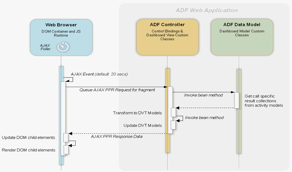

Automatic Browser Refresh using ADF Faces Poll Operations (c)
The normal ADF rendering life cycle produces the appropriate views for the Dashboard in a supported web browser. The browser refreshes these views using client side AJAX poll operations that call the shared object model for data from the server's managed beans using ADF binding references on the various view objects like graphs and tables.
There is no direct interaction required from the view layer components with the database to render summary pies, graphs and tables with the appropriate data. Instead, the managed beans transform the counts held by object instances in the memory model to the appropriate formats and classes required by each type of widget on each page.
The shared object model therefore supports much better scaling without placing additional load on the server because the main poll cycle is delegated to a single background thread.
Collectively, flows (a) through (c) form the overall polling process that keeps the views in the Dashboards in sync across all user sessions.

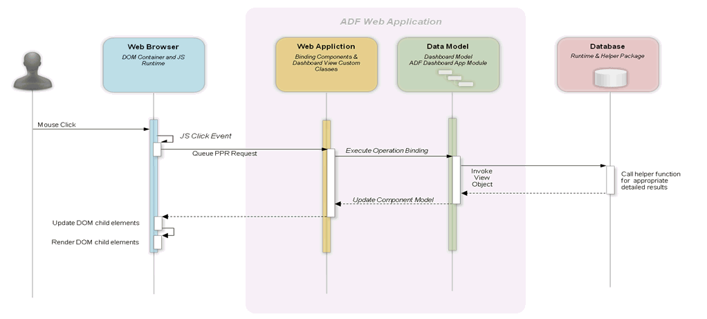

User Drill Down Interactions (d)
When users click on a summary graph or table for additional details for export tables, the following sequence on interactions occurs between the various component actors in the different layers of the solution.
This is out of the box behavior that uses ADF request/response actions with dynamic components and is covered in depth in the Fusion development guides for JSF components. The sequence can be summarized as follows:
A mouse click is propagated to the appropriate backing bean of the page fragment through a JavaScript event and a PPR action is queued for the server.
The backing bean invokes the appropriate handler code to call an Iterator Binding in the page definition of the fragment.
This in turn. Invokes the underlying VO instance that calls the appropriate Helper function within its query body. The WHERE and ORDER BY clauses in the VO query handle the parameterisation of the specific entity data that was clicked filtering the required result set.
The Iterator binding is updated which in turn updates the component model of the export table and sends the response back to the client browser.
The client updates the Document Object Model (DOM) child elements and then renders the output.

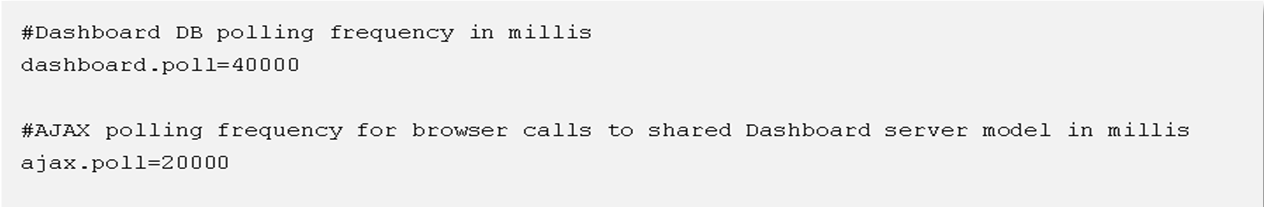

The following are the application.properties file values to control the operation of the server and client poll cycles:
The dashboard.poll property determines the frequency that the Timer thread uses to drive the main poll process for the shared object model in milliseconds. Values less than 10 seconds are ignored and default to 40 seconds. The timer generates events after the completion of the last poll process and is therefore independent of the data set sizes returned.
The ajax.poll property is bound to JSF Poll operation components that use AJAX to sequence PPR requests to refresh pages. Again, values less than 10000 milliseconds default back 20 seconds.

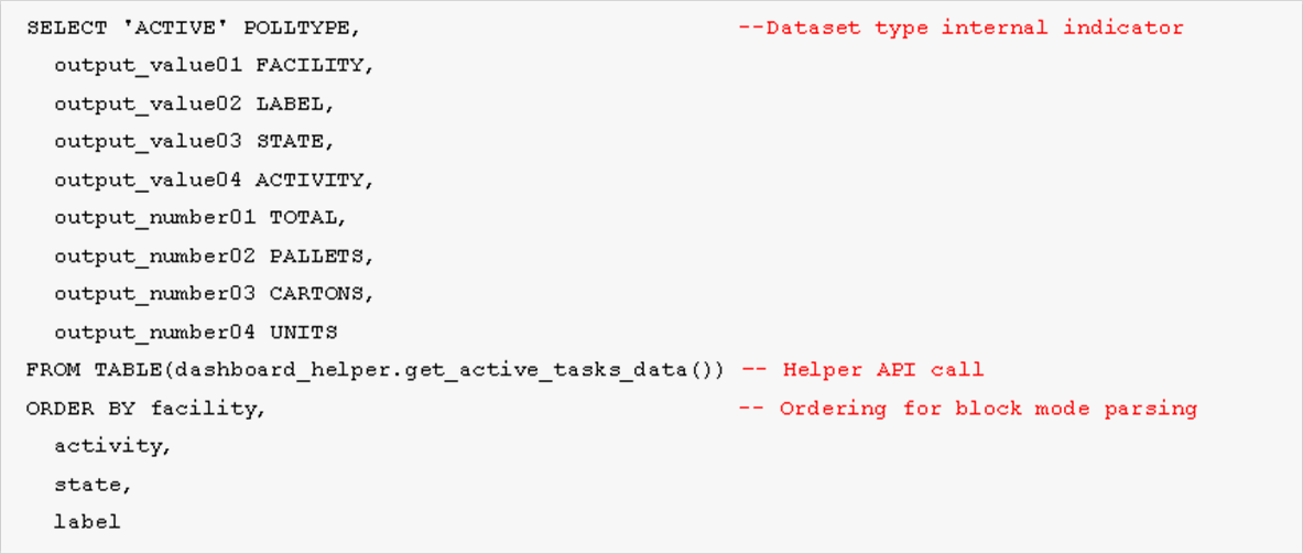

Summary Data Functions - used to update the shared memory model that is in turn used to render the dynamic JSF components in user views. The query wrappers perform the correct ordering and filtering of values with the appropriate ORDER BY clauses to optimize parsing for the shared model updates.
For example the following SQL code snippet is used to collect all summary data for active tasks for Transport, Cycle Counts and Picks:
All wrapper queries are embedded in the compiled ADF WebApp distribution and are invisible to customized Dashboard Helper implementations.

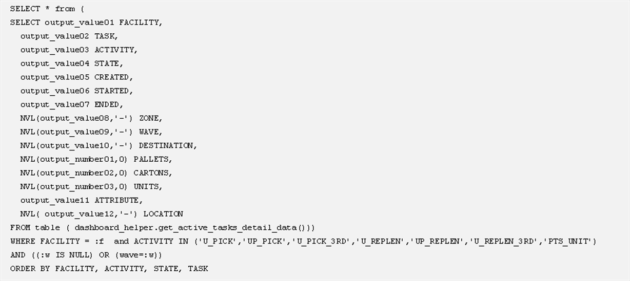

Drill Down Data Functions - used by ADF VOs to populate exportable output tables. VOs are view specific and defined for each export table.
The drill down functions of the API that provide view specific detailed outputs do not require any input parameter values in the call. Each related VO query provides the appropriate parameterization for the call based on what is being clicked by the user.
For example, the following SQL code snippet is defined as the query for the DailyApptSummaryView VO that is used to populate the daily appointments export table when a user clicks the summary graph on the same page.
