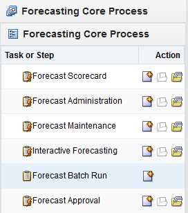

  1. Click the New Workbook icon in the Forecast Batch Run task in the Forecasting Core Process activity.
    Figure 11-1 Forecast Batch Run Task
    Surrounding text describes Figure 11-1 .

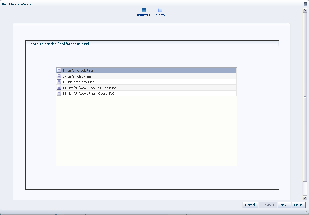

  2. The Workbook wizard opens. Select the levels to work with and click Next.
    Figure 11-2 Workbook Wizard: Select Final Forecast Level
    Surrounding text describes Figure 11-2 .

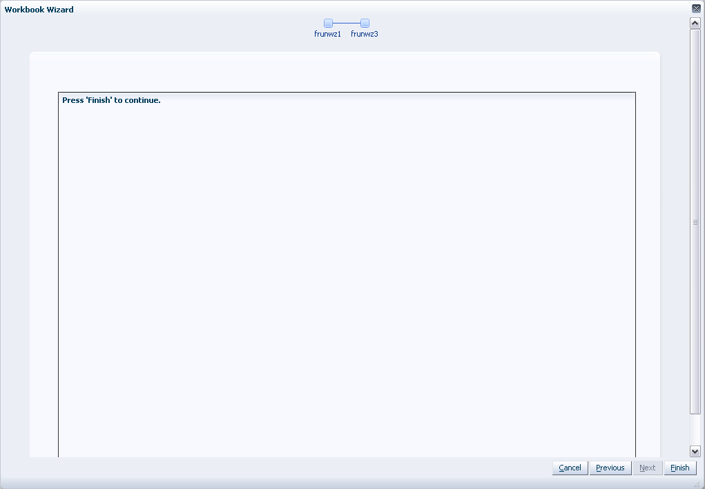

  3. Verify and click Finish.
    Figure 11-3 Workbook Wizard: Verify
    Surrounding text describes Figure 11-3 .
