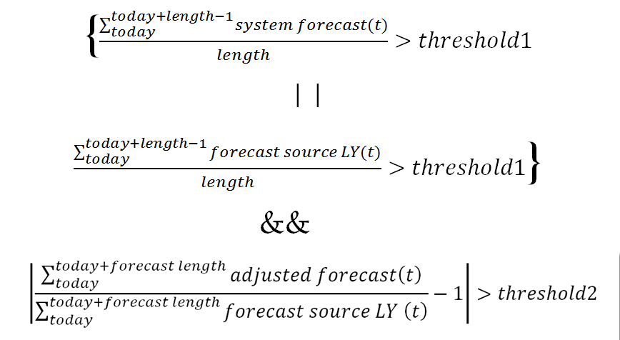

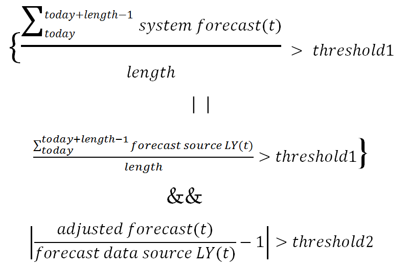

Forecast versus Last Year Sales
The most reliable forecasts are generated from data that has a repeatable pattern year over year. However, this is not always the case. A change in business strategy, merchandise reclassifications, new items can all lead to changing selling patterns over time.
To detect possible changes in selling patterns, the following alert will compare the last year's sales volume with the forecasted sales volume. If they are different by an adjustable percent, the alert is triggered.
Alert Expression
Where length,threshold1, and threshold2 are adjustable parameters.
For the batch alert:
Surrounding text describes cs_calc_fcvslyba160a.png.
For the real time alert:
Surrounding text describes cs_calc_fcvslyrta160.png.
The batch alert does not have a time component, while the real time alert is time-phased.
The calculation expression for this alert involves thresholds which can be adjusted in the Alert Thresholds task.First, we compare the average forecast and average sales last year to Threshold1. If Threshold1= 1, we make sure to run the alert only for item/stores that sell on average at least one per week. If the average is not too low, we proceed comparing the current adjusted forecast to the sales last year. If they are very different (defined by Threshold2), the user is alerted to review the forecast.

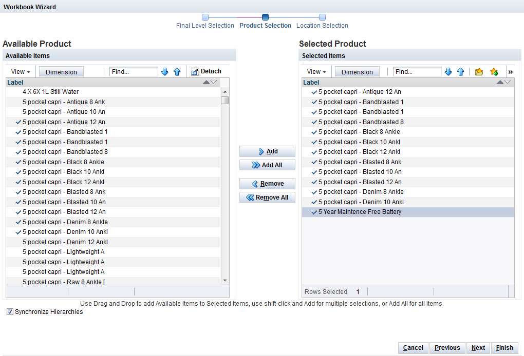

  3. Select the products you want to work with and click Next.
    Figure 14-3 Workbook Wizard: Select Products
    Surrounding text describes Figure 14-3 .

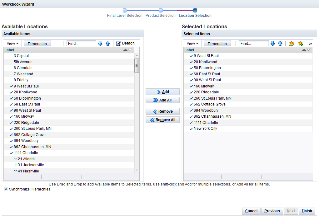

  4. Select the locations you want to work with and click Finish.
    Figure 14-4 Workbook Wizard: Select Locations
    Surrounding text describes Figure 14-4 .

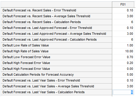

Forecast Alert Default Parameters View
The Forecast Alert Default Parameters view allows you to adjust the default values for alert thresholds.
Figure 14-5 Forecast Alert Default Parameters View
Surrounding text describes Figure 14-5 .
Measures: Forecast Alert Default Parameters View
All information in this view can be edited and represent domain level values.
The Forecast Alert Default Parameters view contains the following measures:
Default Forecast Length for Forecast Accuracy
This parameter defines the time frame over which the calculations are performed for the forecast accuracy alert.
Default Forecast vs Last Approved Forecast - Average Sales Threshold
This parameter defines the minimum rate of sales a product/location must have in order to be considered in the alert calculation. If the rate of sales condition is met and the forecast error is higher than allowed, the alert is triggered for the product/location.

Forecast vs Recent Sales Threshold - override
This parameter defines the allowable relative error between system forecast and forecast data source. If the error is higher than the threshold and the condition on the average rate of sales is met, the alert is triggered for the product/location.
High Forecast Error Value - override
Forecast accuracy for items with high rate of sales, as defined by the Medium Rate of Sales Value – override, is tested against this parameter to determine if an alert is triggered.
Low Forecast Error Value - override
Forecast accuracy for items with low rate of sales, as defined by the Low Rate of Sales Value – override, is tested against this parameter to determine if an alert is triggered.
Low Rate of Sales Value - override
If the rate of sales is less than this value, the item is considered to have a low rate of sale. Its forecast accuracy is tested against the Low Forecast Error Value – override, to determine if an alert is triggered.
Medium Forecast Error Value - override
Forecast accuracy for items with medium rate of sales, as defined by the Medium Rate of Sales Value – override, is tested against this parameter to determine if an alert is triggered.
Medium Rate of Sales Value - override
If the rate of sales is less than this value, the item is considered to have a medium rate of sale. Its forecast accuracy is tested against the Medium Forecast Error Value – override, to determine if an alert is triggered. If the rate of sales is more than this value, the item is considered to have a high rate of sale. Its forecast accuracy is tested against the High Forecast Error Value – override, to determine if an alert is triggered.
