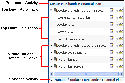

When top down users open MFP in the RPAS Fusion Client, they are presented with the preseason activity called Create Merchandise Financial Plan. The first task within this activity is Develop and Publish Company Targets. This task belongs solely to the top down user. It has four steps:
These tasks and steps are shown in Figure 3-1.
Note: The top down user can see the tasks of the middle out and bottom up roles, but the top down user cannot open or create workbooks within those tasks. This is denoted by the grayed out icons on the right of the taskflow. |
The top down user must complete these four steps to publish the strategic targets to the middle out user. To do this, the top down user must first build the workbook.

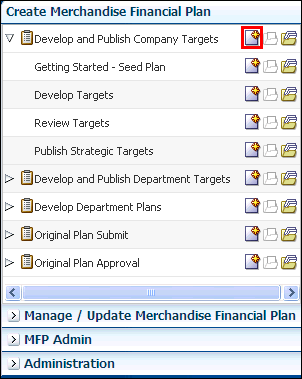

To build the top down role workbook, perform the following steps.
Click the Create New Workbook icon in the Develop and Publish Company Targets task.

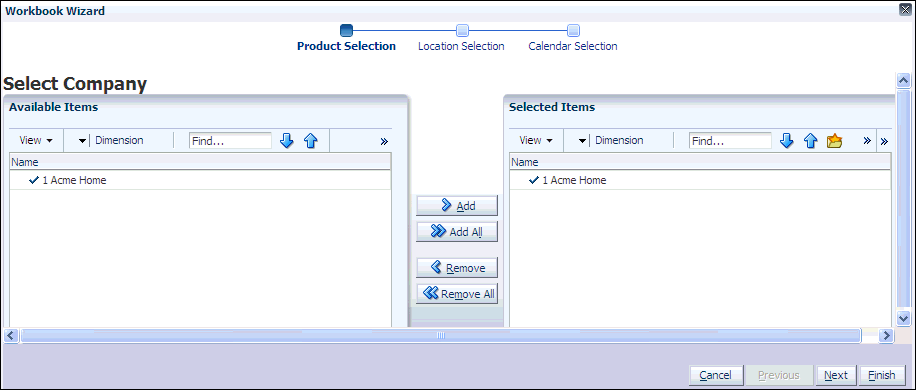

The workbook wizard opens at the Location Selection step. Select the company that you want to plan and move it to the Selected Items box. Click Next.
The Location Selection step of the workbook wizard appears. Select the channels you want to plan and move them to the Selected Items box. Click Next.

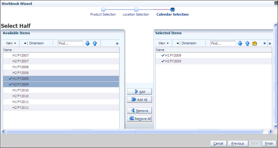

The Calendar Selection step of the workbook wizard appears. Select the halves you want to plan and move it to the Selected Items box. Click Finish.
The Top Down Role workbook is built, and the Initialize Plan view opens.

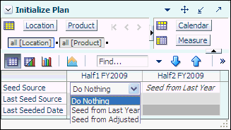

With this view, you can choose to seed your plan with Last Year (Ly) or Adjusted Last Year (Adj Ly) data to create a demand curve on which to spread the new plan's initial targets. Or, you can instead choose to not seed the plan, which allows you to create a plan that is not influenced by last year's performance.
In the example above, both Half1 and Half2 have been selected to be seeded for the Brick & Mortar channel for the 20 Menswear division.
When seeding the plan, you can choose which information is seeded. For instance, you can seed just one half or all halves in the workbook, as shown in Figure 3-6. You can also choose what locations and products to seed.
There are two ways you can seed. You can seed each level individually, or you can seed several levels at once by changing the dimension level shown in the view.

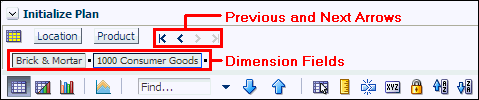

Click within the dimension field that you want to change, as shown in Figure 3-7.
Click the Next or Previous arrow, as shown in Figure 3-7.
The page refreshes and the next division in the Product dimension appears in the page edge. Note that the Seed Source measure is no longer populated.
Select the half that you want to seed with Ly or Adj Ly data.
Click the Next arrow to view and seed the next division.

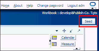

When you have selected all the data you want to seed, click Seed in the top, right corner.
A confirmation message appears, stating that the data has been successfully seeded. Click OK.

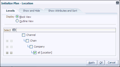

If you want to seed several locations and several products at once, you may want to change the level of the dimensions shown in the page edge.
The default setting of the Initialize Plan view is set to show the Calendar dimension at the half level, the Location dimension at the channel level, and the Product dimension at the division level.
To change the dimension level shown in the page edge or grid, perform the following steps:
Click the dimension tile of the dimension level you would like to change.
The dimension window appears. Select the level of the dimension that you want to appear in the page edge. If you want to view more than one level at a time in the page edge or grid, select multiple levels. In Figure 3-11, Channel was deselected and all [Location] was selected instead.
Click OK when finished.
Repeat steps 1 through 3 for other dimensions if desired.

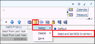

To set the BOS, perform the following steps:
In the Initialize Plan view, click the Measure Profile icon.
In the Measure Profile menu, click Select and then click the Seed and Set BOS Inventory measure profile.
The view is refreshed with the Seed and Set BOS Inventory measures visible.

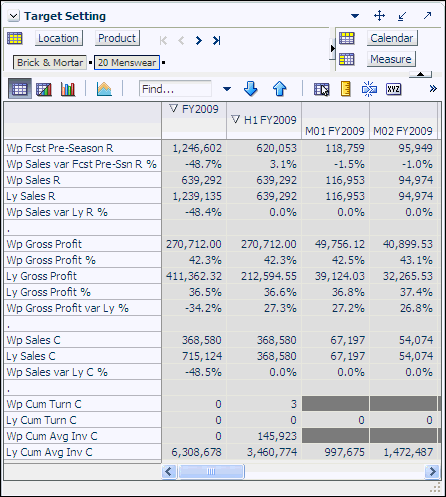

After you have seeded the divisions, develop the sales and gross profit targets for groups within those divisions.
The following table lists the measures available on this view.

To create the top down targets, perform the following steps:
Change the Calendar dimension so that year is displayed.
Enter the Wp Sales R that you are projecting. Use the Wp Fcst Pre-season R measure as a guide.
Plan the gross profit by editing either the Wp Gross Profit or Wp Gross Profit % measure.
Plan the cost by editing the Wp Sales C measure.
Enter the Wp Cum Turn C at the half level.
Note: The turn at the year is calculated by using the average inventory from the second half as the year average inventory. The turn for the year is calculated from the average inventory at the year level. |
Click Calculate to populate the Wp Cum Avg Inv C measure.
Optional: Use the Sales Contribution Analysis measure profile to assist you to create a more detailed top down target.

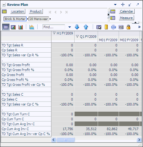

This step contains one view: Review Plan. In the Review Targets view, review the targets you created in the Develop Targets step.
If you need to alter the targets shown in this view, return to the Develop Targets step to edit them there.
Note: If you have not published top down targets yet, the TD Tgt measures have no values. |

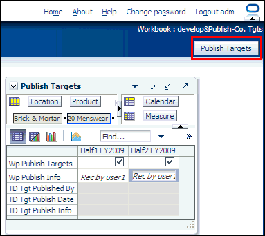

Use the Publish Strategic Targets step when you are ready to publish the targets you created. Publishing a target copies the target information to the TD Tgt (Top Down Target) measures in your workbook, and then it commits them to the database. After you have published, the targets are passed down to the middle out user.
Publishing a target copies your top down Wp measure information to the TD Tgt (Top Down Target) measures in your workbook, and then it commits those target measures to the database so that middle out users can retrieve those targets.
The TD Tgt measures are shown in the Review Plan view found in the Review Targets step. These measures initially have zero values. After the targets are published in this step, those measures are populated with the target information.
To publish the targets, perform the following steps.
Select the halves in the Wp Publish Targets measure that you want to publish.
If needed, enter relevant information in the Wp Publish Info measure. This is optional.
Repeat steps 1 and 2 for other locations and products if necessary.
Click Publish Targets. This button is located in the top, right corner, as highlighted in Figure 3-19.
A success message appears. Click OK to close it.
The view refreshes and clears the Wp Publish Targets and Wp Publish Info measures. The TD Tgt measures in this view are populated. These measures are described in detail in the table below.
