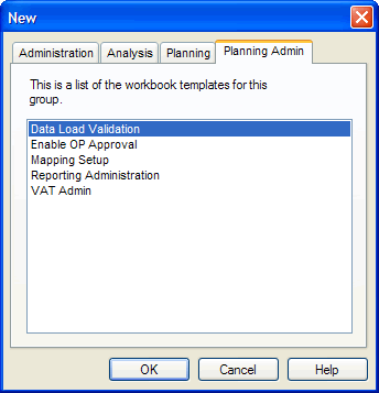

Select New from the File menu, or click the New button in the toolbar.
On the Planning Admin tab, select Data Load Validation and click OK.

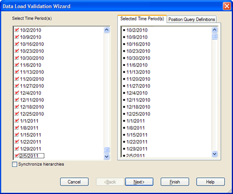

The Calendar Selection step appears. Select the weeks you want to examine and click Next.

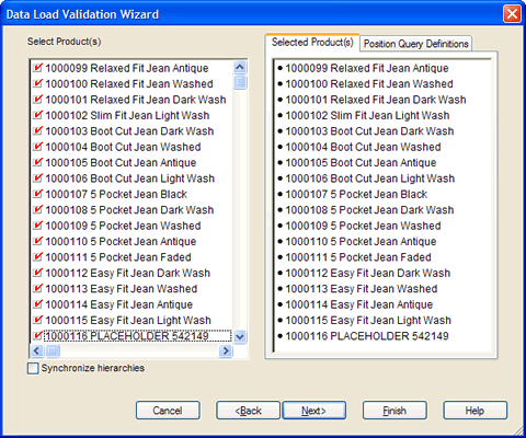

The Product Selection step appears. Select the products you want to examine and click Next.
The Location Selection step appears. Select the stores you want to examine and click Finish.

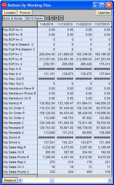

The Bottom Up Working Plan Tab has one worksheet, Bottom Up Working Plan.
Use the Bottom Up Working Plan worksheet to validate that the subclass data was updated in the batch process. Note that this worksheet is read-only.
The following table lists the measures available on this worksheet.
Table 9-1 Bottom Up Working Plan Worksheet Measures

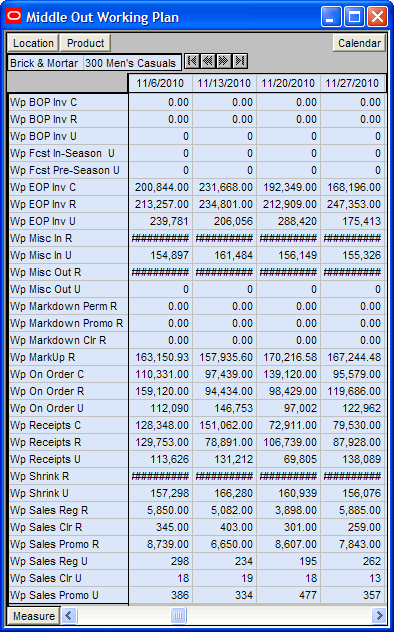

The Middle Out Working Plan tab has one worksheet, Middle Out Working Plan.
Use the Middle Out Working Plan worksheet to validate that the department data was updated in the batch process. Note that this worksheet is read-only.
Table 9-2 Middle Out Working Plan Worksheet Measures

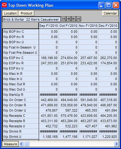

The Top Down Working Plan tab has one worksheet, Top Down Working Plan.
Use the Top Down Working Plan worksheet to validate that the division-group data was updated in the batch process. Note that this worksheet is read-only.
Table 9-3 Top Down Working Plan Worksheet Measures

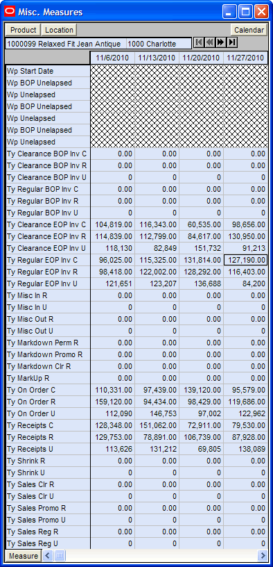

The Misc. Measures tab has one worksheet, Misc. Measures.
Use the Misc. Measures worksheet to validate that the measures were loaded in the batch process. Note that this worksheet is read-only.
Table 9-4 Misc Measures Worksheet Measures
| Measure | Description |
Wp Start Date |
Working plan start date. |
Wp BOP Unelapsed |
Bottom up working plan beginning of period unelapsed (time). |
Wp Unelapsed |
Bottom up working plan unelapsed (time). |
Wp BOP Unelapsed |
Middle out working plan beginning of period unelapsed (time). |
Wp Unelapsed |
Middle out working plan unelapsed (time). |
Wp BOP Unelapsed |
Top down working plan beginning of period unelapsed (time). |
Wp BOP Unelapsed |
Top down working plan unelapsed (time). |
Ty Clearance BOP Inv C |
This Year Clearance Beginning of Period Inventory Cost. |
Ty Clearance BOP Inv R |
This Year Clearance Beginning of Period Inventory Retail. |
Ty Clearance BOP Inv U |
This Year Clearance Beginning of Period Inventory Unit. |
Ty Regular BOP Inv C |
This Year Regular Beginning of Period Inventory Cost. |
Ty Regular BOP Inv R |
This Year Regular Beginning of Period Inventory Retail Value. |
Ty Regular BOP Inv U |
This Year Regular Beginning of Period Inventory Units. |
Ty Clearance EOP Inv C |
This Year Clearance End of Period Inventory Cost. |
Ty Clearance EOP Inv R |
This Year Clearance End of Period Inventory Retail. |
Ty Clearance EOP Inv U |
This Year Clearance End of Period Inventory Units. |
Ty Regular EOP Inv C |
This Year Regular End of Period Inventory Cost. |
Ty Regular EOP Inv R |
This Year Regular End of Period Inventory Retail Value. |
Ty Regular EOP Inv U |
This Year Regular End of Period Inventory Units. |
Ty Misc In R |
This Year Miscellaneous In Retail Value. |
Ty Misc In U |
This Year Miscellaneous In Units. |
Ty Misc Out R |
This Year Miscellaneous Out Retail Value. |
Ty Misc Out U |
This Year Miscellaneous Out Units. |
Ty Markdown Perm R |
This year's permanent price markdown for retail. |
Ty Markdown Promo R |
This year's promotional price markdown for retail. |
Ty Markdown Clr R |
This year's clearance price markdown for retail. |
Ty MarkUp R |
This Year Markup Retail Value. |
Ty On Order C |
This Year On Order Cost. |
Ty On Order R |
This Year On Order Retail. |
Ty On Order U |
This Year On Order Units. |
Ty Receipts C |
This Year Receipt Cost. |
Ty Receipts R |
This Year Receipt Retail Value. |
Ty Receipts U |
This Year Receipt Units. |
Ty Shrink R |
This Year Shrink Retail Value. |
Ty Shrink U |
This Year Shrink Units. |
Ty Sales Clr R |
This year's clearance sales. |
Ty Sales Clr U |
This year's clearance sales units. |
Ty Sales Promo R |
This year's promotional sales. |
Ty Sales Promo U |
This Year promotional sales units. |
Ty Sales Reg R |
This year's regular sales. |
Ty Sales Reg U |
This year's regular sales units. |
