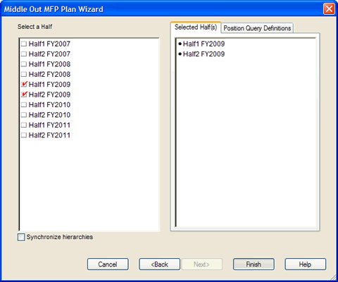

The Calendar Selection step appears. Select the half you want to examine and click Next.

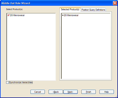

The Product Selection step appears. Select the divisions you want to examine and click Next.

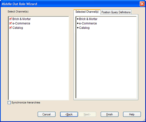

The Location Selection step appears. Select the channels you want to examine and click Finish.
The Middle Out MFP Plan workbook is built.

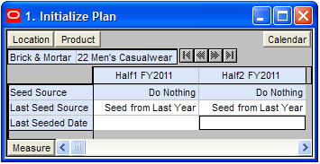

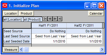

With this worksheet, you can choose to seed your plan with Last Year (Ly) or Adjusted Last Year data to create a demand curve on which to spread the new plan's initial targets. Or, you can instead choose to not seed the plan, which allows you to create a plan that is not influenced by last year's performance.
In the preceding example, both the Half1 FY2011 and Half2 FY2011 halves have been selected to be seeded with Ly data.
When seeding the plan, you can choose which information is seeded. For instance, you can seed just one half or all halves in the workbook. You can also choose what locations and products to seed.
There are two ways you can seed. You can seed each dimension individually, or you can seed several dimensions at once by changing the hierarchy dimension shown in the worksheet.
As shown in Figure 4-5, only the 22 Men's Casualwear group of the Brick & Mortar channel has been selected to be seeded. This means that the other product groups have not been selected to be seeded yet. To seed the next department in the Product hierarchy within the Brick & Mortar channel, perform the following steps:

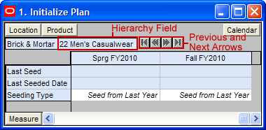

Click within the hierarchy field that you want to change, as shown in Figure 4-6.
Click the Next or Previous arrow, as shown in Figure 4-6.
The next dimension in the hierarchy appears. Note that the Seeding Type measure is now set to Do Nothing.
Choose the seeding type for one or more halves.
Click the Next arrow to view and seed the next dimension.
When you have selected all the data you want to seed, click Seed in the Planning Actions menu.
A confirmation message appears, stating that the data has been successfully seeded. Click OK.
After you have seeded, the worksheet is refreshed and the Last Seed Source and Last Seeded Date measures contain the type and date of the last seed, as shown in Figure 4-9.

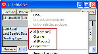

To change the hierarchy dimension shown in the worksheet, perform the following steps:

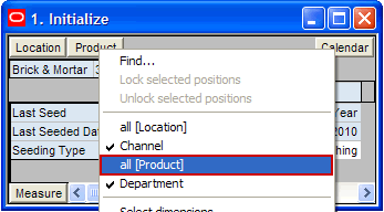

Right-click the hierarchy tile of the hierarchy dimension you want to change.
The right-click context menu appears. Select the dimension of the hierarchy that you want to appear, as shown in Figure 4-11.
If you want to view more than one dimension at a time in the worksheet, select multiple dimensions.
Deselect the dimensions that you do not want to appear.
In Figure 4-12, Channel and Department were deselected and all[Location] and all[Product] were selected instead.

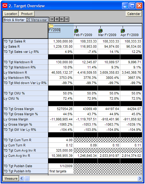

After you have seeded the departments and set the BOS, continue to the Target Overview Worksheet.
After you have seeded the groups, use the Target Overview worksheet to review the targets created by the top down user to understand the goal that your plan should meet.
Note: The top down targets are at the group level, but the worksheet shows the department level by default. To see the targets, change the level of the Product hierarchy from department to group. To see the TD Tgt Publish Date and Info measures, change the level to division and include year in the Calendar rollup. |
The Target Overview worksheet contains the top down target (TD Tgt) measures as well as last year (Ly) measures.
Use this worksheet to compare the TD Tgt measures to the corresponding Ly measures. By understanding how the top down targets compare to last year's metrics, you can better understand what your plan needs to achieve.
Note: All measures in the Target Overview worksheet are read-only. The measures that you edit are in other worksheets. |

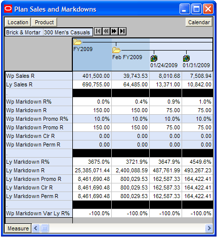

The Sales / Markdowns tab contains one worksheet, the Plan Sales and Markdowns worksheet.
After you have seeded the groups and reviewed the top down group targets, you can plan the sales and markdown targets for the departments within those groups using the Plan Sales and Markdowns worksheet.
The top down user plans top down targets at the month level. As the middle out user, you should use those targets to create more detailed targets at the week level. This allows you to create a weekly EOP plan that has more accurate average inventory and turn-over plans.
Use the following best practices to plan the sales and markdowns.

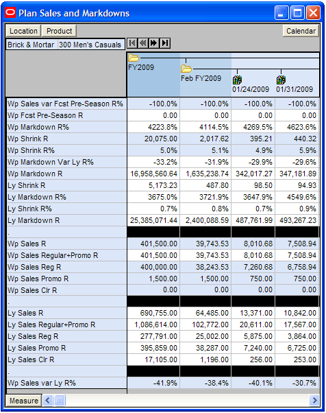

Using the default measure profile, review and compare the total sales to the forecast.
Change the measure profile to Sales by Type.
In the Sales by Type measure profile, plan your sales by type. The sales types are regular (Reg), promotional (Promo), clearance (Clr), and regular and promotional (Reg + Promo).
Note: Since Sales and Markdowns are both planned at the type level, the user must first complete the sales by type planning before they can plan the markdowns by type. |
Start by planning the regular sales. Then, using your marketing calendar as a guide, align the promotional sales to the calendar. Refer to the calendar again for the exit weeks for the products, and plan the clearance sales for those weeks.
The planned figures for these sales types populates the Wp Sales R measure.
With the total Wp Sales R populated, you can adjust the total to your target while still maintaining the relationships between the different sales types.
Plan the shrink with either the Wp Shrink R or Wp Shrink R% measure.
Change the measure profile to Markdown by Type.
In the Markdown by Type profile, edit the Wp Markdown Promo R% to adjust the Wp Markdown Promo Rate.

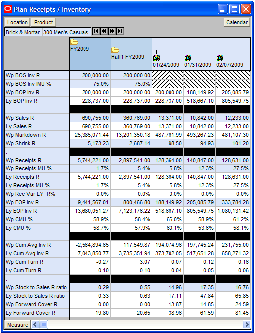

The Receipts / Inventory tab contains one worksheet, the Plan Receipts / Inventory worksheet.
After you have developed the sales and markdowns plan, develop a receipts and inventory plan that can support the sales that you are projecting in the sales and markdown plan.
Like the Plan Sales and Markdowns Worksheet, the Plan Receipts / Inventory worksheet contains several Ly metrics that you can reference when setting your targets. There are also additional measures you can use to adjust your inventory targets. Note that the adjustments you made to the Wp Sales R measure in the Plan Sales and Markdowns Worksheet are visible in this worksheet if you have calculated.
Use the following best practices to plan the receipts and inventory.
Ensure that you have set the beginning of season (BOS) inventory in the Initialize Plan worksheet in the Getting Started tab. The BOS measures must be set before planning the receipts and inventory. To set the BOS measures, see the Setting Beginning of Season Inventory.
Plan the receipt flow and then evaluate the average inventory and turn.
Review the Wp CMU % measure. Cumulative markup rate (CMU %) is a blend of the beginning of period (BOP) inventory retail and cost with the future receipt retail and receipt cost. The Wp CMU % directly affects the cost of goods sold (COGS), which then affects the gross margin.
Adjust the Wp Stock to Sales R measure accordingly. These adjustments affect the receipts for both the current month and prior month. However, the total plan period receipts do not increase or decrease; they only shift from month to month.
The following table lists the measures available on this worksheet.
Table 4-4 Plan Receipts / Inventory Worksheet Measures
| Measure | Description |
Wp BOS Inv R |
The planned beginning of season inventory. |
Wp BOS Inv IMU % |
The planned beginning of season initial markup. (The BOS Inv IMU% must be planned to get the BOS Cost). |
Wp BOP Inv R |
The planned beginning of period inventory. The period can be a week, month, or any other calendar period. |
Ly BOP Inv R |
Last year's beginning of period inventory. The period can be a week, month, or any other calendar period. |
Wp Sales R |
The planned sales retail value. |
Ly Sales R |
Last year's sales retail value. |
Wp Markdown R |
The planned markdown value. |
Wp Shrink R |
The planned shrink for the period. |
Wp Receipts R |
The planned receipt value. |
Wp Receipts MU % |
The planned receipts markup, expressed as a percentage of retail value. |
Ly Receipts R |
Last year's receipts. |
Ly Receipts MU % |
Last year's markup percent of receipts, expressed as a percentage of markup to net sales. |
Wp Rec Var LY R% |
The planned variance between the target receipts and last year's actual receipts, expressed as a percentage of last year. |
Wp EOP Inv R |
The planned end of period inventory. The period can be a week, month, or any other calendar period. |
Ly EOP Inv R |
Last year's end of period inventory. |
Wp CMU % |
The planned cumulative markup percent, cumulated from the start week of the workbook. |
Ly CMU % |
Last year's cumulative markup percent, cumulated for the same period last year, corresponding to the start week of this workbook until the current week. |
Wp Cum Avg Inv R |
The planned average cumulative inventory turns (retail). It is cumulated from the start week of the workbook. |
Ly Cum Avg Inv R |
Last year's cumulative average inventory value (retail), corresponding to the start week of the workbook until the current week. |
Wp Cum Turn R |
The planned cumulative inventory turns (retail). It is cumulated from the start week of the workbook. |
Ly Cum Turn R |
Last year's cumulative inventory turns (retail). |
Wp Stock to Sales R Ratio |
The planned ratio of the BOP inventory to the sales for the same period. |
Ly Stock to Sales R Ratio |
Last year's ratio of the BOP inventory to the sales for the same period. |
Wp Forward Cover R |
The planned number of weeks of forward cover for the period. Using the retail values sales of future weeks, this measure indicates how many weeks of sales can be fulfilled with the ending inventory of the period. |
Ly Forward Cover R |
Last year's forward cover for the period. |
After you have created an achievable receipts and inventory plan, continue to the Margin Tab to see if your sales and inventory plans achieve your gross margin goal.

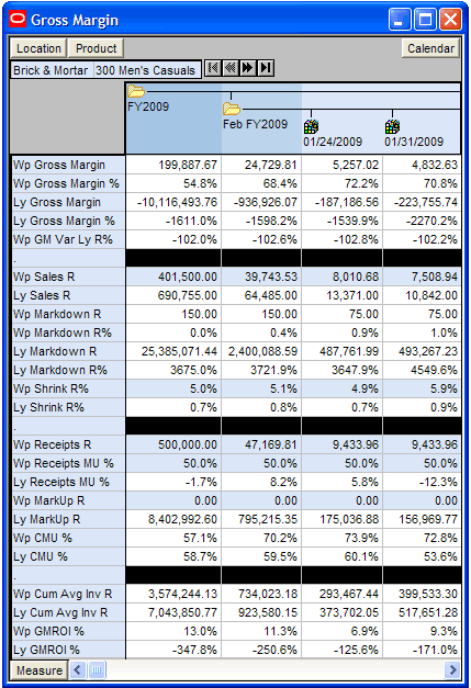

The Margin tab contains one worksheet, the Gross Margin worksheet.
Use this worksheet to evaluate the gross margin created from your sales and markdown plan and receipts and inventory plan. Determine whether the planned gross margin meets your gross margin goal. If it does not, return to the Plan Sales and Markdowns Worksheet and Plan Receipts / Inventory Worksheet to adjust your receipt markups and receipt flow. When you return to the Plan Sales and Markdowns worksheet, adjust the markdown plans, but do not change the sales. Continue this process until you are satisfied with the gross margin.
Table 4-5 Gross Margin Worksheet Measures
Wp Gross Margin |
The planned gross margin. |
Wp Gross Margin % |
The planned gross margin rate. |
Ly Gross Margin |
Last year's gross margin. |
Ly Gross Margin % |
Last year's gross margin rate. |
Wp GM Var Ly R% |
The planned variance between the gross margin and last year's actual gross margin, expressed as a percentage of last year. |
Wp Sales R |
Ly Sales R |
Wp Markdown R |
Wp Markdown R% |
The planned markdown rate. |
Ly Markdown R |
Last year's actual markdown value. |
Ly Markdown R% |
Last year's markdown rate. |
Wp Shrink R % |
The planned shrink rate for the period. |
Ly Shrink R% |
Last year's shrink rate. |
Wp Receipts R |
The planned receipts. |
Wp Receipts MU % |
The planned markup rate for receipts, expressed as a percentage of markup to net sales. |
Ly Receipts MU % |
Last year's markup percept for receipts, expressed as a percentage of markup to net sales. |
Wp MarkUp R |
The planned markup value for receipts, expressed as a difference of net sales and cost. |
Ly MarkUp R |
Last year's markup value for receipts, expressed as a difference of net sales and cost. |
Wp CMU % |
The planned cumulative markup percent. It is cumulated for the same period last year. It corresponds to the start week of the workbook until the current week. |
Ly CMU % |
The cumulative markup percent from last year. |
Wp Cum Avg Inv R |
Ly Cum Avg Inv R |
Last year's average cumulative inventory turns (retail). |
Wp GMROI % |
The planned gross margin return on inventory. |
Ly GMROI % |
Last year's gross margin return on inventory. |

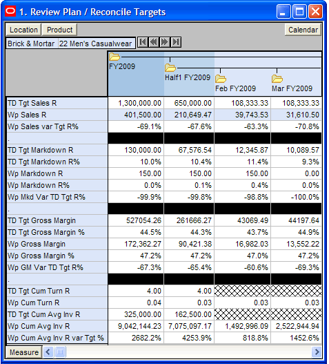

In this worksheet, review the targets created from previous steps. If you need to alter the targets shown in this worksheet, return to the worksheet where you created them and edit them there.
Use the default measure profile to the review the plan in total. Use the Reconcile to TD Targets measure profile to reconcile your plan to the top down targets. When using this profile, set the calendar hierarchy to month and product to group.

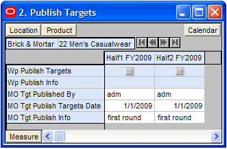

Use the Publish Targets worksheet when you are ready to publish the targets you created. Publishing targets copies the target information to the middle out target (MO Tgt) measures in your workbook, and then copies them to the database. After you have published the targets, the targets are passed down to the bottom up user.
Publishing and committing a target copies your middle out Wp measure information to the MO Tgt measures in your workbook.

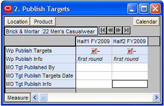

To publish the targets, perform the following steps.
Select the halves in the Wp Publish Targets measure that you want to publish.
If needed, enter relevant information in the Wp Publish Info measure. This is optional.
Repeat steps 1 and 2 for other locations and products if necessary.
Click Publish Targets in the Planning Actions menu, as shown in Figure 4-26.
A success message appears. Click OK to close it.
The worksheet is refreshed and the Wp Publish Targets and Wp Publish Info measures are cleared. The MO Tgt measures in this worksheet are populated. These measures are described in detail in the table below.
