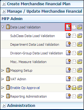

To build a Data Load Validation workbook, perform the following steps:
Click the New Workbook icon in the Data Load Validation step.

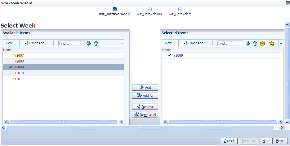

The workbook wizard opens at the Calendar Selection step. Select the weeks you want to validate and click Next.

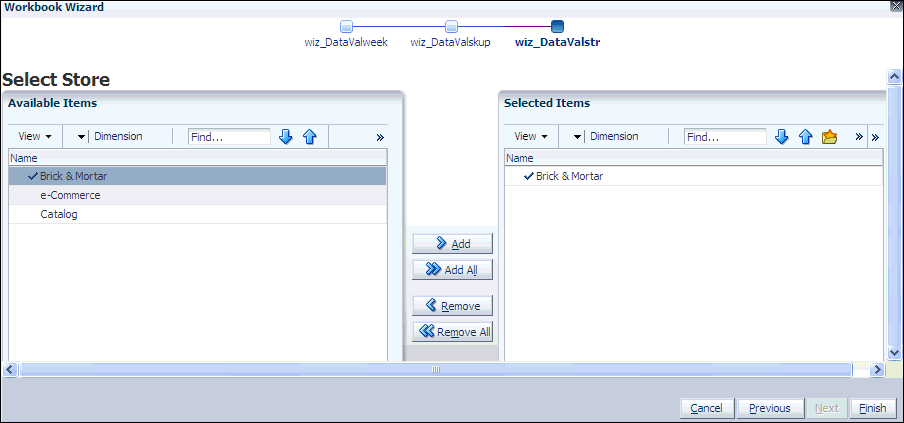

The Location Selection step is displayed. Select the stores and click Finish.
The Data Load Validation workbook is built.

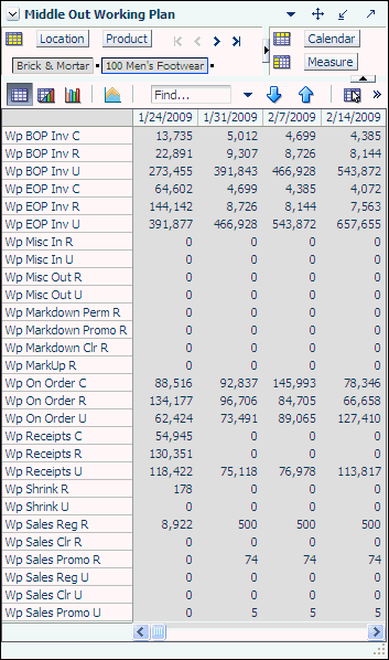

The Department Data Load Validation step includes one view, the Middle Out Working Plan view. Use this view to validate that the department data was updated in the batch process.
The following table lists the measures available on this view.
Table 9-2 Middle Out Working Plan View Measures

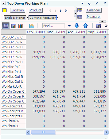

The Division-Group Data Load Validation step includes one view, the Top Down Working Plan view. Use this view to validate that the division-group data was updated in the batch process.
Table 9-3 Top Down Working Plan View Measures

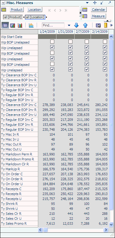

The Misc. Measures Validation step includes one view, the Misc. Measures view. Use this view to validate that the measures were loaded in the batch process.
Table 9-4 Misc Measures View Measures
