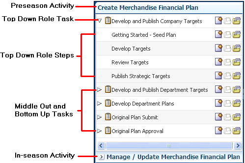

The top down role is usually associated with senior management in the merchandise planning organization. The overall goal of the top down user is to develop company-level strategic targets that set the financial guidance for the planning organization. To do this, the top down user creates strategic targets and provides them to the planning manager (middle out role), who provides department targets to the merchandise planner (bottom up role).
Top down users typically begin planning two to three years before the planning period. This is known as preseason planning. During this time, top down users create the Merchandise Financial Plan for the season or for the entire year.
When top down users open MFP in the RPAS Fusion Client, they are presented with the preseason activity called Create Merchandise Financial Plan. The first task within this activity is Develop and Publish Company Targets. This task belongs solely to the top down user. It has four steps:
These tasks and steps are shown in Figure 3-1.
Note: The top down user can see the tasks of the middle out and bottom up roles, but the top down user cannot open or create workbooks within those tasks. This is denoted by the grayed out icons on the right of the taskflow. |
The top down user must complete these four steps to publish the strategic targets to the middle out user. To do this, the top down user must first build the workbook.

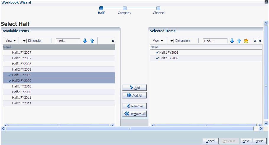

Click the Create New Workbook icon in the Develop and Publish Company Targets task.
The workbook wizard opens at the Calendar Selection step. Select the halves that you want to plan and move them to the Selected Items box. Click Next.

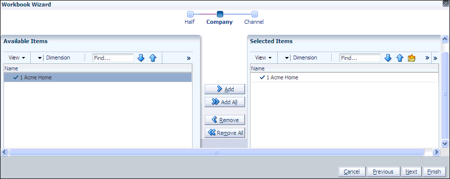

The Product Selection step of the workbook wizard is displayed. Select the company you want to plan and move it to the Selected Items box. Click Next.
The Location Selection step of the workbook wizard is displayed. Select the channels you want to plan and move them to the Selected Items box. Click Finish.
The Top Down Role workbook is built, and the Initialize view opens.

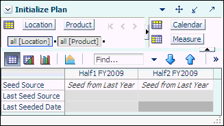

With this view, you can choose to seed your plan with Last Year (Ly) or Adjusted Last Year (Adj Ly) data to create a demand curve on which to spread the new plan's initial targets. Or, you can instead choose to not seed the plan, which allows you to create a plan that is not influenced by last year's performance.
In the preceding example, both Half1 and Half2 have been selected to be seeded for the Brick & Mortar channel for the 20 Menswear division.
When seeding the plan, you can choose which information is seeded. For instance, you can seed just one half or all halves in the task, as shown in Figure 3-6. You can also choose what locations and products to seed.

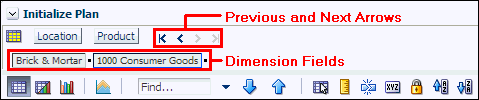

There are two ways you can seed. You can seed each level individually, or you can seed several levels at once by changing the dimension level shown in the view.

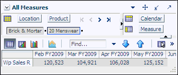

As shown in Figure 3-6, only the Brick & Mortar channel and the 20 Menswear division have been selected to be seeded with Ly data. This means that the other product divisions have not been selected to be seeded yet. To seed the next division in the Product dimension within the Brick & Mortar channel, perform the following steps:
Click within the dimension field that you want to change, as shown in Figure 3-7.
Click the Next or Previous arrow, as shown in Figure 3-7.
The page refreshes and the next division in the Product dimension is displayed in the page edge. Note that the Seed Source measure is no longer populated.
Select the half that you want to seed with Ly or Adj Ly data.
Click the Next arrow to view and seed the next division.

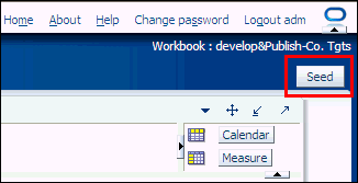

When you have selected all the data you want to seed, click Seed in the top, right corner.
A confirmation message is displayed, stating that the data has been successfully seeded. Click OK.

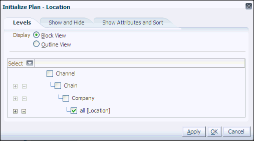

To change the dimension level shown in the page edge or grid, perform the following steps:
Click the dimension tile of the dimension level you would like to change.
The dimension window is displayed. Select the level of the dimension that you want to appear in the page edge. If you want to view more than one level at a time in the page edge or grid, select multiple levels. In Figure 3-11, Channel was deselected and all [Location] was selected instead.
Click OK when finished.
Repeat steps 1 through 3 for other dimensions if desired.

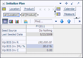

After you have seeded, set the Beginning of Season (BOS) inventory. By entering the BOS inventory that you project for the season, you can set the BOS markup for that inventory, which allows the BOS cost to be calculated.

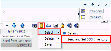

To set the BOS, perform the following steps:
In the Initialize Plan view, click the Measure Profile icon.
In the Measure Profile menu, click Select and then click the Seed and Set BOS Inventory measure profile.
The view is refreshed with the Seed and Set BOS Inventory measures visible.
Change the calendar hierarchy rollup to year.
Enter data in the BOS Inv R and BOS Inv IMU% measures.
Click Calculate.
The Wp BOS Inv C measure recalculates based on the data in the WP BOS Inv R and Wp BOS Inv IMU % measures.

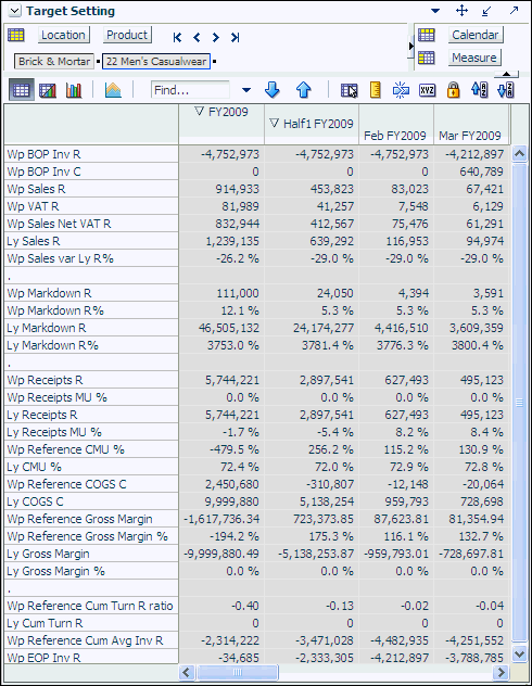

After you have seeded the divisions, develop the sales and markdown targets for groups within those divisions. The Develop Targets step has one view: Target Setting.
The following table lists the measures available on this view.

To create the top down targets, perform the following steps:
Change the Calendar hierarchy so that year is displayed.
Enter the WP Sales R that you are projecting. Use the Wp Fcst Pre-Season R measure as a guide.
Plan the markdown by editing either the Markdown R or Markdown R% measure.
Enter the CMU targets at the month level. These are usually relative to the receipt markup they have for the same plan period.
Note: The Wp CMU% measure is only editable in the Top Down Target Settings task. For the middle out and bottom up users, it is read-only. |
Plan the gross margin by editing the Wp Gross Margin measure. Enter the target at the year level. This calculates the Wp Gross Margin % measures based off the Sales net Vat R measure.
Note: Wp Gross Margin is only editable in the Top Down Target Settings task. For the middle out and bottom up users, it is read-only. |
After you have entered sales and markdowns, the COGS measure is populated. To apply the CMU% to the COGS, enter CMU at the month level or higher. Click Calculate.
Optional: Adjust the gross margin by month.
Enter the Wp Cum Turn R at the half level.
Note: The turn at the year is calculated by using the average inventory from the second half as the year average inventory. The turn for the year is calculated from the average inventory at the year level. |
Click Calculate to populate the Wp Cum Avg Inv R measure.

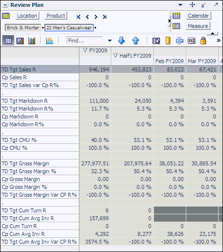

At the Review Targets step, review the targets you created in the Develop Targets step.
This step contains two views: Review Plan and All Measures. The Review Plan view displays the targets you have created. All Measures contains all the measures contained in the task. For more details on the All Measures view, see All Measures.
In this view, review the targets you created in the previous step. If you need to alter the targets shown in this view, return to the Develop Targets step to edit them there.
Note: If you have not published top down targets yet, the TD Tgt measures have no values. |
If you are satisfied with the plan you have created, proceed to the final top down role step: Publish Strategic Targets.
Use the Publish Strategic Targets step when you are ready to publish the targets you created. Publishing a target copies the target information to the TD Tgt (Top Down Target) measures in your task, and then it commits them to the database. After you have published, the targets are passed down to the middle out user.
Publishing a target copies your top down Wp measure information to the TD Tgt (Top Down Target) measures in your task, and then it commits those target measures to the database so that middle out users can retrieve those targets.
The TD Tgt measures are shown in the Review Plan view found in the Review Targets step. These measures initially have zero values. After the targets are published in this step, those measures are populated with the target information.
