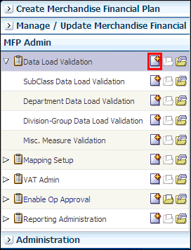

To build a Data Load Validation workbook, perform the following steps:
  1. Click the New Workbook icon in the Data Load Validation step.
    Figure 9-1 Data Load Validation

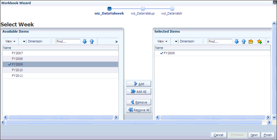

  2. The workbook wizard opens at the Calendar Selection step. Select the weeks you want to validate and click Next.
    Figure 9-2 Data Load Validation Workbook Wizard - Calendar Selection

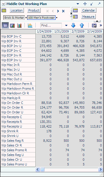

Department Data Load Validation
The Department Data Load Validation step includes one view, the Middle Out Working Plan view. Use this view to validate that the department data was updated in the batch process.
Figure 9-6 Middle Out Working Plan View
The following table lists the measures available on this view.
Table 9-2 Middle Out Working Plan View Measures
