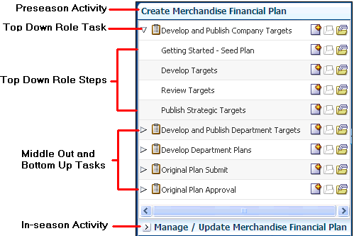

3 Preseason: Top Down Role Task
The top down role is usually associated with senior management in the merchandise planning organization. The overall goal of the top down user is to develop company-level strategic targets that set the financial guidance for the planning organization. To do this, the top down user creates strategic targets and provides them to the planning manager (middle out role), who provides department targets to the merchandise planner (bottom up role).
Top down users typically begin planning two to three years before the planning period. This is known as preseason planning. During this time, top down users create the Merchandise Financial Plan for the season or for the entire year.
When top down users open MFP in the RPAS Fusion Client, they are presented with the preseason activity called Create Merchandise Financial Plan. The first task within this activity is Develop and Publish Company Targets. This task belongs solely to the top down user. It has four steps:
These tasks and steps are shown in Figure 3-1.
Figure 3-1 Top Down Role View: Preseason Task and Steps
The top down user can see the tasks of the middle out and bottom up roles, but the top down user cannot open or create workbooks within those tasks. This is denoted by the grayed out icons on the right of the taskflow.
The top down user must complete these four steps to publish the strategic targets to the middle out user. To do this, the top down user must first build the workbook.

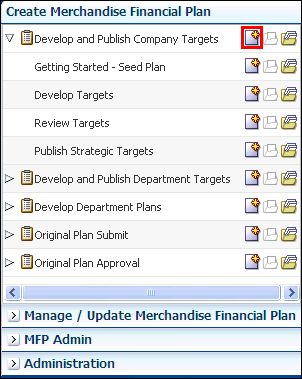

To build the top down role workbook, perform the following steps.
  1. Click the Create New Workbook icon in the Develop and Publish Company Targets task.

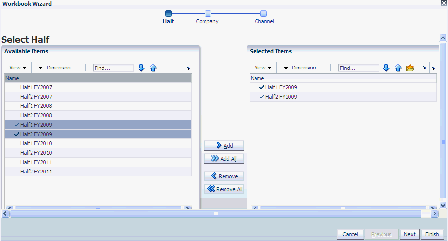

  2. The workbook wizard opens at the Calendar Selection step. Select the halves that you want to plan and move them to the Selected Items box. Click Next.
    Figure 3-3 Workbook Wizard: Calendar Selection

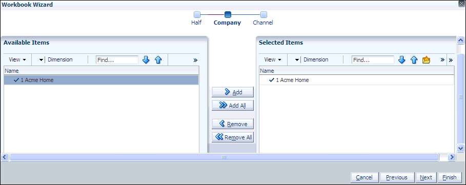

  3. The Product Selection step of the workbook wizard is displayed. Select the company you want to plan and move it to the Selected Items box. Click Next.
    Figure 3-4 Workbook Wizard: Product Selection

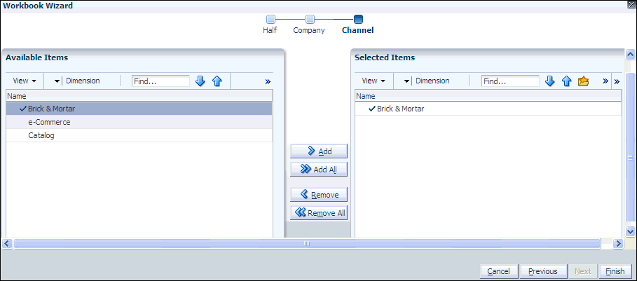

  4. The Location Selection step of the workbook wizard is displayed. Select the channels you want to plan and move them to the Selected Items box. Click Finish.
    Figure 3-5 Workbook Wizard: Location Selection
The Top Down Role workbook is built, and the Initialize view opens.

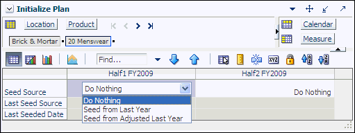

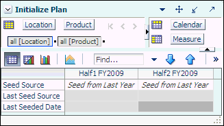

With this view, you can choose to seed your plan with Last Year (Ly) or Adjusted Last Year (Adj Ly) data to create a demand curve on which to spread the new plan's initial targets. Or, you can instead choose to not seed the plan, which allows you to create a plan that is not influenced by last year's performance.
In the preceding example, both Half1 and Half2 have been selected to be seeded for the Brick & Mortar channel for the 20 Menswear division.

Seeding One Level at a Time

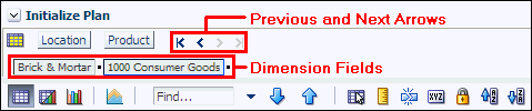

As shown in Figure 3-6, only the Brick & Mortar channel and the 20 Menswear division have been selected to be seeded with Ly data. This means that the other product divisions have not been selected to be seeded yet. To seed the next division in the Product dimension within the Brick & Mortar channel, perform the following steps:
  1. Click within the dimension field that you want to change, as shown in Figure 3-7.
  2. Click the Next or Previous arrow, as shown in Figure 3-7.
    Figure 3-7 Changing a Dimension Level with Page Arrows
  3. The page refreshes and the next division in the Product dimension is displayed in the page edge. Note that the Seed Source measure is no longer populated.
  4. Select the half that you want to seed with Ly or Adj Ly data.
  5. Click the Next arrow to view and seed the next division.

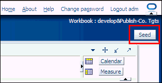

  6. When you have selected all the data you want to seed, click Seed in the top, right corner.
    Figure 3-8 Seed Button

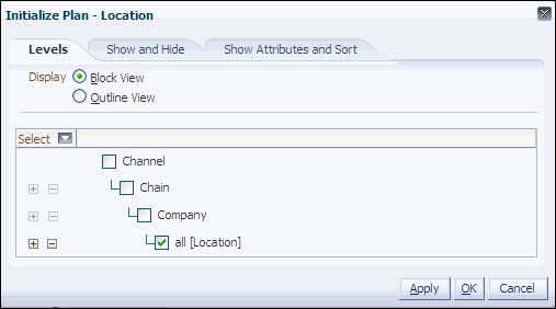

To change the dimension level shown in the page edge or grid, perform the following steps:
  1. Click the dimension tile of the dimension level you would like to change.
    Figure 3-10 Location Dimension Tile
  2. The dimension window is displayed. Select the level of the dimension that you want to appear in the page edge. If you want to view more than one level at a time in the page edge or grid, select multiple levels. In Figure 3-11, Channel was deselected and all [Location] was selected instead.
    Figure 3-11 Location Dimension Window
  3. Click OK when finished.
  4. Repeat steps 1 through 3 for other dimensions if desired.

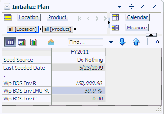

Setting Beginning of Season Inventory

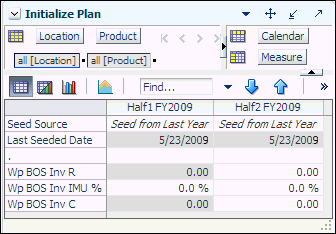

After you have seeded, set the Beginning of Season (BOS) inventory. By entering the BOS inventory that you project for the season, you can set the BOS markup for that inventory, which allows the BOS cost to be calculated.
To set the BOS, perform the following steps:

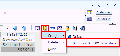

  1. In the Initialize Plan view, click the Measure Profile icon.
  2. In the Measure Profile menu, click Select and then click the Seed and Set BOS Inventory measure profile.
    Figure 3-14 Seed and Set BOS Inventory Measure Profile
  3. The view is refreshed with the Seed and Set BOS Inventory measures visible.
    Figure 3-15 Initialize Plan View with Seed and Set BOS Inventory Measure Profile
  4. Change the calendar hierarchy rollup to year.
  5. Enter data in the BOS Inv R and BOS Inv IMU% measures.
    Figure 3-16 Initialize Plan View with Seeded and Set BOS Inventory
  6. Click Calculate.
The Wp BOS Inv C measure recalculates based on the data in the WP BOS Inv R and Wp BOS Inv IMU % measures.

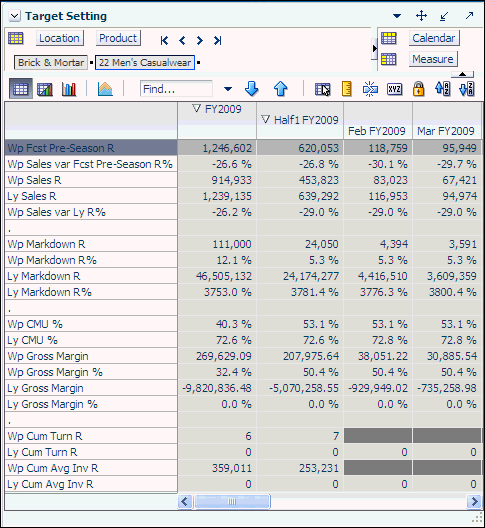

Develop Targets
After you have seeded the divisions, develop the sales and markdown targets for groups within those divisions. The Develop Targets step has one view: Target Setting.

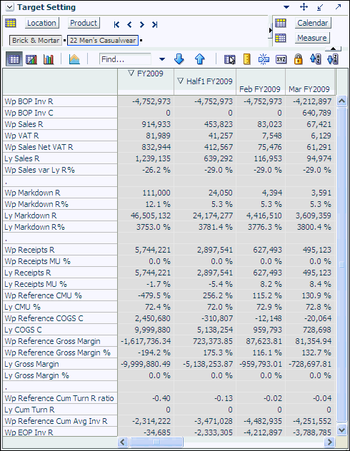

Figure 3-17 Target Setting View
The following table lists the measures available on this view.

To create the top down targets, perform the following steps:

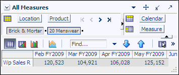

  1. Change the Calendar hierarchy so that year is displayed.
  2. Enter the WP Sales R that you are projecting. Use the Wp Fcst Pre-Season R measure as a guide.
  3. Plan the markdown by editing either the Markdown R or Markdown R% measure.
  4. Enter the CMU targets at the month level. These are usually relative to the receipt markup they have for the same plan period.
    The Wp CMU% measure is only editable in the Top Down Target Settings task. For the middle out and bottom up users, it is read-only.
  5. Plan the gross margin by editing the Wp Gross Margin measure. Enter the target at the year level. This calculates the Wp Gross Margin % measures based off the Sales net Vat R measure.
    Wp Gross Margin is only editable in the Top Down Target Settings task. For the middle out and bottom up users, it is read-only.
  6. After you have entered sales and markdowns, the COGS measure is populated. To apply the CMU% to the COGS, enter CMU at the month level or higher. Click Calculate.
  7. Optional: Adjust the gross margin by month.
  8. Enter the Wp Cum Turn R at the half level.
    The turn at the year is calculated by using the average inventory from the second half as the year average inventory. The turn for the year is calculated from the average inventory at the year level.
  9. Click Calculate to populate the Wp Cum Avg Inv R measure.
  10. Optional: Use the measure profile Reference Measures to assist you to create a more detailed top down target.
    The reference measures may not match the working plan (Wp) measures. Reference measures are read-only. Only Wp measures are editable. The Wp measures are the measures that can be published as top down targets. Wp Reference measures cannot be published.

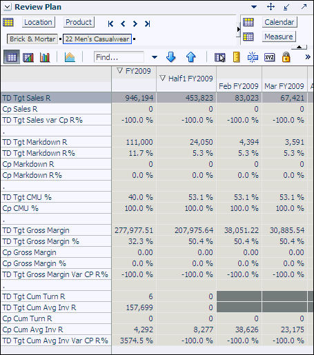

This step contains two views: Review Plan and All Measures. The Review Plan view displays the targets you have created. All Measures contains all the measures contained in the task. For more details on the All Measures view, see All Measures.
Review Plan
In this view, review the targets you created in the previous step. If you need to alter the targets shown in this view, return to the Develop Targets step to edit them there.
If you have not published top down targets yet, the TD Tgt measures have no values.
Figure 3-19 Review Plan View
If you are satisfied with the plan you have created, proceed to the final top down role step: Publish Strategic Targets.

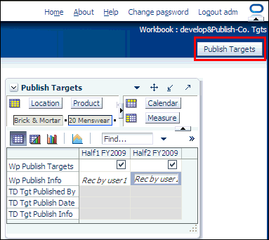

To publish the targets, perform the following steps.
  1. Select the halves in the Wp Publish Targets measure that you want to publish.
  2. If needed, enter relevant information in the Wp Publish Info measure. This is optional.
  3. Repeat steps 1 and 2 for other locations and products if necessary.
  4. Click Publish Targets. This button is located in the top, right corner, as highlighted in Figure 3-20.
  5. A success message is displayed. Click OK to close it.
    Figure 3-21 Success Message - Publish Targets
The view refreshes and clears the Wp Publish Targets and Wp Publish Info measures. The TD Tgt measures in this view are populated. These measures are described in detail in the following table.
Figure 3-22 Successfully Published Targets

Wp Publish Info
Working Plan Publish Information. Use this measure to enter relevant target information. This measure is optional.
TD Tgt Published By
Top Down Target Published By. After a target is published, this measure displays the username of the person who published the targets.
TD Tgt Publish Date
Top Down Target Publish Date. After a target is published, this measure displays the date that the target was published.
TD Tgt Publish Info
Top Down Target Publish Info. After a target is published, this measure displays the information that was entered in the Wp Publish Info measure.

All Measures
The All Measures view contains all the measures contained in the task; however, only the Wp Sales R measure is visible in the default measure profile. The purpose of this task is to allow you to create a view of task measures that you may not be able to view all at once in other views.
Figure 3-24 Review Targets - All Measures
To see the other measures in this view, perform the following steps:
  1. Click the Measure dimension tile. The All Measures - Measure window is displayed.
  2. Move the measures you want to see in the view from the Hidden Measures box to the Visible Measures box.
  3. When finished, click OK.
For more information about hidden and visible measures, see the Oracle Retail Predictive Application Server User Guide for the Fusion Client.
