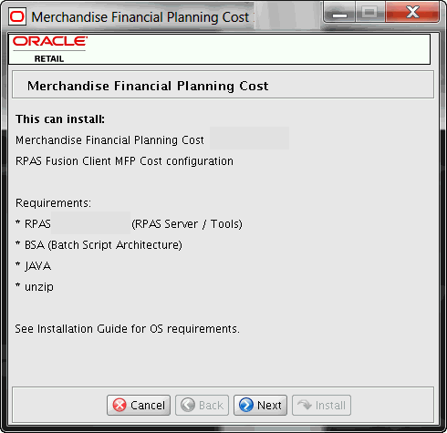

  3. The Merchandise Financial Planning Cost Installer Window opens and displays the components that are installed during installation process and the required components.
    Click Next to continue.
    Oracle Retail Batch Scripting Architecture (BSA) must be installed prior to installing MFP Cost. For information about installing BSA, see the Oracle Retail Batch Script Architecture Implementation Guide.

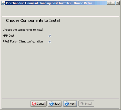

  4. The Choose Components to Install Window opens.
    Figure 2-2 Choose Components to Install Window
    Surrounding text describes Figure 2-2 .
    Select one or both of the following options:
    • MFP Cost Server install with domain — Select this option to install the MFP Cost server with the domain.
    • RPAS Fusion Client configuration — Select this option to install the RPAS Fusion Client configuration for MFP Cost. For more information on the configuration files included for the RPAS Fusion Client, see Configuration Files for the RPAS Fusion Client.
      If you do not want to install the RPAS Fusion Client configuration, clear this check box and skip steps 7 and 8.

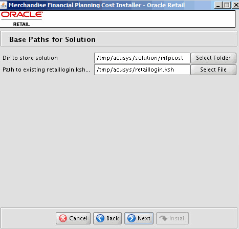

  5. The Base Paths for Solution Window opens.
    Figure 2-3 Base Paths for Solution Window
    Surrounding text describes Figure 2-3 .
    Enter the relevant information in the following fields:
    • Dir to store solution — Enter the directory path where your solution should be stored.
    • Path to existing retaillogin.ksh script — Enter the path and file name to the retaillogin.ksh script created during RPAS installation.
    Ensure that the installation paths are located outside the installer directory [MFP Installation].

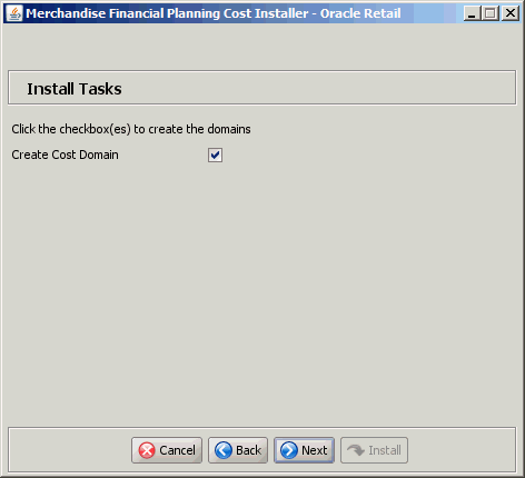

  6. The Install Tasks Window opens.
    Figure 2-4 Install Tasks Window
    Surrounding text describes Figure 2-4 .
    Select or clear the Create Cost Domain option:
    • To create the MFP Cost domain, select the Create Cost Domain option, which is selected by default.
      Domain builds use the environment specified in the retaillogin.ksh environment setup script. If you change any environment details, edit the retaillogin.ksh script and any subsequent scripts called by retaillogin.ksh.
      For more information about the retaillogin.ksh script, see the Environment Variable Setup section.
    • To install all required components to support the MFP Cost domain, but not create the actual domain, clear the check box.

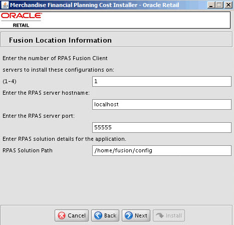

  7. The Fusion Location Information Window opens.
    Figure 2-5 Fusion Location Information Window
    Surrounding text describes Figure 2-5 .
    Field Description
    Enter the number of RPAS Fusion Client servers to install these configurations on: (1-4) Enter the number of servers running the RPAS Fusion Client where you want to install the MFP Cost configuration. In case the RPAS Fusion Client is running on a single server, enter 1. If you have a clustered installation, you can enter up to four servers
    Enter the RPAS server hostname: Enter the hostname of the RPAS server.
    Enter the RPAS server port: Enter the port number of the RPAS server.
    RPAS Solution Path Enter the location of the RPAS domain for MFP Cost.
    The Fusion Location Information windows open when you select the RPAS Fusion Client configuration check box on the Choose Components to Install Window window.

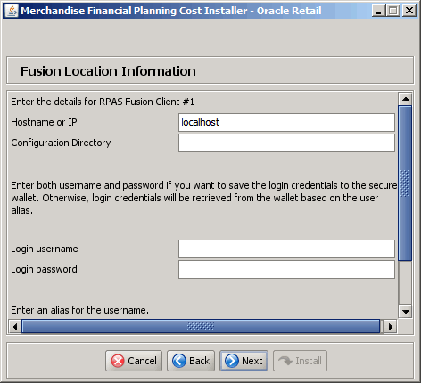

  8. Based on the number of servers you entered, the Fusion Location Information (Details) Window opens.
    Figure 2-6 Fusion Location Information (Details) Window
    Surrounding text describes Figure 2-6 .
    Enter the server details in the following set of fields for each configuration:
    Field Description
    Hostname or IP Enter the host name or IP address of the server where the RPAS Fusion Client is installed.
    Configuration Directory Enter the location of the config directory available at the location where the RPAS Fusion Client is installed.
    Login username Enter the user name to log on to the server where the RPAS Fusion Client is installed.
    Login password Enter the password associated with the user name.
    Login username alias Specify an alias name for the administrative user. Specifying an alias name for the administrative user enhances the security for the application. When left blank, the alias name defaults to the administrative user name.

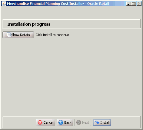

  9. The Installation Progress Window opens. To start the installation, click Install.
    Figure 2-7 Installation Progress Window
    Surrounding text describes Figure 2-7 .
    This window also displays the progress of the installation routine. Click Show Details to view the log output as the installation is performed. If you do not select to view the details, a graphical representation of the installation steps appears. As each step is completed, the color changes to show you the progress.
    You can toggle between detailed mode at any time during or after the installation.
  10. When the installation has finished, the Finished message opens. Click OK.
