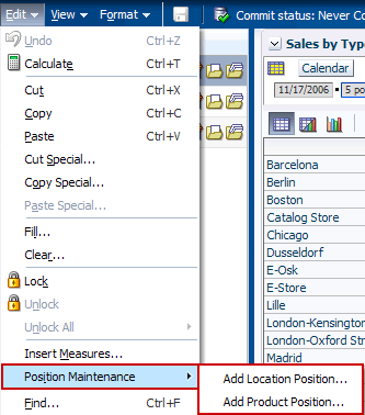

To add new positions to a dimension, complete the following steps:
From the Edit menu, select Position Maintenance and then the dimension to which you want to add a dynamic position.
Or, right-click the position level to which you want to add a new position. The right-click context menu appears. Select Position Maintenance and then select Add Position.
The Add Dynamic Position window appears. The dimension levels outlined in a thick blue line are informal positions. Click the Edit Position link in the dimension level to which you want to add a position.

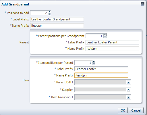

If you selected a dimension level other than the lowest dimension level, the Add Position dialog box looks like Figure 9-5.
Enter information in the following fields:
Positions to add: Enter the number of positions that you want to add at this level. All of the positions will have the same attributes.
Label Prefix: Enter the name that you want to appear in the pivot table. If you are adding more than one position, this label is suffixed with a number.
For instance, if you enter 3 in the Positions to add field and Leather Loafer Grandparent in the Label field, three labels appear in the pivot table:
Leather Loafer Grandparent0000001
Leather Loafer Grandparent0000002
Leather Loafer Grandparent0000003
Name Prefix: Enter the name of the position or use the system-generated one provided. When multiple positions are created, the name is concatenated with a sequence number. This name is used in the RPAS server.
In addition to the fields for the selected level, there are additional fields for the levels below the level being added. In Figure 9-5, the selected level is Grandparent and the lower levels are Parent and Item. If needed, enter information for those fields as well.
Click OK.

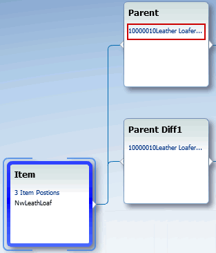

Modify the parent levels of the new positions. You can select an existing parent level or create a new (dynamic) one. To do either, click the link in a level above the new position.
Perform one of the two options:
To select an existing position as the parent of the dynamic position, select one from the drop-down list or search for one using the search link. For more information about the search feature, see Using the DPM Search Feature.
To create a new (dynamic position) parent level, type the name of the new parent in the Label field and select the Create New Position option.
The Name field is enabled. Enter the name of the new parent. When finished, click OK.
Repeat step 6 for other parent levels.

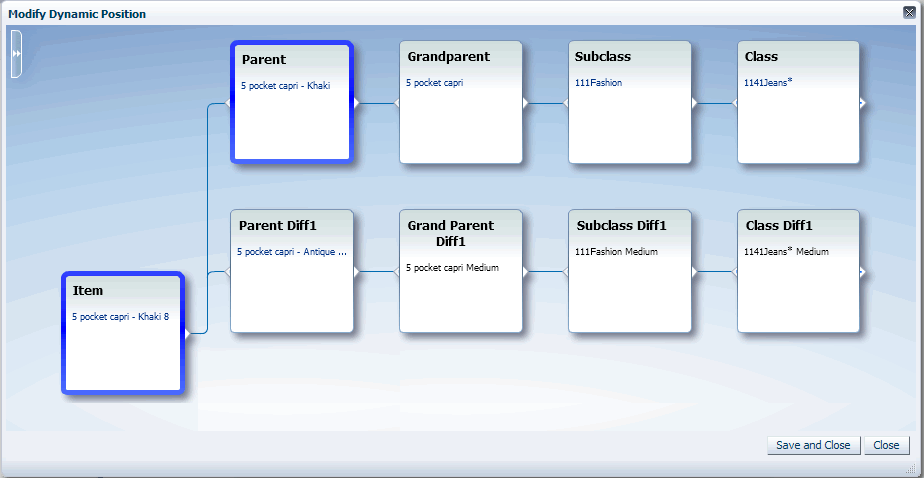

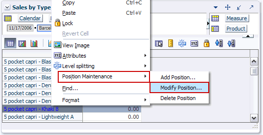

Right-click the dynamic position you want to modify.
From the right-click menu, select Position Maintenance, then Modify Position.
The Modify Dynamic Position window appears. Select the existing dynamic position and modify the position label or position name. Or, select any parent of the dynamic position to change the parent assignment.
When finished, click Save and Close.

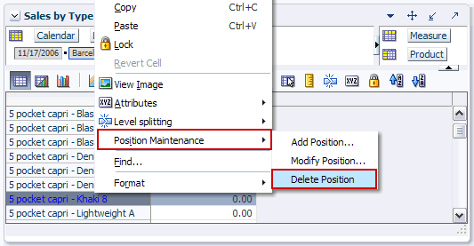

Right-click the dynamic position you want to delete.
From the right-click menu, select Position Maintenance and then Delete Position.
The Delete Dynamic Position dialog box appears to indicate the dynamic position that will be deleted and any child positions associated with it that will be deleted as well. Click OK.
The dialog box closes, and the dynamic position is removed from the view.

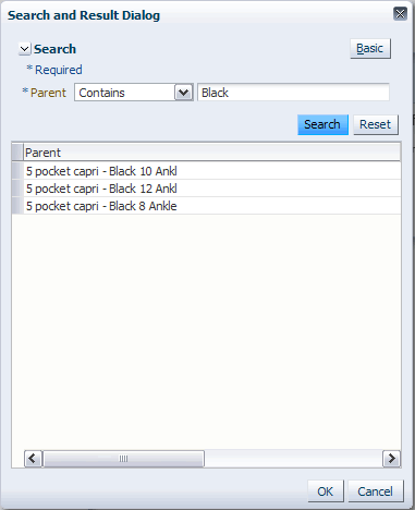

When selecting the parent level that a new dynamic position belongs to, you can use the search feature to find the desired level.
Click a level above the dynamic position you are creating, as shown in Figure 9-15.
The Add/Select [Level] dialog box appears. Click the Label field to access the Search link.
Click the Search link.
The Search and Result dialog box appears (Figure 9-17). Use the search features to search for a position. You can search with the following options:
Starts With
Does Not Contain
Not Equals
Equals
Contains
Ends With
Enter a value in the search field and click Search.
The dialog box refreshes with the positions that match the search. Select the position you want and click OK.
The Search and Result dialog box closes, and the selected position is filled in the Add/Select [Level] dialog box.
