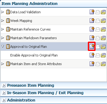

To build a new Approval to Original Plan workbook, perform the following steps:
Click the New Workbook icon in the Approval to Original Plan task.

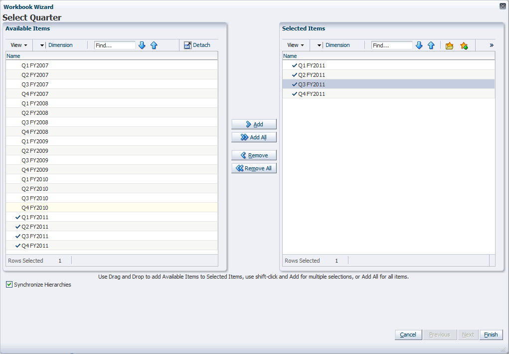

The workbook wizard opens at the Calendar Selection step. Select the quarter you want to enable and click Finish.

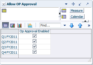

The Approval to Original Plan workbook is built and opens at the Allow Op Approval step.
