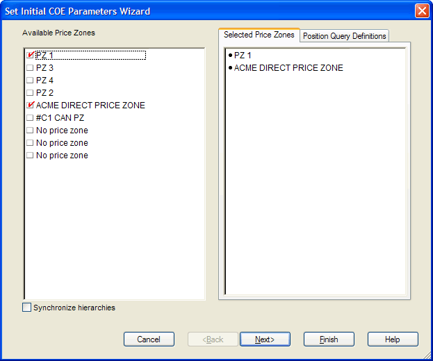

The workbook wizard opens at the Price Zone step. Select the price zones that you want to plan. Click Next.
